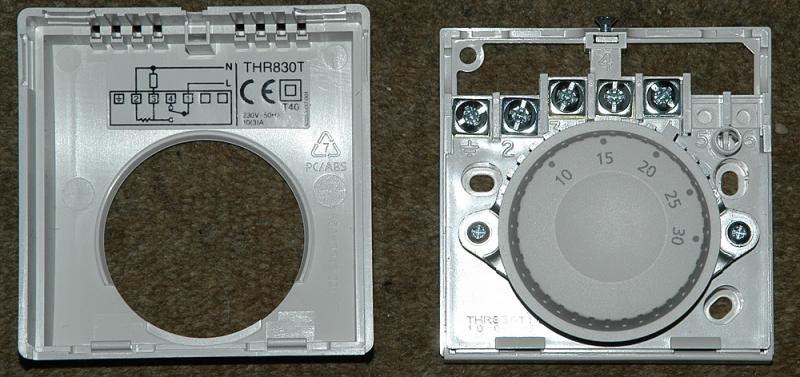

Hi, first of of all I hope all had a good Christmas, we did until boxing day when the CH pump siezed, no problem I thought, whip down to B&Q/Wickes and pick up a new one, which I duly did, while I was there I decided to replace the 25 year old Satchwell room thermostat with a new more accurate design, easy peasy thought I :rolleyes:

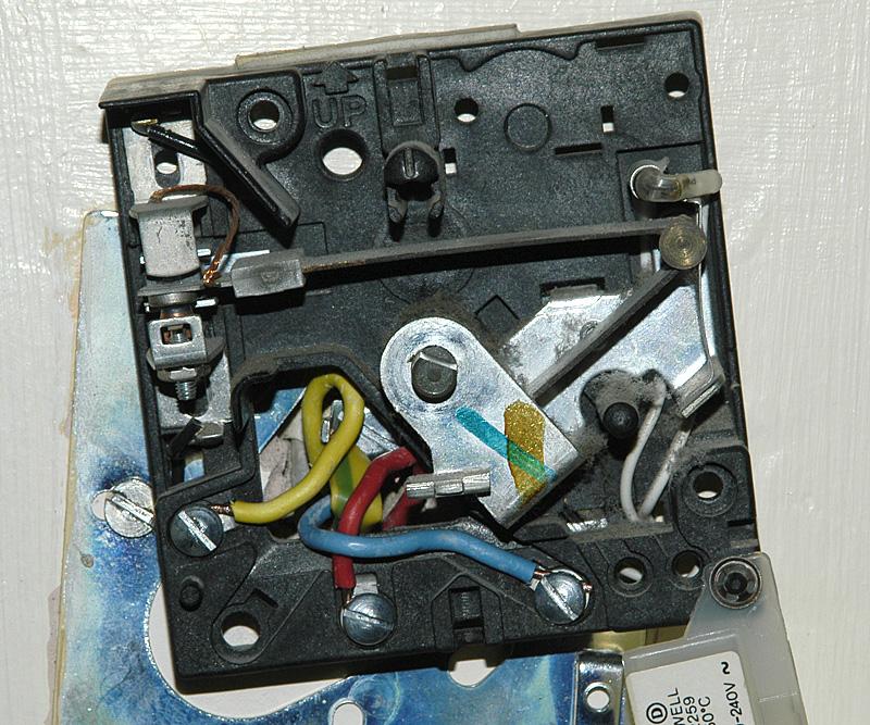

Replaced the pump no problem at all, my son was busy replacing the thermostat at the same time.....unfortunately after turning everything on and bleeding the system I had hot water but no heating, it appears the thermostat is not doing its job, so we put the old stat back on as a temporary fix....but now the old stat no longer works the system, we are sure we wired it OK, after all it seemed straight forward, but I am at a loss, cannot get the CH to work at all unless I turn up the hot water and open the diverter valves.
Could somebody please look at the piccies and tell me where I have gone wrong? The wiring colours on the cable to the stat bare no resemblance to anything I can find in the manual for the boiler (Halstead Best 80) and the programmer (Horstmann C27).

Well after all the fuss yesterday and this morning we decided to give it one last go, we wired it up EXACTLY the same way as we thought originally which was
EARTH > EARTH
Yellow > No3
Blue > No2
Red (live) > No1
And now we got CH again....but hang on....we did all this yesterday, and left it for at least 5 minutes each time we fiddled, but the pump never turned for the CH only when HW was on....but this afternoon.....it all works again :confused:
If anyone can see a flaw in my wiring please let me know.....although I will be reluctant to change anything again :D
Best regards David
Wired correctly, there is a microswitch in new roomstat perhaps it was sticking if its all working ok now
