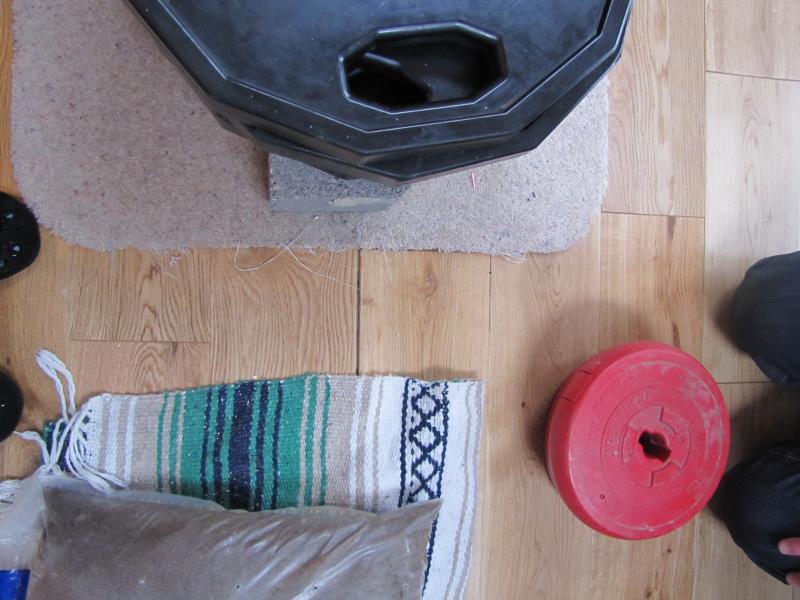

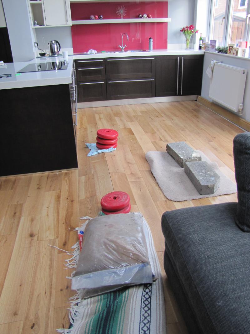

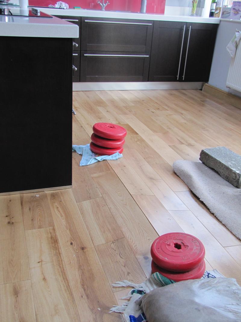

Hi, looking for a bit of advice or comment on what we're doing to try and solve this problem.
We built a full width extension,open plan so we have part of oringinal house in the extension as well.
We or rather, i decided to go for solid wood flooring. Purchased from Magnet. Fitted with glue. Looked beautiful. The wood turned up a little bit at the edges but then settled down.

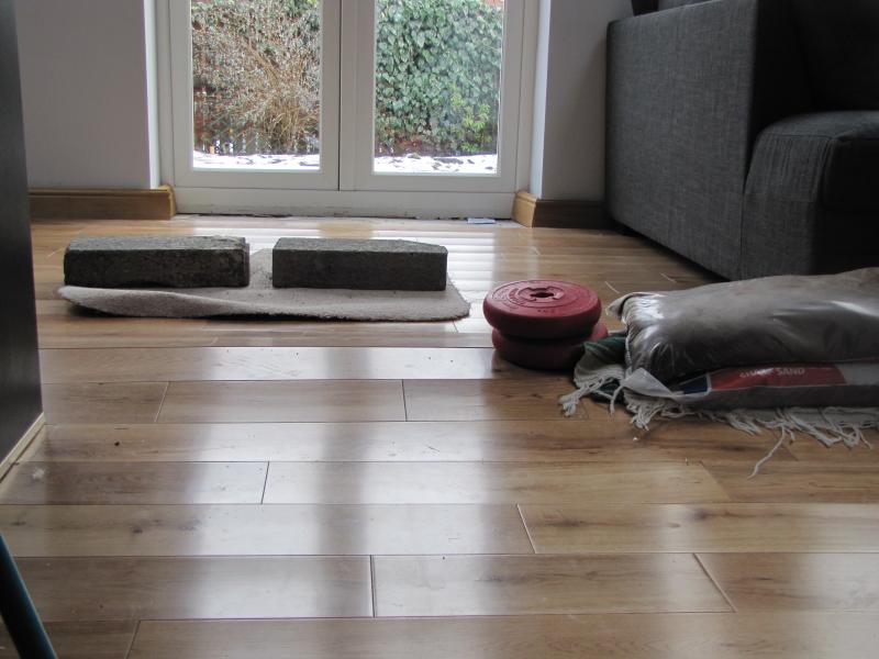

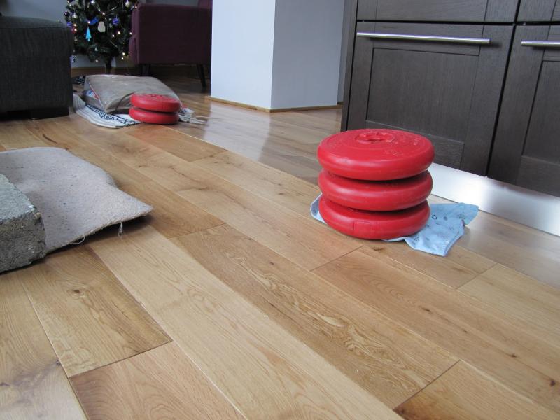

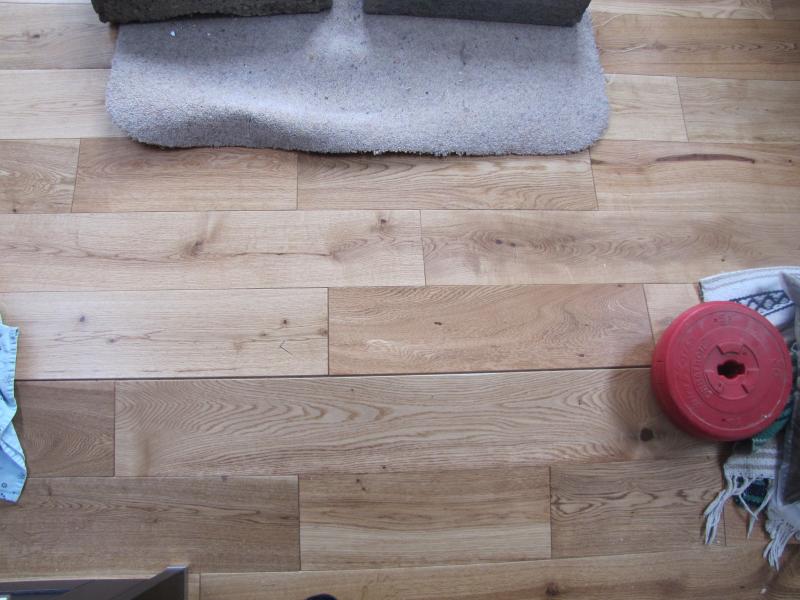

Then we developed a hump in the wood just before Christmas which very quickly spread and looked ready to crack or pop. We placed weights on the hump and managed to get our builder to come and have a look yesterday.

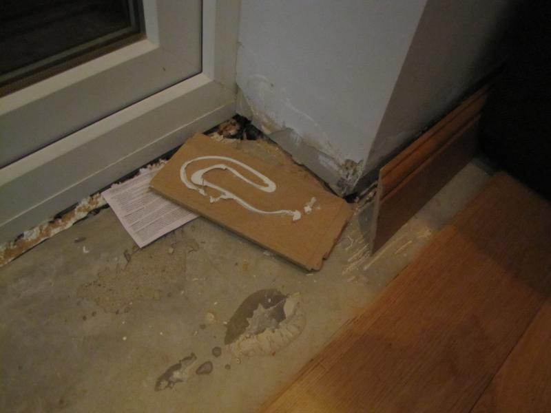

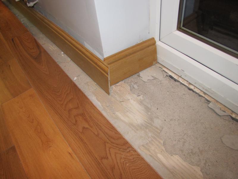

He'd left more than the allocated 3mm per metre and when he'd taken the skirting boards off the wood in places had actually broken the plasterboard. It had certainly expanded quite a bit even without taking into consideration the hump.
Anyway builder has taken a line of wood flooring up from the main wall. It's been a day now since this was done and the flooring still looks like it might pop. We've kept the weights on but are wondering if more weight should be applied.
How long do you think it should take for the hump to level out and have we done the right thing? Is there another remedy?
PS the wood that was taken up had cement stuck to it - ie the glue didn't budge but the cement did
I've tried to show the hump in the pictures - not sure if it shows up that well.
any comments greatly appreciated :)

Worried that it may effect the kitchen cupboards/worktop as it's lifting right at the base of the island cupboards. Kitchen was fitted on top of flooring
It looks like the most likely issue is excessive damp in the extension subfloor still.
General rule is 4 weeks for every 1" of subfloor depth for drying. De-humidifiers won't really help.
Best thing to do is get an area of the floor up and use a hydrometer to test an accurate moisture content of the subfloor and compare your readings to the floor recommendations. A hand held 'prong' style damp meter will not be accurate.
Ideally solid wood floors should be glued to the sub floor not floated.
Sounds like it was fully bonded to the floor. Which, looking at the many joints of the floor, is indeed the only option with these types of solid wood flooring.
Before the installation of the solid wood floor started, had anyone checked the moist in the concrete - or was it "only" a screed layer. If so, that's often a very weak link, especially if latex screed has been used.

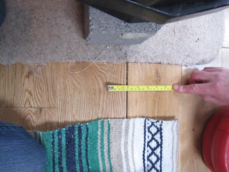

Is there a big enough expansion gap around the walls?
please see images of expansion now. This is only one side of the room as the other side is the original flooring and we don't have a problem with that
Agree, looks adequate :)

fingers crossed it will all move towards the expansion area. anyone had experience of how long this will take. Hump grew in a matter of days!!
No Christmas/New Year party hosting for us - we'd have to take out persONAL injury insurance. Can just see the headlines - New year celebration man with broken toes from standing too close to 5 lots of 20kg weights!!!!

Hi folks, woke up this morning and gap seems to have widened.
Should i still keep the weights on or remove them to give wood chance to move naturally?
Looking at the gap it looks like the wood will pop!
Would it be better to remove planks from middle of hump? what happens if it does pop?
