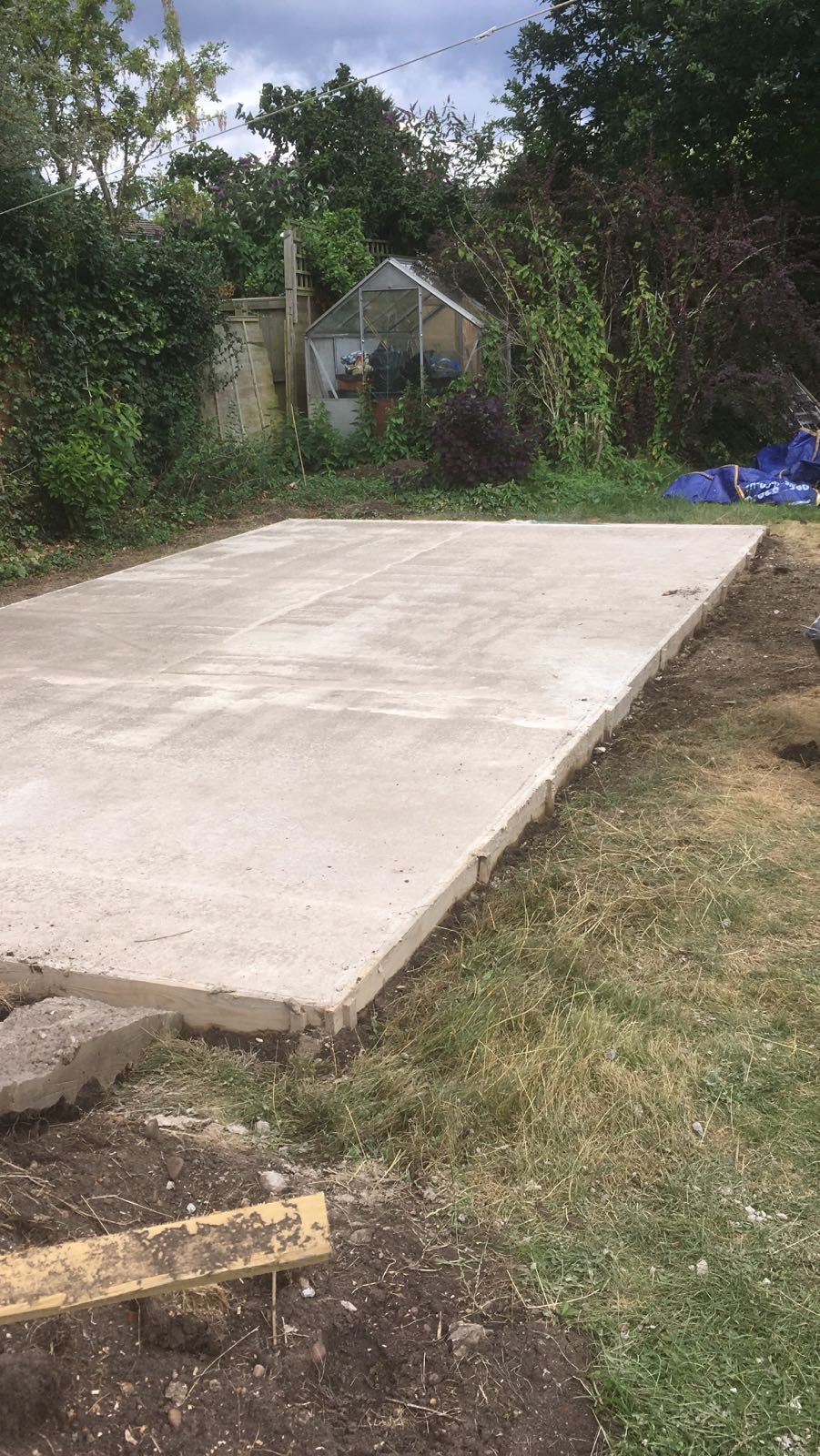

Long story short, I need to pour a concrete base for a 24 ft x 12 ft shed.
I plan on levelling the ground and removing the top soil. I will then construct formwork and place 50 mm compacted type 1 in the bottom. I will then fill with 100 mm concrete.
I have done a a few bases before, but nothing of this size - as such, I was womdering if I could pick the brains of those that have....
Firstly - any tips on levelling a 24 ft piece of timber? May have to consider Road Forms, but im not sure how you form 90 degree angles with them.....
Secondly, would a slab of this size need some kind of control joint? If so, whats the easiest way to achieve it?
Thirdly - would it be advisable to build in a slight gradient?
Fourth - would a shed base of this size require some 142 mesh?
Any other tips, greatly appreciated

I agree up the hardcore , level your formwork by screwing through support stakes on the outside. With regards to a control joint your ratio is spot on but the total area is borderline, the std formula for 100mm concrete is largest ratio 2:1 no area larger than 20sqm. a single cut cutting it in half across the long side will do, cut through to half depth. if it is particularly hot cut it in wet, if not the next morning should be fine. silicone it in afterwards.
Otherwise A142 mesh supported at mid depth should stop it cracking

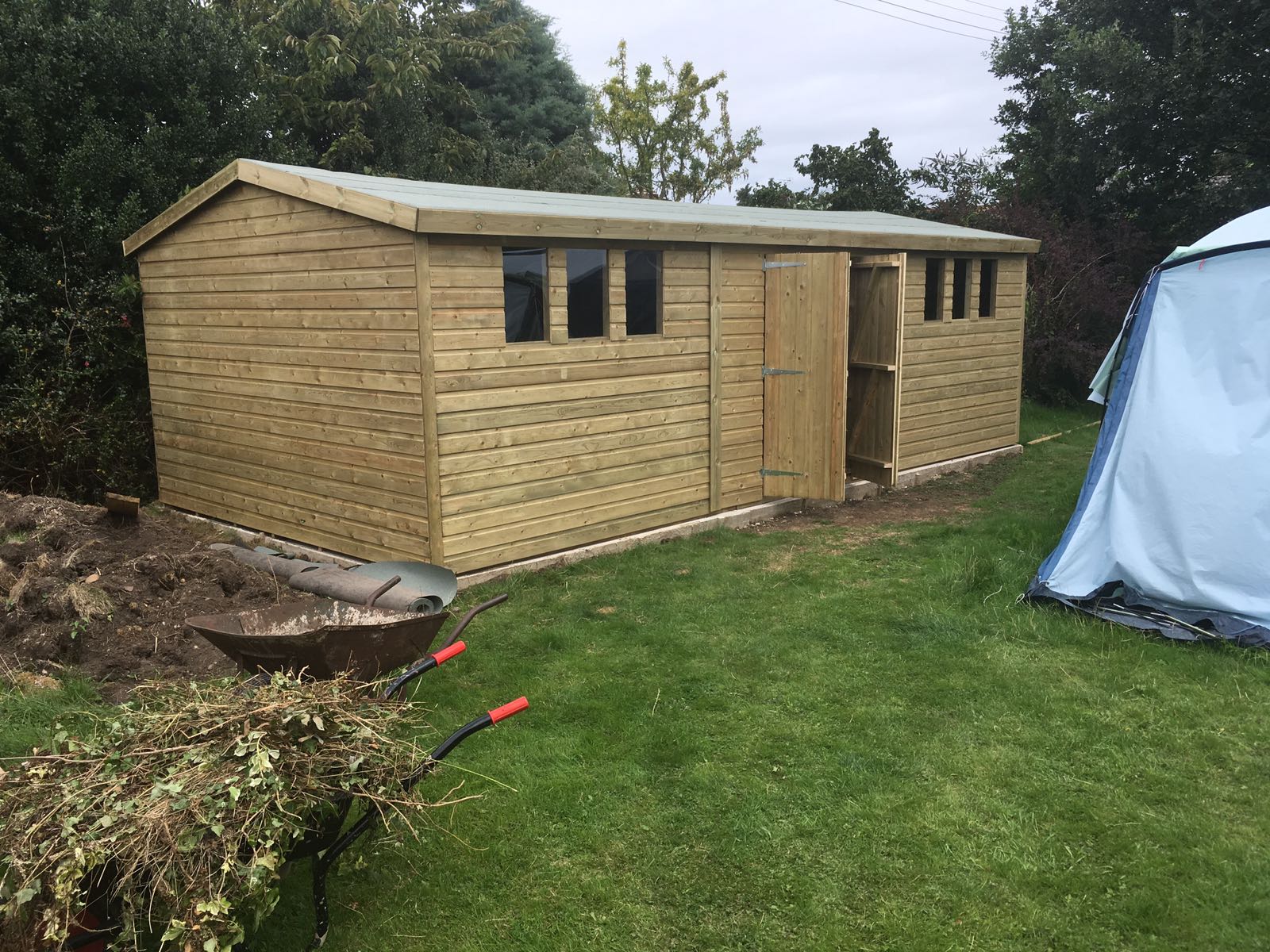

Thanks for all the help n tops. Sheds in - the installers stated the base was a pleasure to work with.....
