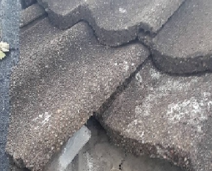

I have no bird guard along the roof tiles, can this be a DIY job just push the tiles back and nail bird guard or do I have to get a roofer/joiner to do it?

Depends on the tiles, whether you have scaffolding and your disposition regards working at heights.
I have attached picture of tiles, can ladder do as its a bungalow and will have no problem with heights.

Can this be. DIY job?? Can it be installed without removing first row of tiles
If you are trying to install them under the first row you would need to remove the tiles.
push up second course of tiles, remove first. Nail on comb filler replace tiles keeping them in line with the tile above.
gets tricky near hips, valleys and verges
