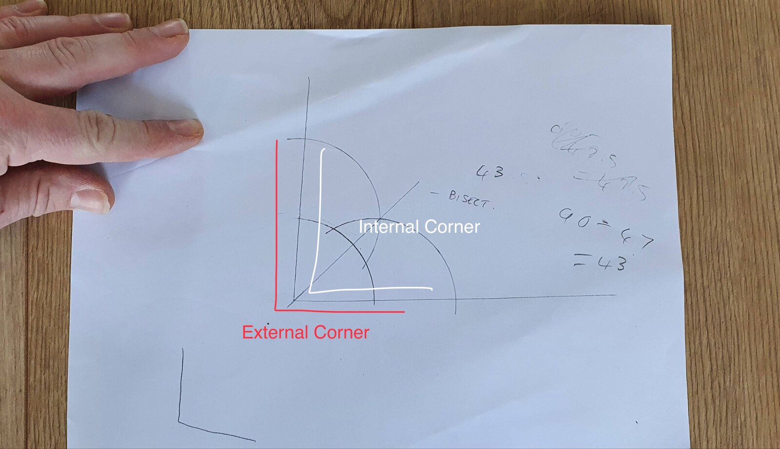

The issue I am having is cutting an external mitre to the correct angle.
It seems it needs to be cut at 47 degrees, my standard evolution mitre saw cuts to 45 max.
Mark the 47 degrees angle on the edges of your wood, then go to your saw, it will work ones side or the other
