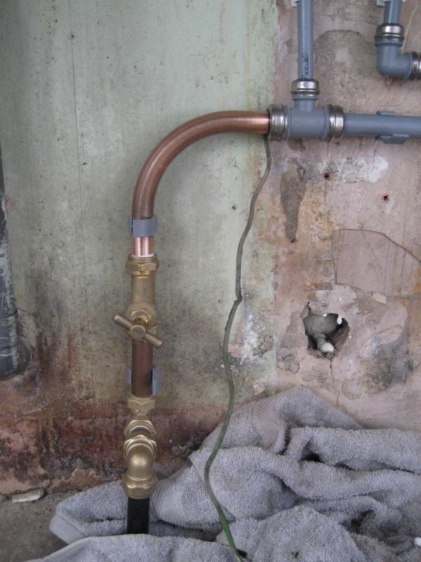

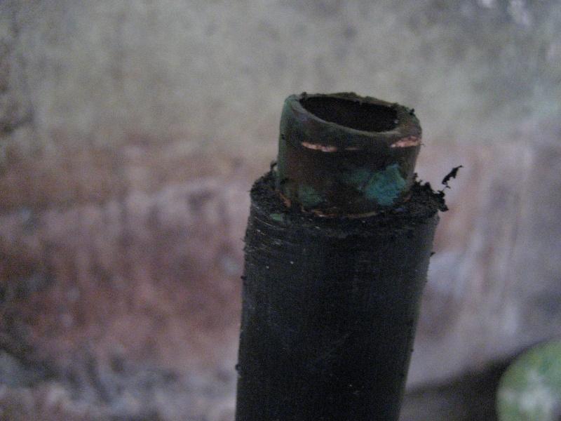

I'm fitting a new kitchen. The current incoming cold water feed is in the 'wrong' place as it will come up through the floor of the sink unit and will mean cutting a hole / slot. It's preferable for all the pipe work to be at the rear with just the stop tap handle poking through the rear panel.

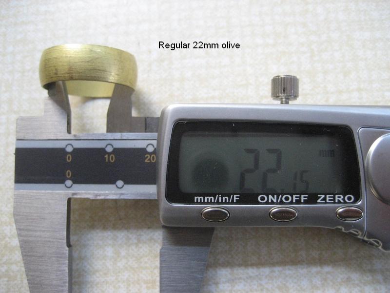

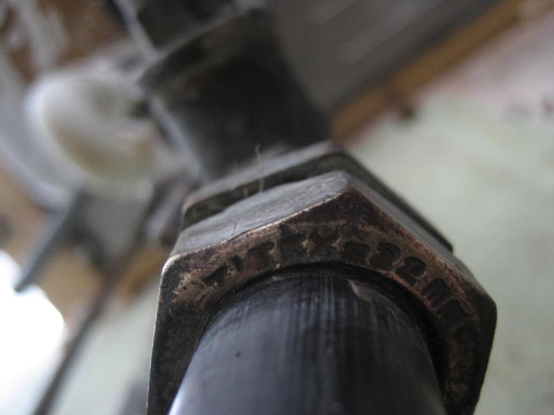

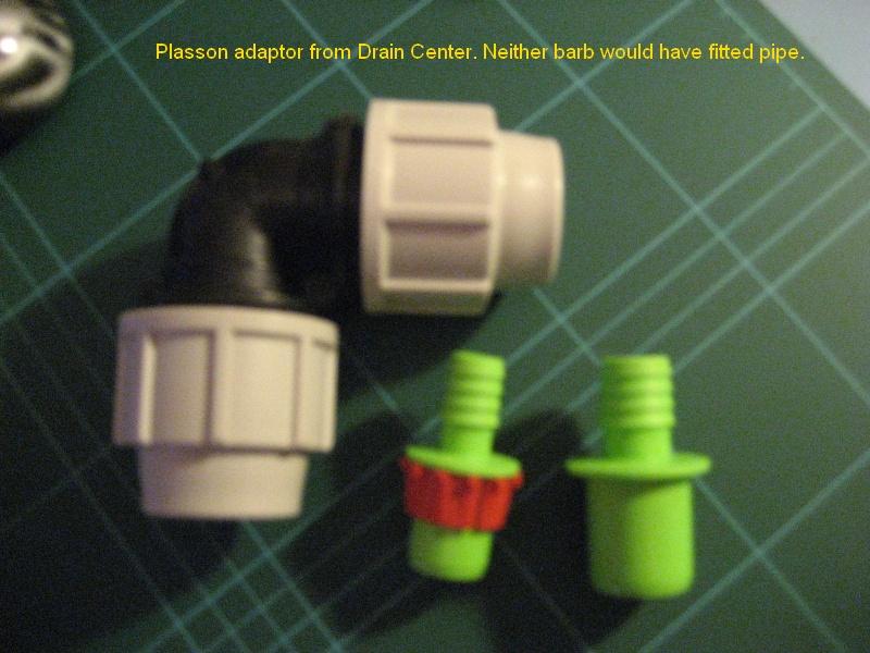

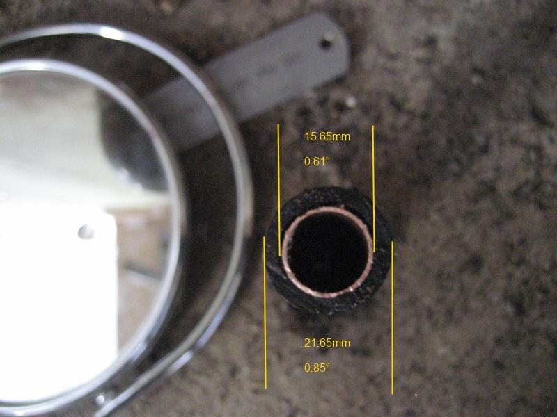

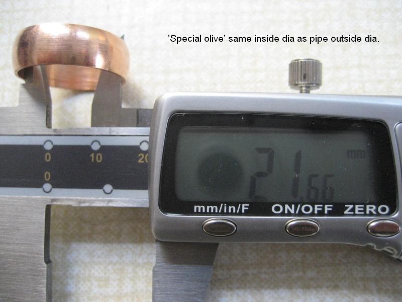

So, I intend to fit a 90 deg elbow to the incoming 22mm plastic pipe to route the feed behind the unit. My query is this, do I need a metal pipe support for the plastic pipe? My only experience of plastic pipe is using Marley Equator and for that you use a little metal insert in the end of the pipe to stop a copper compression fitting from crushing the pipe. This black plastic pipe must be approx 30 years old and I'm not sure if an Equator insert would fit inside it.
Grateful for any advice.
