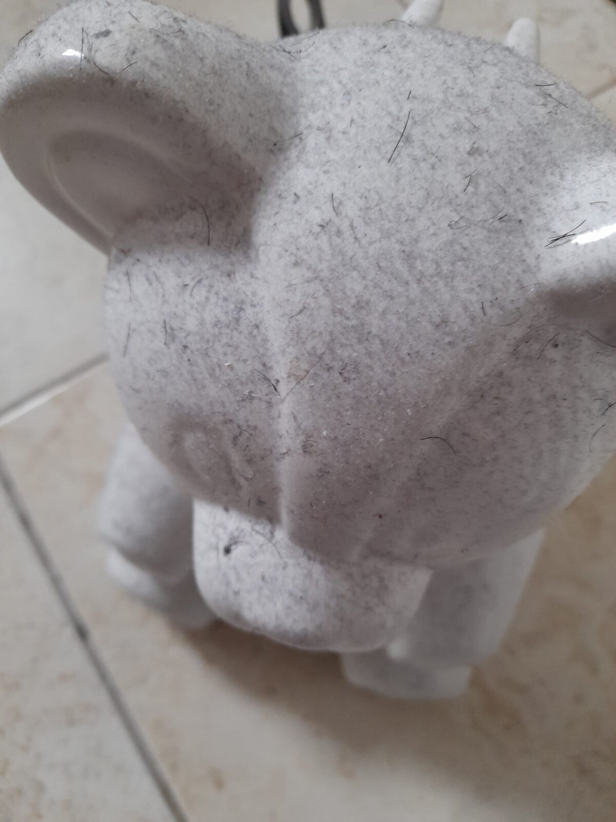

Someone checked the flu and insulation for us. We do have the old flu left up there but he checked that too. I can send a pic of the dust

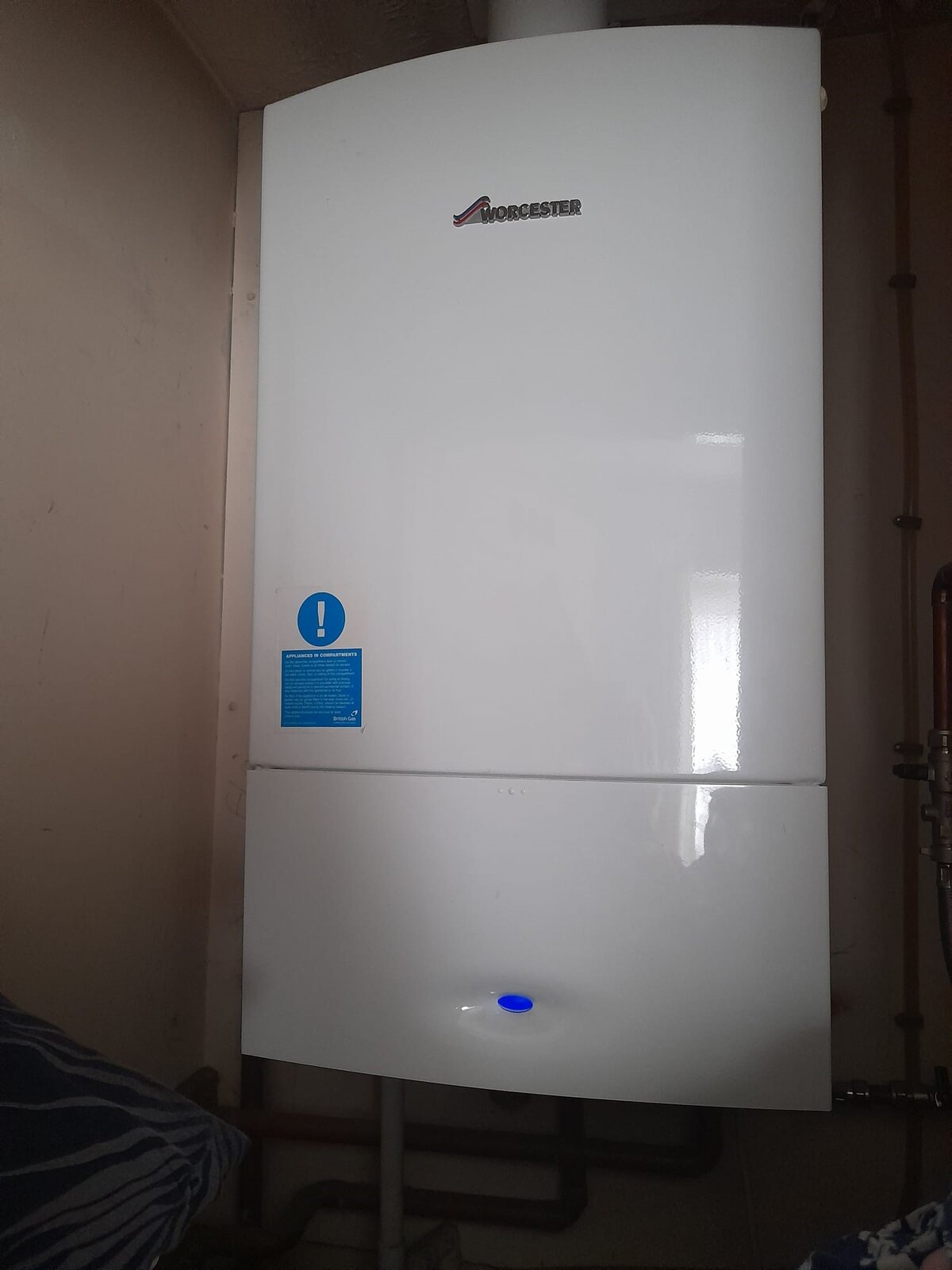

Totally Stop using boileR immediately . Phone gas emergency service on 0800 111 999 and tell them you think you have fumes from boiler they will be out within the hour
and put a pic of your boiler up

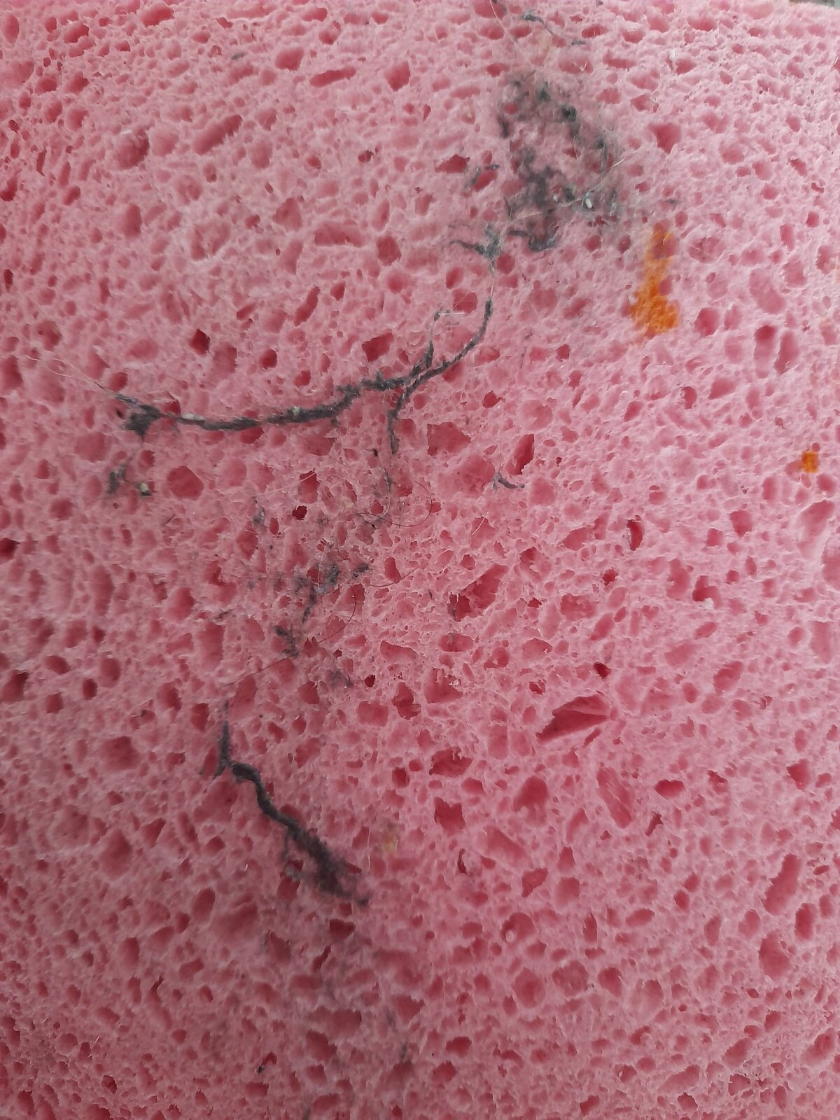

show us a pic of the dust when you rub it with your finger on white paper. actual soot is very fine and sort of greasy.
old houses often have black dust under the roof that can get washed down by a leak.

The soot/dust seems to act more like dust when you try and pick it up.
I have noticed its much better lately since we stopped using the heating. I was washing a slick of black off the bath every morning. It is still around the bottom of the door of the airing cupboard in the carpet which is harder to remove
I will now try and send photos. If you magnify it on the China you can see better.
Boiler is Greenstar 15i system
If it seems you are getting soot when the heating is being on then this seriously suggests a problem with the boiler or its flue system .

we called out british gas , they checked the boiler , then the flue, and issued a certificate that the boiler was fine
Do you have CO monitors in these rooms where the black dust is appearing ?
Yea we do. In the airing cupboard and on the landing outside , both changed recently to ensure working correctly , sorry I am shells son
