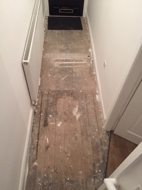

I'm doing up a victorian terrace. Its my first home and budget is a touch-tight.
One of my last jobs is to do the hallway and porch floor - its half tongue and groove, half chipboard - this is it:
I'd like to tile it - so the plan is to use 6mm HardieBacker (well… 'No More Ply' as it is less than half the price @£7/sheet) to go over the timber before tiling over.

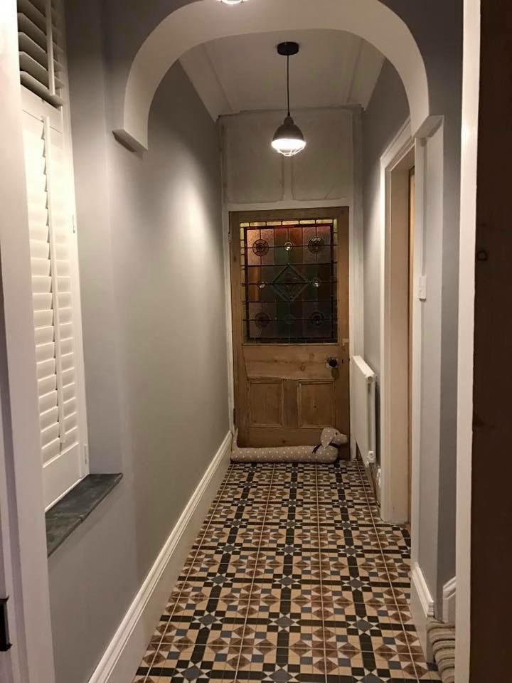

Just to throw a cat among the pigeons, I don't trust tiles on floorboards no matter what you lay on top, so perhaps don't rule out vinyl. Waaaay cheaper too. PS: I think 'encaustic tile' is the term you were originally looking for.
I think encaustic is the right field but wrong game.
There are some great looking vinyl options but I have never had a good experience with Vinyl personally. Price is a plus though.
If you go with the tiles that Lee suggested then k think you will be onto a winner for the price.
Some lovely work there! Definitely going with Lee's tiles.

Make certain that there is no movement in the floor joists - that chipboard is probably a remedial repair from previous damp damage - possibly moisture was coming under the threshold.
There will be a v. vulnerable joist just before the threshold wall.
If possible, go under the floor and check the joists.
Screw all the boards down tight.
Tile and backer board will raise the FFL?
