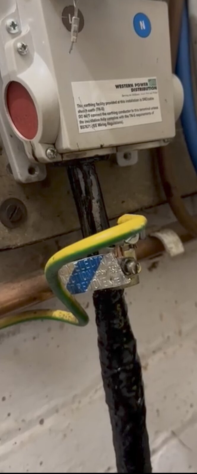

Black tar is leaking from the electric meter running down along the pole, is this normal?
It doesn't smell and is not hot.

Could be a sign of a serious problem or it could just have been poorly installed. Either way, call 105 and ask the network operator to come and check it. It's their property and their problem.

Yep, only when very close to it I can hear a screeching sound

Possibly a loose connection. This causes heat to build up, warming anything nearby - including things like the cable innerds. Hence the tar.
To start with, the loose connection will be warming up the area, followed by serious heating, followed by …
Well, it’s not going to get better. If it gets worse then it’s fire brigade stuff.

The melted tar tends to happen under heavy load, such as using an electric shower or multiple electric heaters. If you are away it will probably not be hot. It is a fairly common fault with old electricity supplies, they will most likely just swap out the service head and/or meter.
Your picture shows the service head, not the meter. It looks quite modern.
A fizzing noise is a bad sign.

It does. Tar/pitch oozing out of ancient cutouts was quite common (and, I think, often pretty 'harmless'), but I can't say I'vce seen it with a 'modern' (i.e. plastic) one,

Yes it needs the DNO to assess and take corrective action if necessary ASAP!

That cutout has been remade recently- BADLY.
whoever has done it doesn’t seem of have removed the old bitumen and used a heat shrink breakout and tubing to seal the cable and prevent any further mess happening, if there are any noises the. This could indicate arcing. Call 105, it will will need redoing- hopefully to a better standard.
