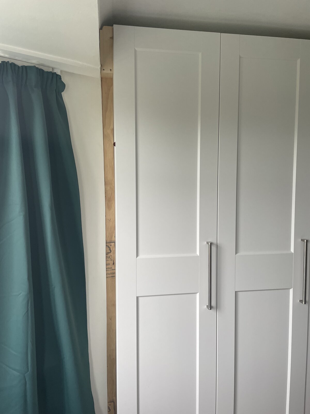

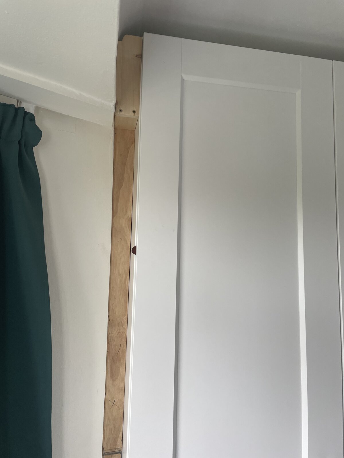

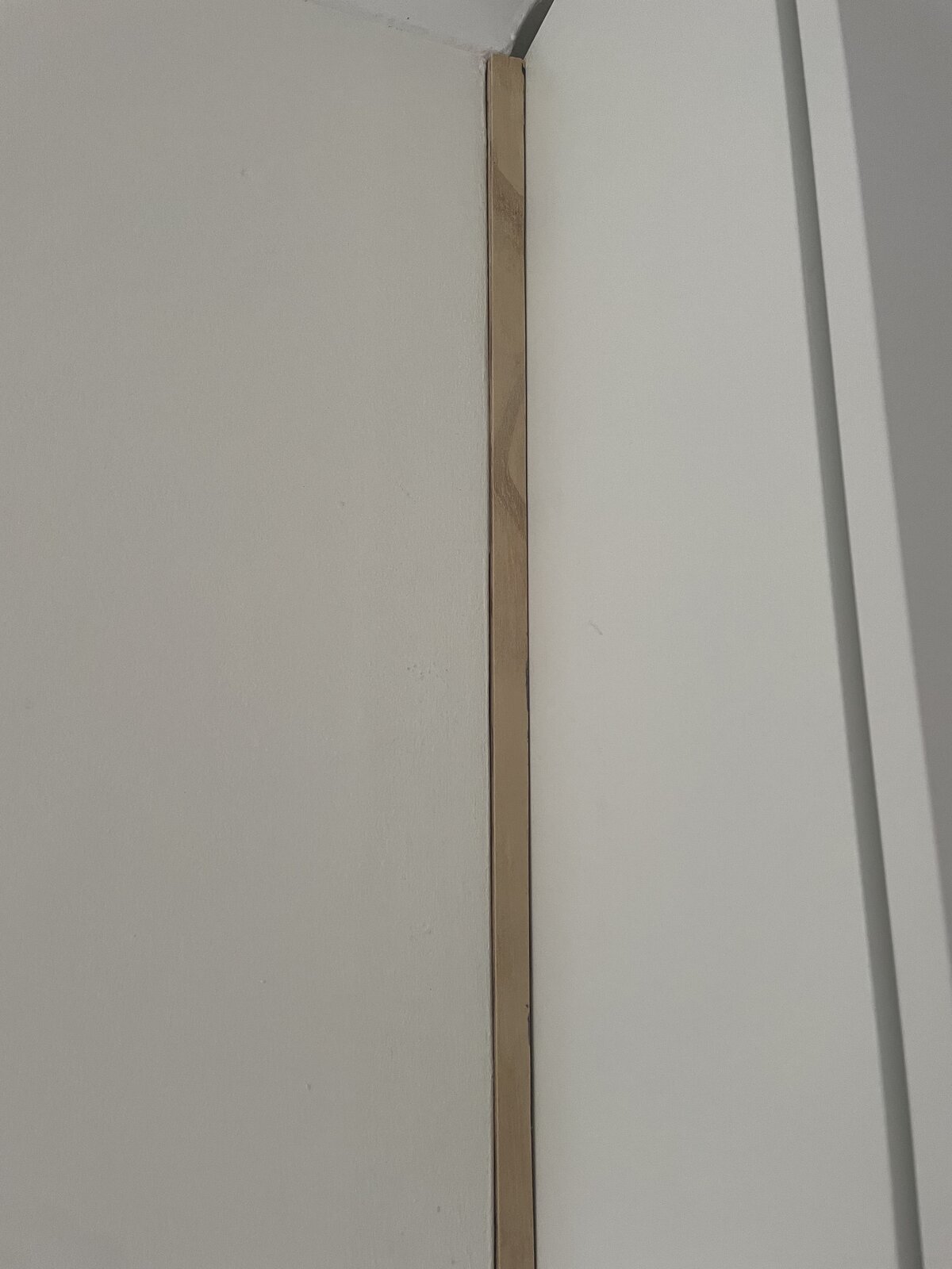

I’m installing some ikea wardrobes so they are built into the chimney alcoves and I’d like a seamless transition between wall and wardrobe.
I’ve cut some pieces of thick ply to fit in the space between the chimney breast ( yet to be secured) and wardrobes for a base to build upon but I’m not sure of the best way to finish it.
I’d like to skim it with joint compound (leaving a few mm to caulk to the wardrobe) so I could then sand and refine before caulking and painting, but obviously skimming to bare ply is a bad idea..
So really I’m looking for something that’ll adhere to ply and the wall that is preferably sand-able or maybe a coat to the ply (pva?) so I can skim over it, or any other suggestions how to finish these wardrobes and have them blend seamlessly.
Thanks in advance

Ideally you would’ve left room for plasterboard, then skimmed over that.
Better to have a small recess at edges, flush will always be cracking and looking cwap.
Thanks.
It’s not too late to put plasterboard in, the ply hasn’t been attached yet. I could potentially push the ply deeper a use it as backing for plasterboard.
I’m hoping having a couple of mm of caulk might buffer any cracking. Could be kidding myself tho.
