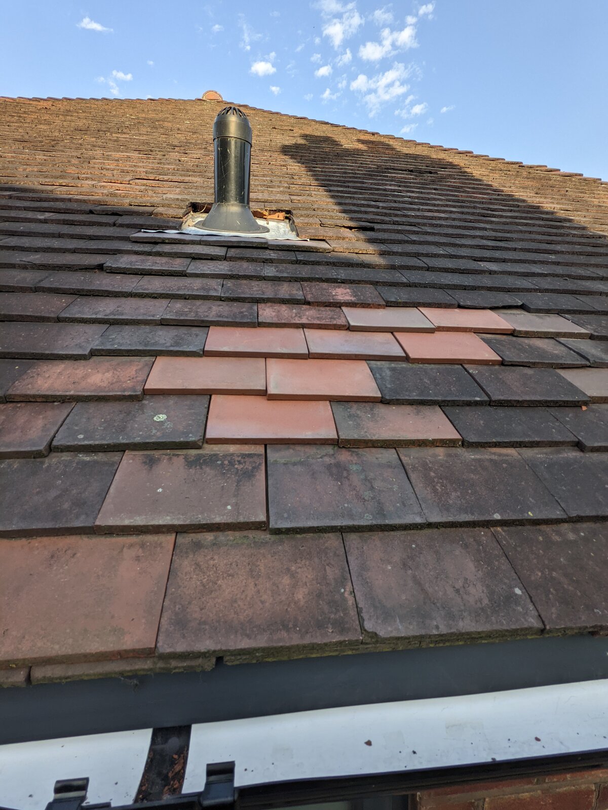

Hi I have put some new tiles in whilst I have scaffolding up.
Any way to blend these in ? Someone advised to paint with milk or eggs to darken?
Any thoughts?
Thanms
Hi why not take out a row of lower tiles and put the newer ones in a row It’ll look bit better in my opinion
Good thoughts :) oh dear doesn't sound good with the soil pipe what shud it look like and what are the risks leaving it as it is?
RH side should look like the LH side ideally with tile and half , not halves. That delaminating tile isn't good either
