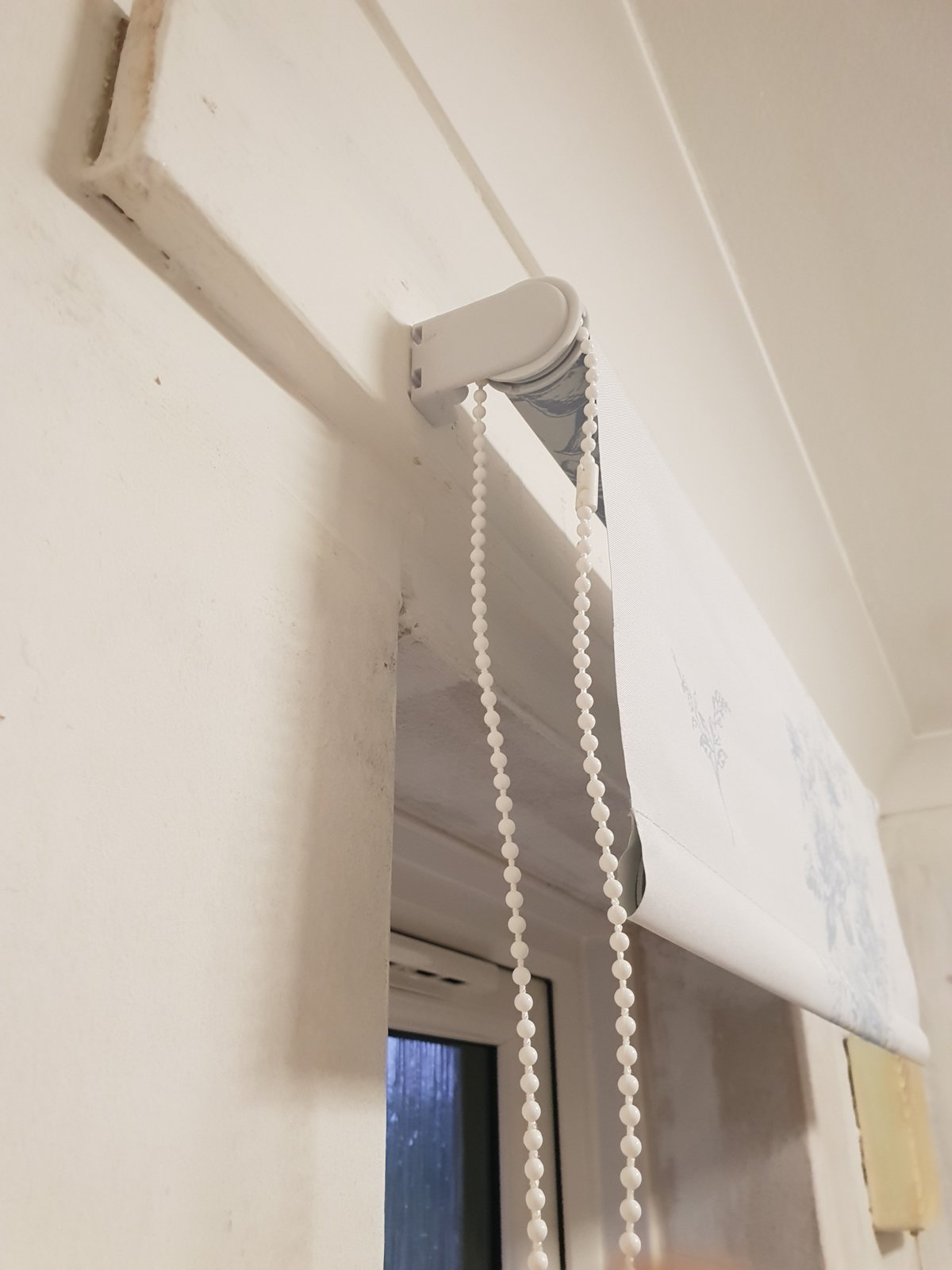

Hi guys, is there shorter fixings i can get to make the blinds closer to the wall?
The wood is there because its near impossible to get the blind straight into the wall.
So ideally i want to still go into the wood
1. Reverse blind so it rolls down the inside rather than the outside of the roller.
2. Fix brackets pointing down (add another piece of wood to provide a suitable fixing).
3. Combine 1 and 2.
or:
4. Cut down blind so it fits in the reveal and fix to window frame with self tapping screws.
Reverse it! Why didnt i think of that!
Thats what ive done and its defo better, mrs dont want it on the frame of the window, that was what i was going to do.
