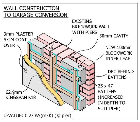

Hi,
My architect has specified block walls on the ground floor but the builder wants to use stud walls.
The garage conversion is having a second skin and the builder has suggested that it would be better to add studwork to the [existing] single skin and use 100mm thick insulation inside the studs. He says this will be just as good as the architects design which is to add internal 100mm blocks with a 50mm cavity and then plaster over 62.5mm Kingspan insulation.
Also he wants to use studded internal walls. He says they will not transmit so much noise. He says the block walls tend to vibrate and carry the noise. It all sounds plausible to me. Should I let him go ahead, or ask him to build exactly to the plans?

From a sound perspective, I would choose a couple of layers of plasterboard and 100mm wool over breeze blocks and kingspan. Heavy concrete blocks would fare better, but I would still ditch the kingspan and go mineral wool and battens.

Here's a picture from the architects drawings. This is what the architect has proposed for the garage walls.
[/img]
The builder wants to leave out the blockwork (but still have a 50mm airgap) and have 100mm wide studding filled with soft insulation and a layer of plasterboard over the top.

Tell him it's really very simple, and the way it works is this:
The person paying for the work gets to specify it.
And that therefore he can put up stud walls if he pays for them.
