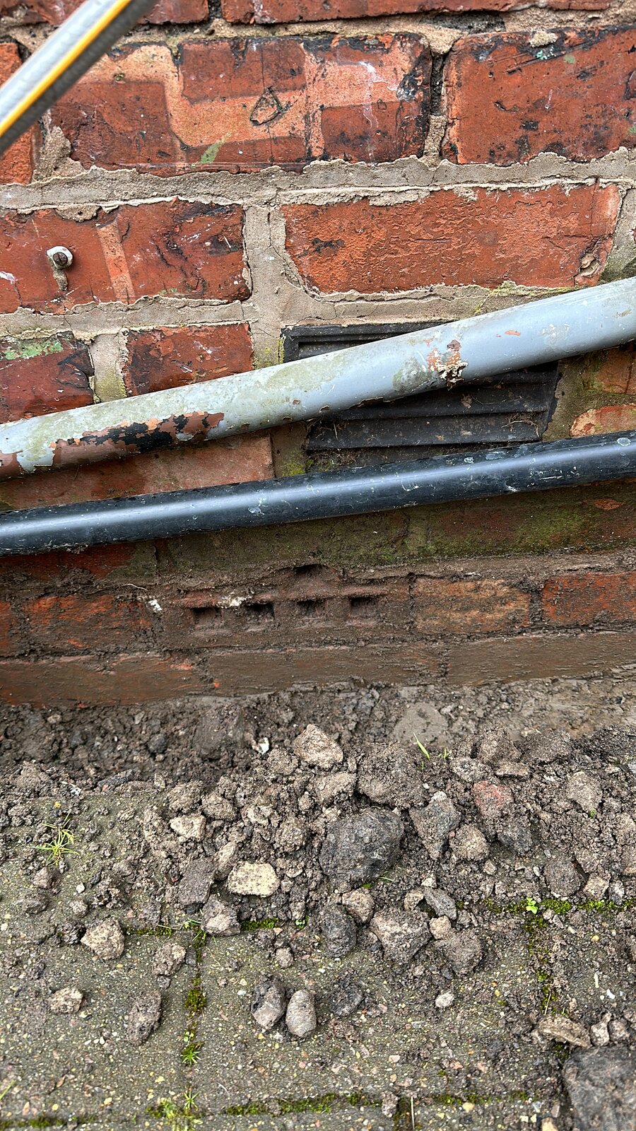

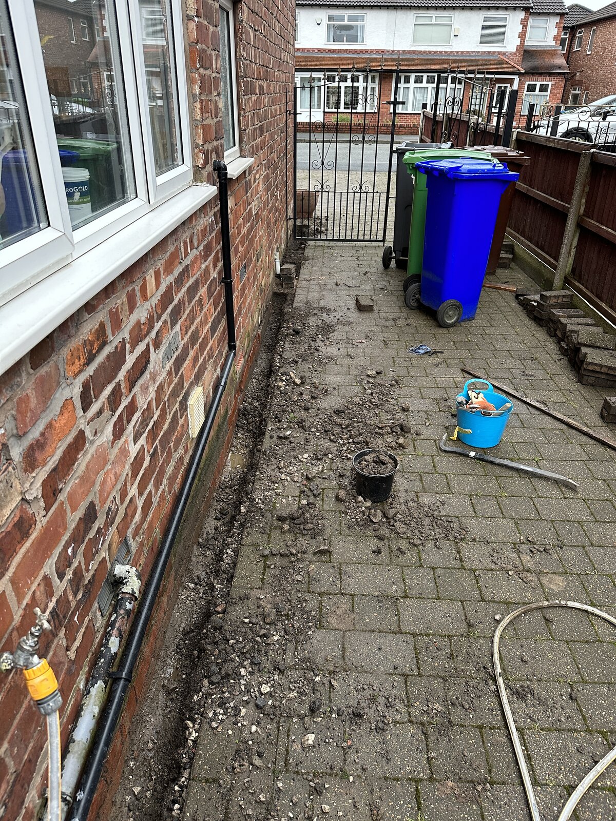

We have found a few damp patches on our external wall this winter and think the drive being built too high is causing this. I have taken up the soldier course of pavers next to the house and dug a trench to take a look. I can see that the drive was only a couple of cm below the DPC, and have also uncovered a couple of fully covered airbricks, so definitely too high.
My plan is to continue to excavate the trench and then backfill with gravel to a level below the DPC to stop the drive from bridging the DPC. The driveway will have cars on so I will this will need to be relatively strong. I would also like the edge itself to be higher than the trench so it is visible and someone doesn't accidentally twist an ankle walking into it!
Looking online I can see a few different options but am unsure which to go with. Perhaps I need some kind of kerb unit which is deeper than the trench so would finish above the level of the trench itself? Keen for as simple a solution as possible as I have no experience in laying driveways, working with concrete etc.

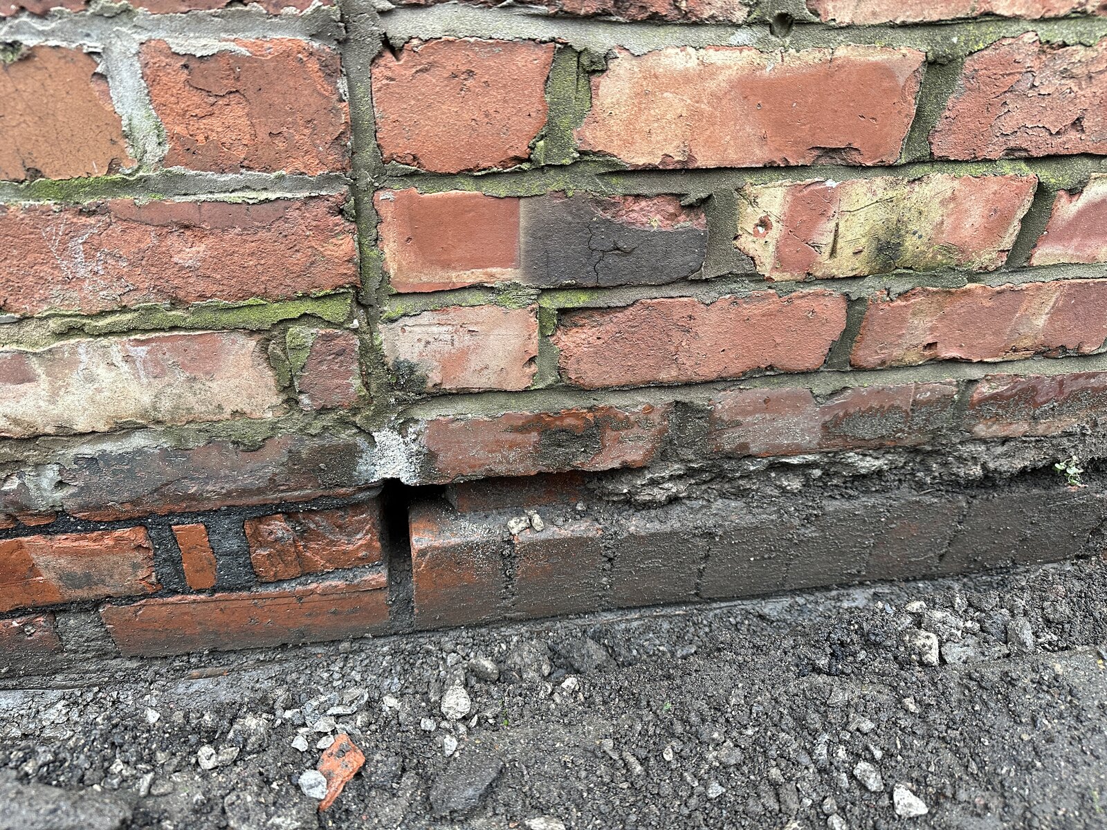

While doing this I have also found a big gap in the brickwork which was previously below ground and causing another damp patch. This is picture 3.

  1. How do I make sure the block paving doesn't slip back into the trench?
  2. What's the best fix for the hole I found in picture 3? I am thinking the brick will need knocking out and a new brick laying in it's place?

Concrete edgings laid on and haunched with concrete. Use a bit of concrete to fill that hole. Pointing looks rough.
French drain along the side of the house - and move the pipe away from the vent. Unblock the airbrick.
Cheers cdbe.
If I use concrete edgings would you recommend I lay a concrete base in the bottom of the 200mm wide trench I have already dug and sit these in it (taking care to leave some soil for water to drain to). Or would I be best taking out another row of pavers and laying the concrete edging at a similar height to the existing drive with the haunching behind it?.
150mm wide drain will be fine, obviously the haunching will reduce the width at the bottom but there won't be much water to drain away.
