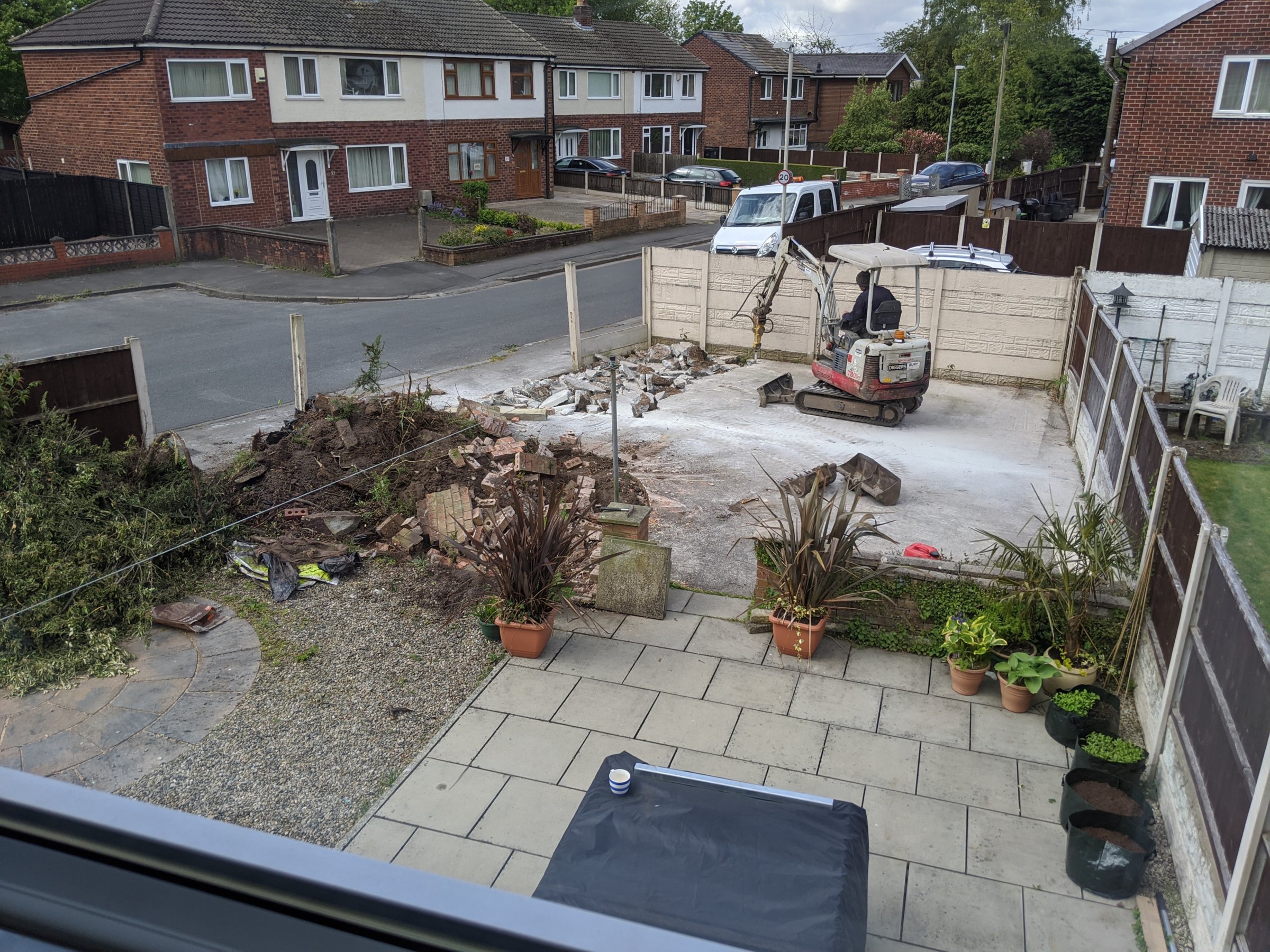

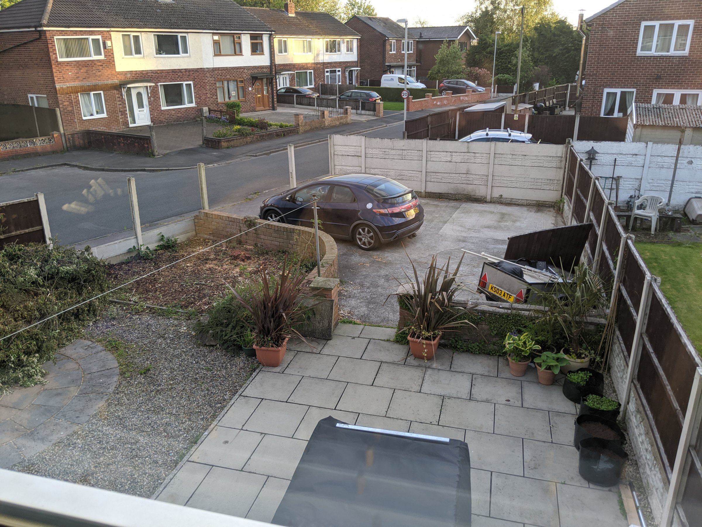

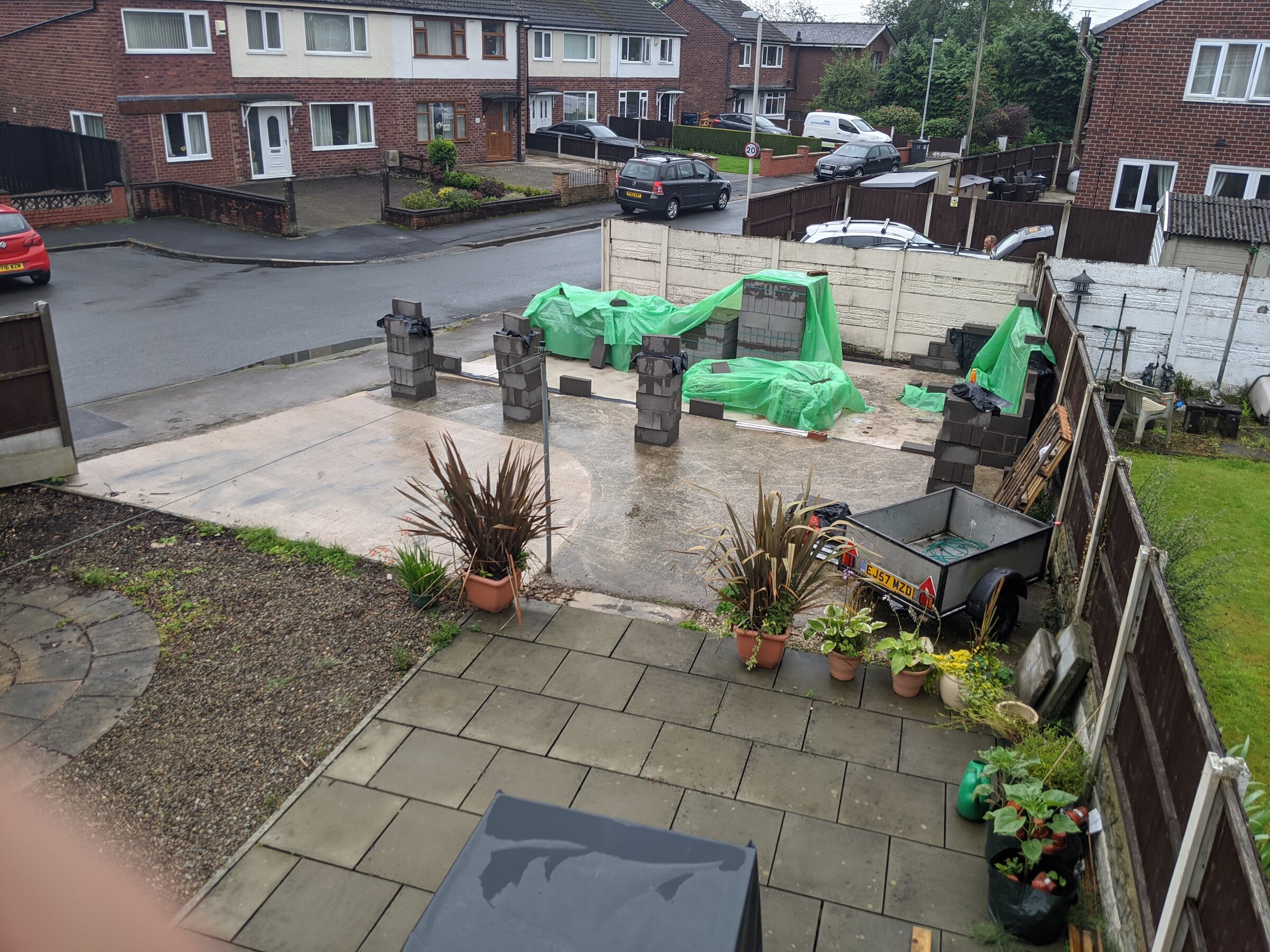

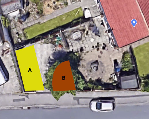

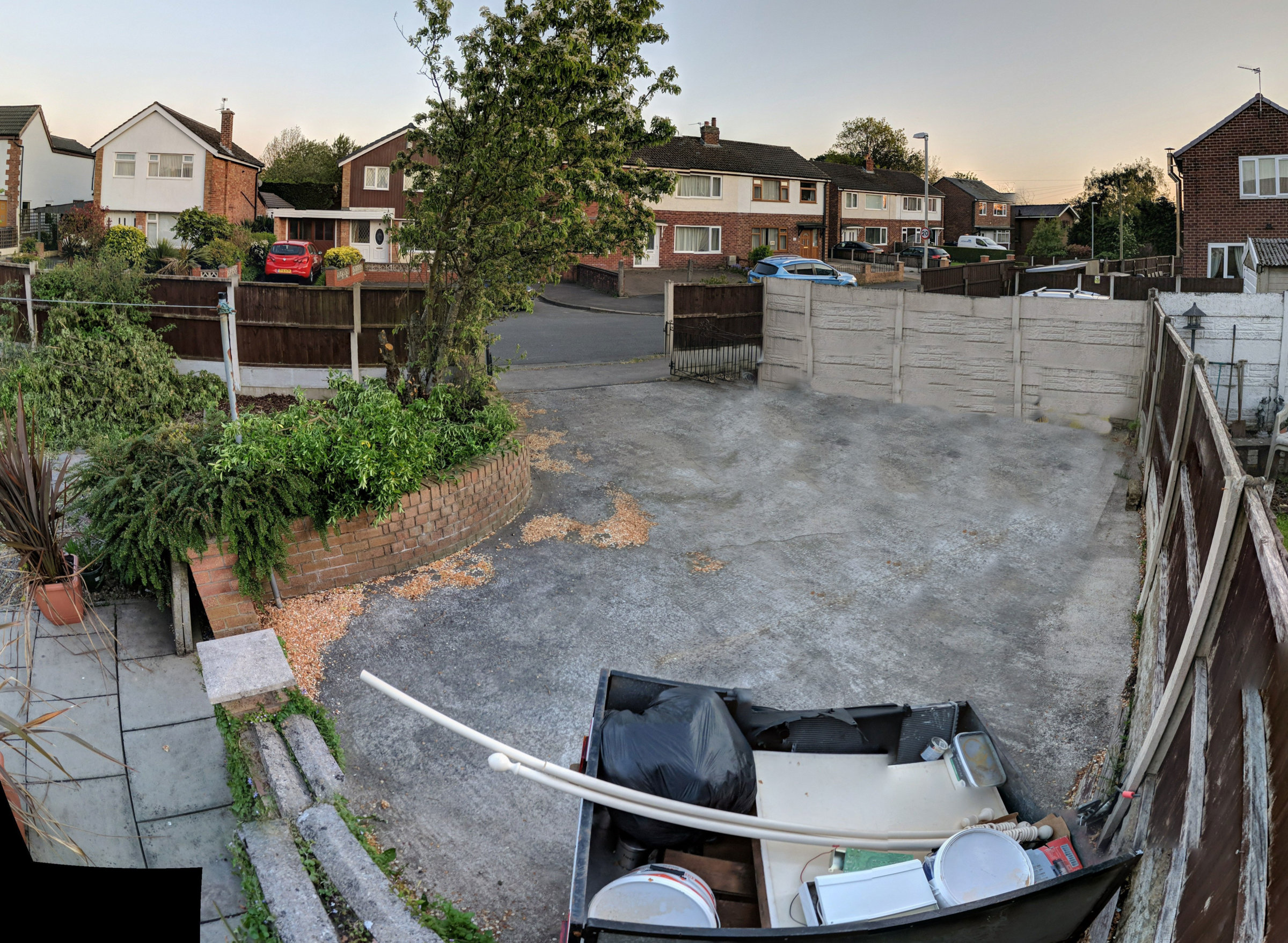

I wanted to share some pictures of the site first and where it will go:

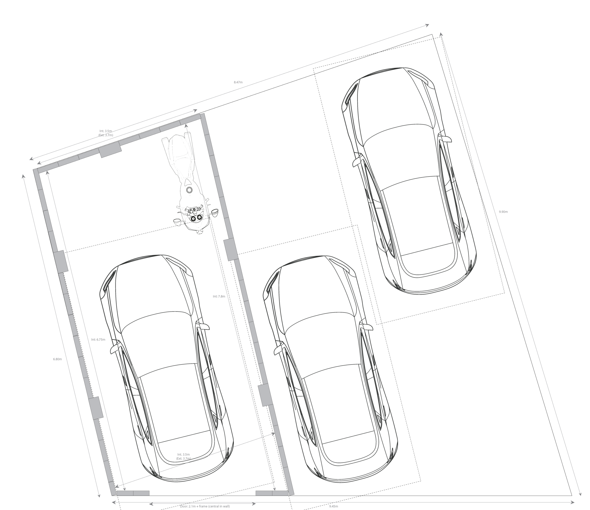

So *A* is where the garage base will be
*B* is where the drive will be extended, removing the part of the garden where the tree is / was.
That'll hopefully give me parking for 3 cars and a motorbike!
Thanks for reading! :D
judging by the picture you live on a hill, and your higher than next door?
your proposed garage is on the boundary?

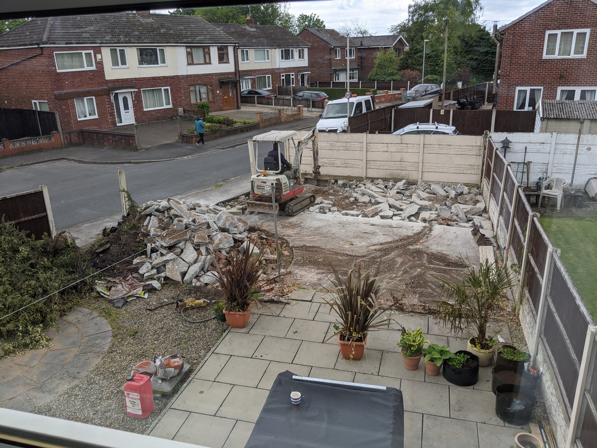

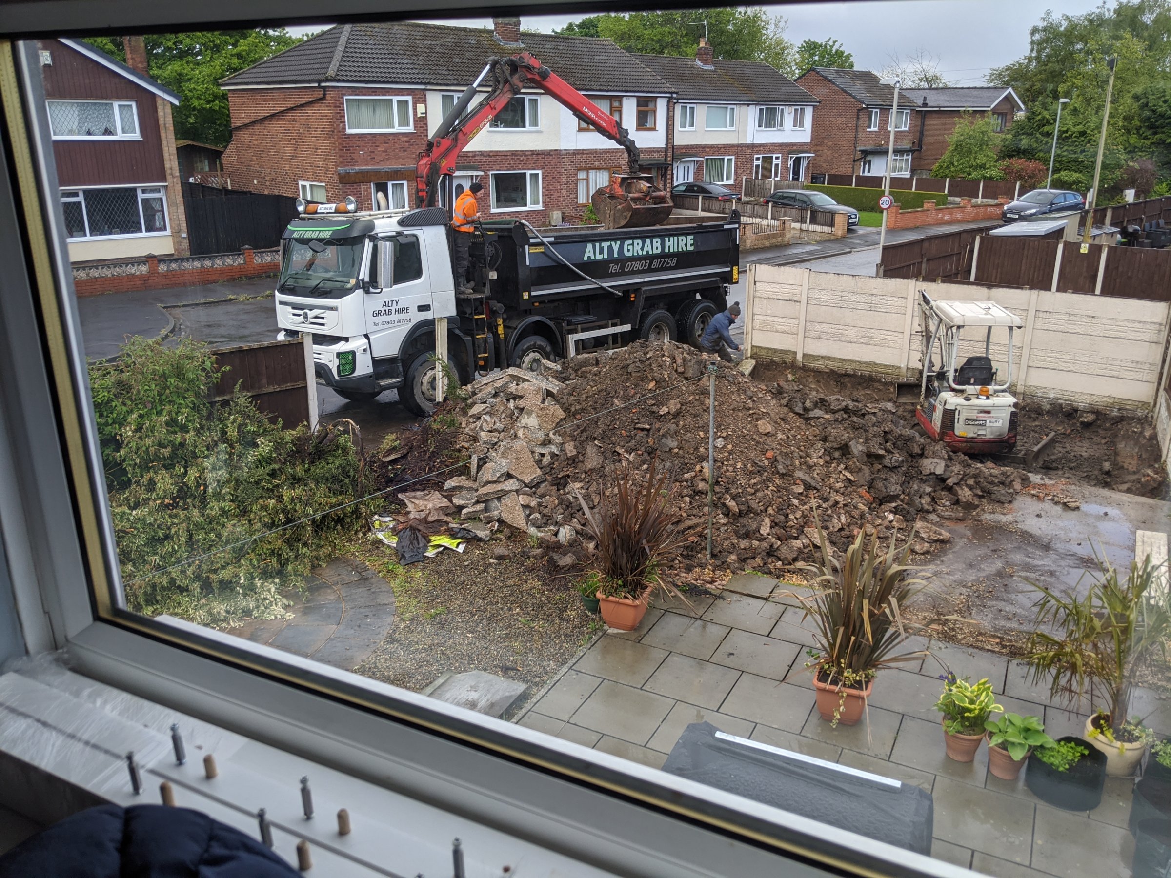

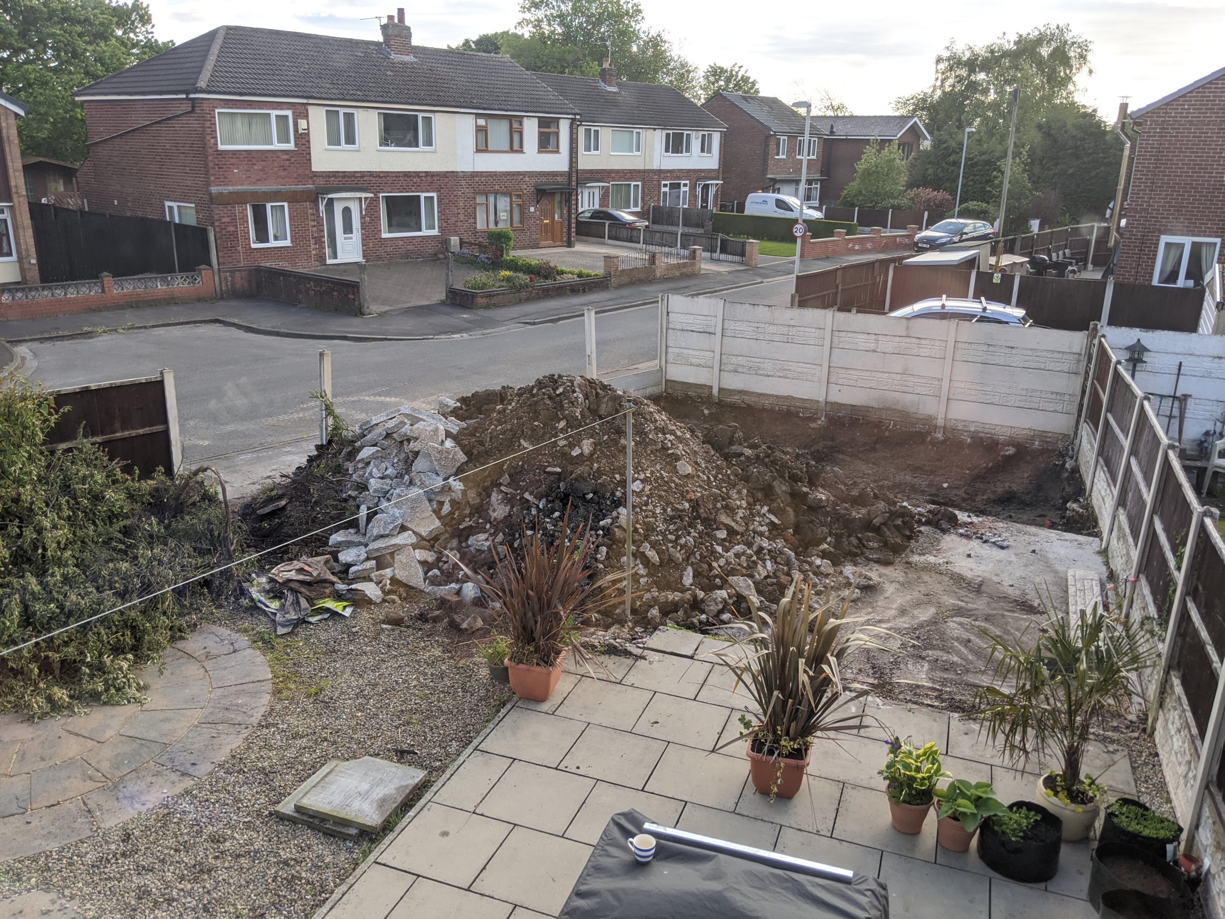

Here are some pics from this week.
Lessons learned:
  • I needed to beef up my foundations, after advice on this forum and then speaking to the groundwork chap
  • An 18T grab waggon costs the same as an 8 Yard skip
  • I needed 3 waggon loads to clear the site, at £250 each. Waste clearance will be one of the most expensive things on the project.

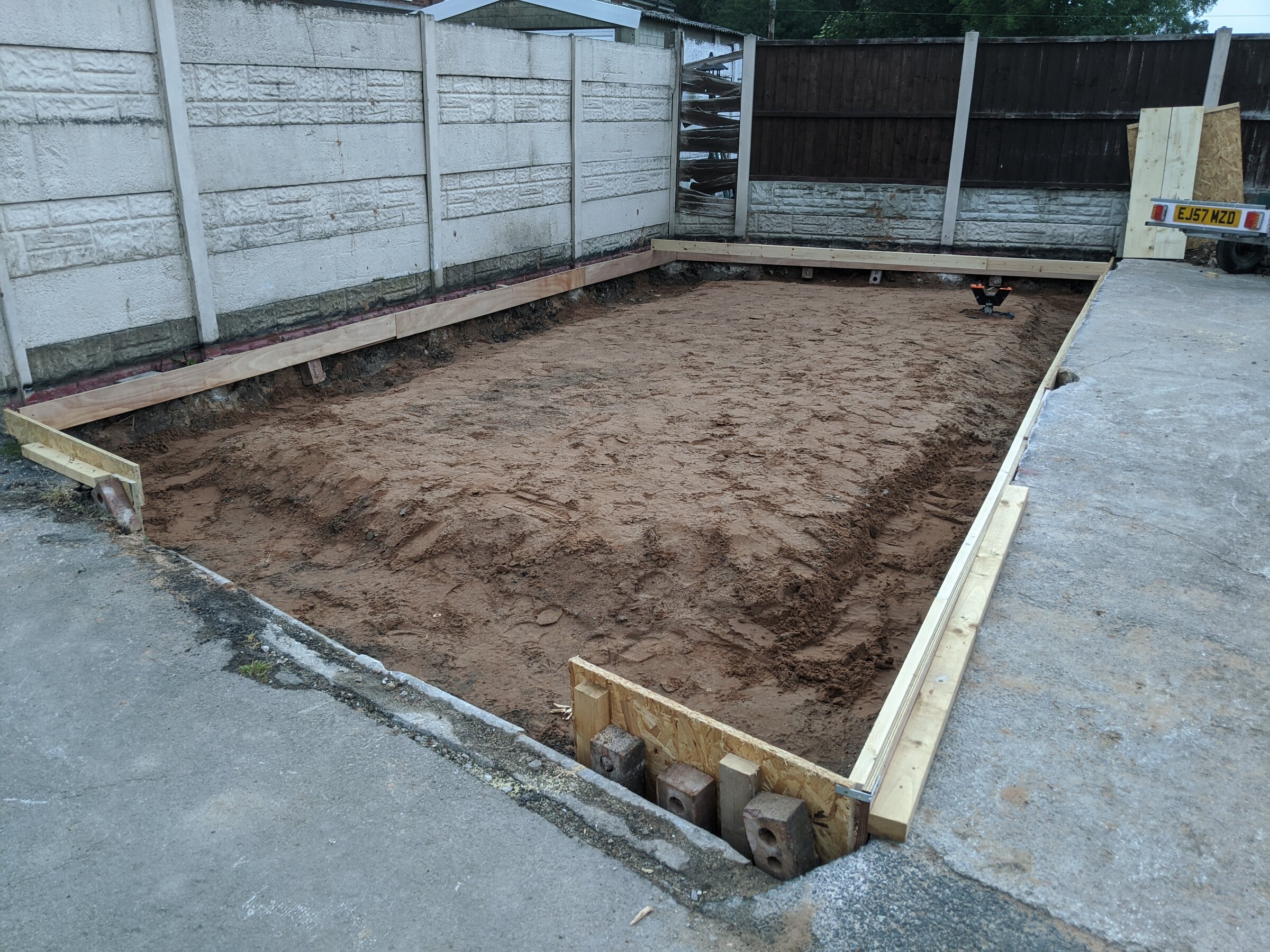

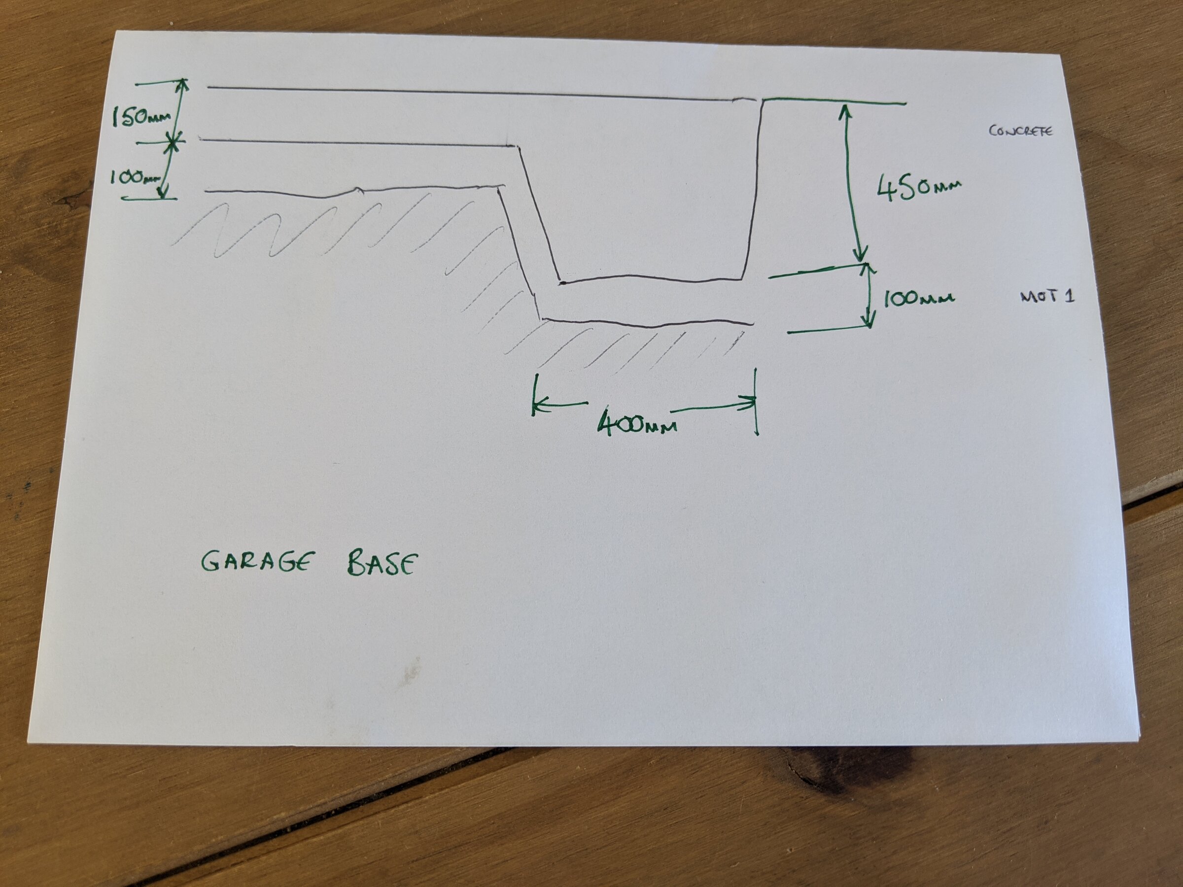

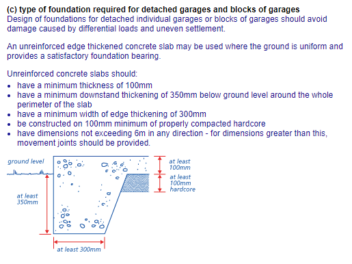

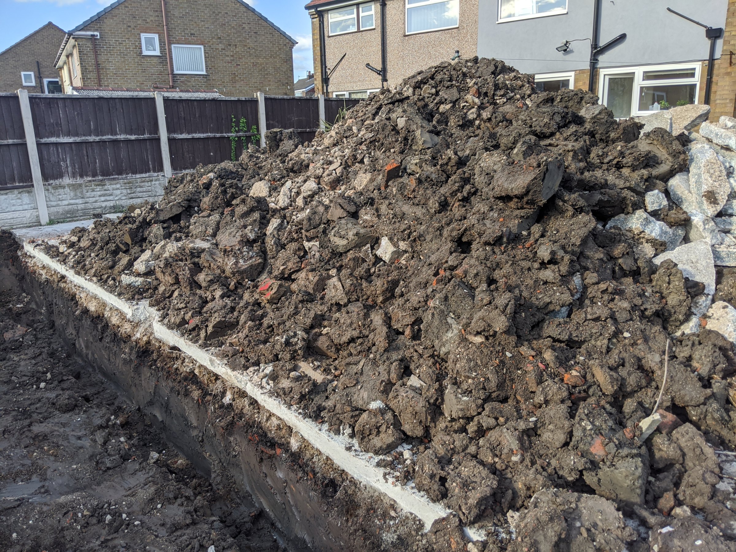

These were my original plans for the base, with a deeper slab and edge:

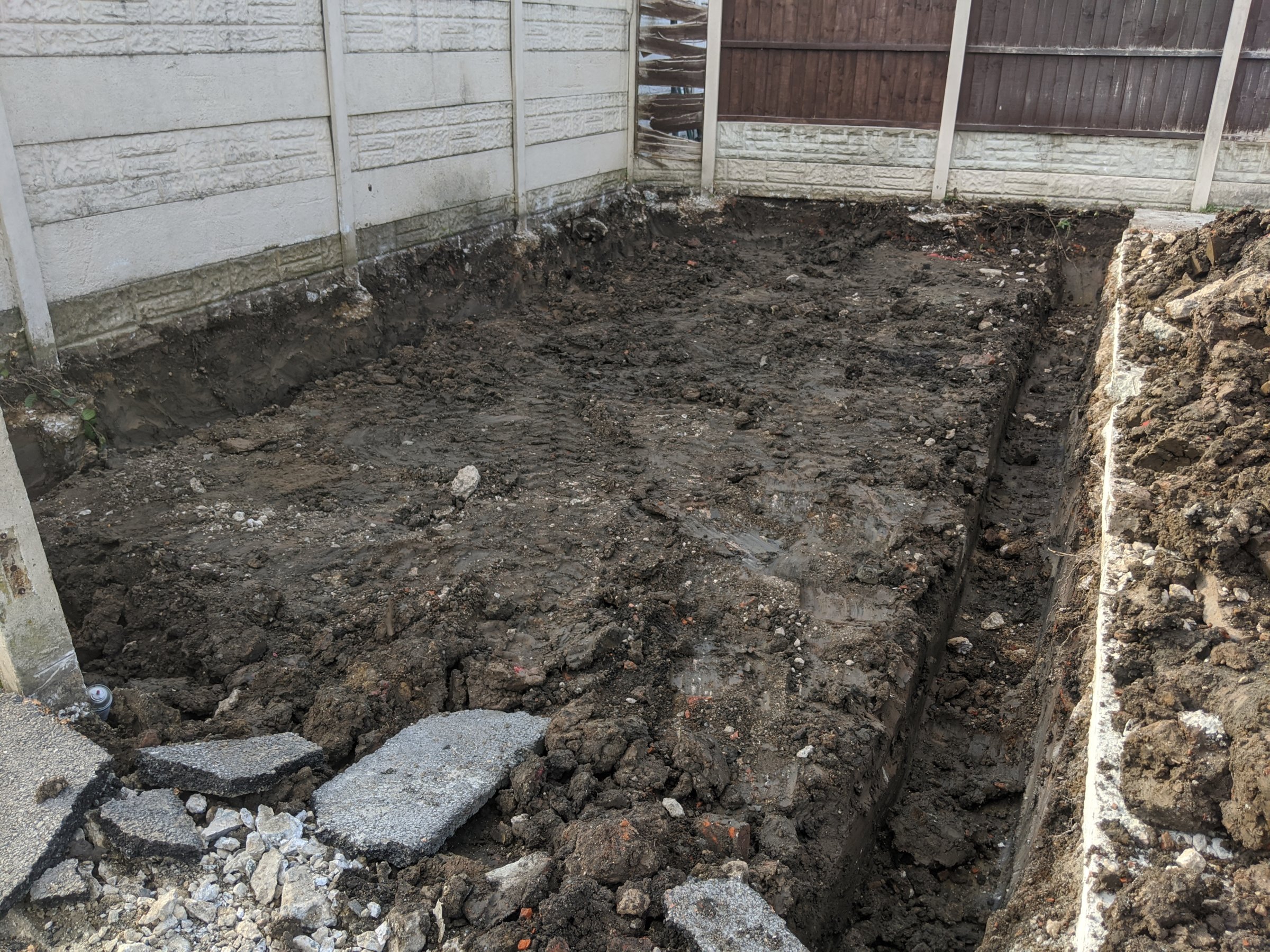

HOWEVER the groundworks guy went even deeper, but I only realised after the spoil had been removed.
In the end I tweaked the levels, dropped the height of the slab overall and stumped up £1200 for the concrete :eek:.
Some decisions I made, looking at it with hindsight:

  • There was a simple plan to follow in the NHBC guidelines: https://www.diynot.com/diy/media/nhbc-standards-for-detatched-garages.104936/

I went back to the drawing board, thinking I'd been stupid. Another post on here suggested a trench foundation too. Was I being daft?
I reminded myself of the NHBC diagram and was satisfied I wasn't going totally off piste.

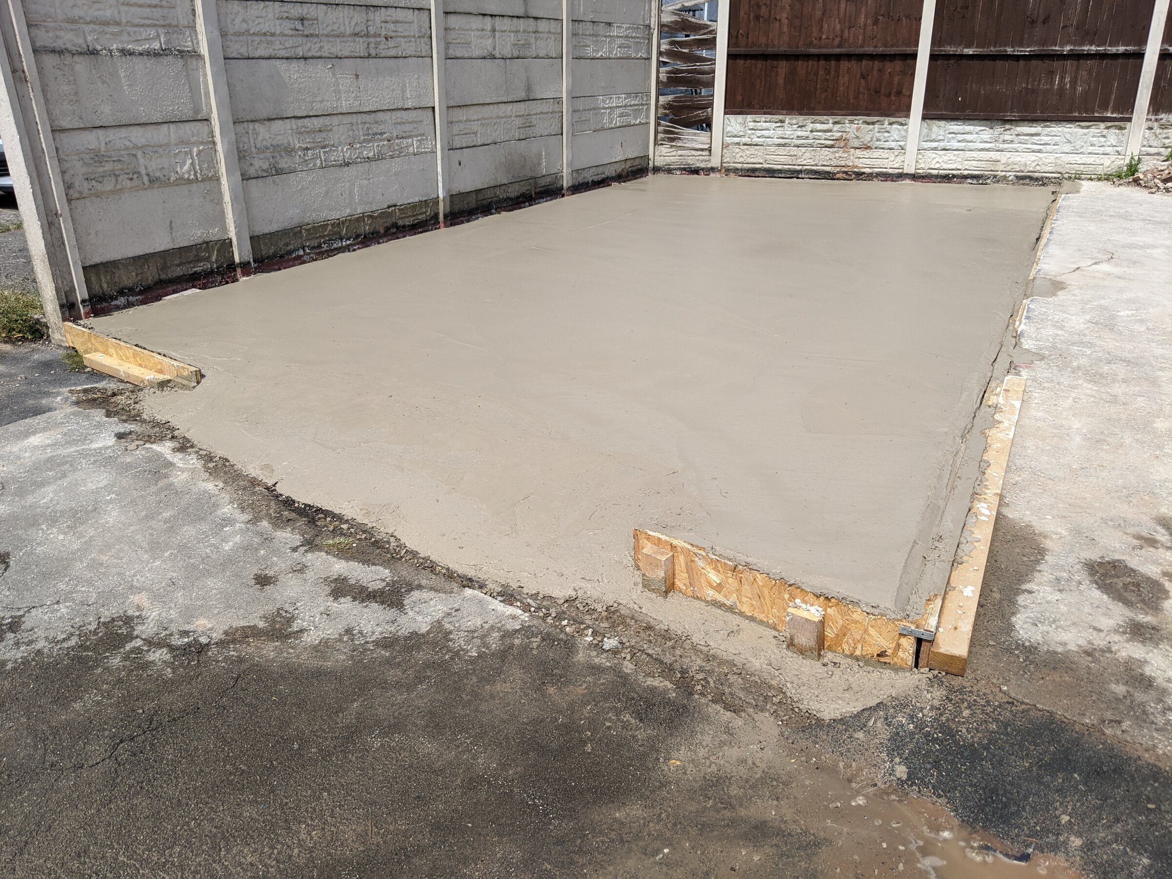

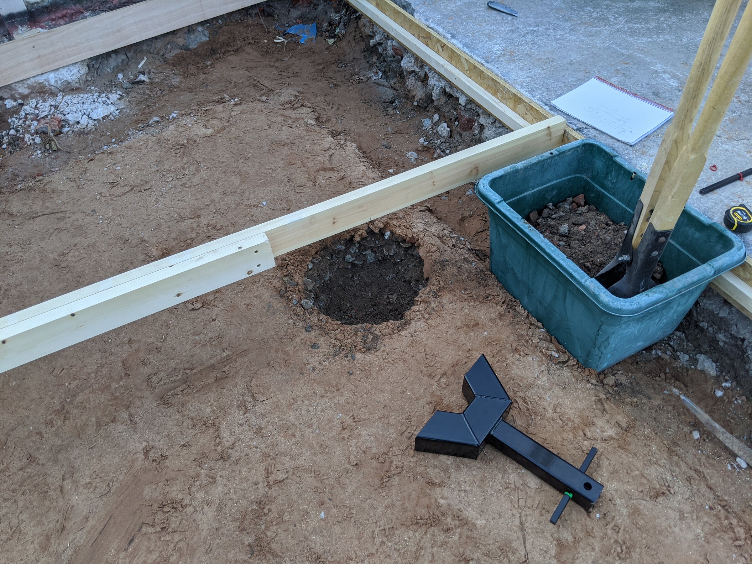

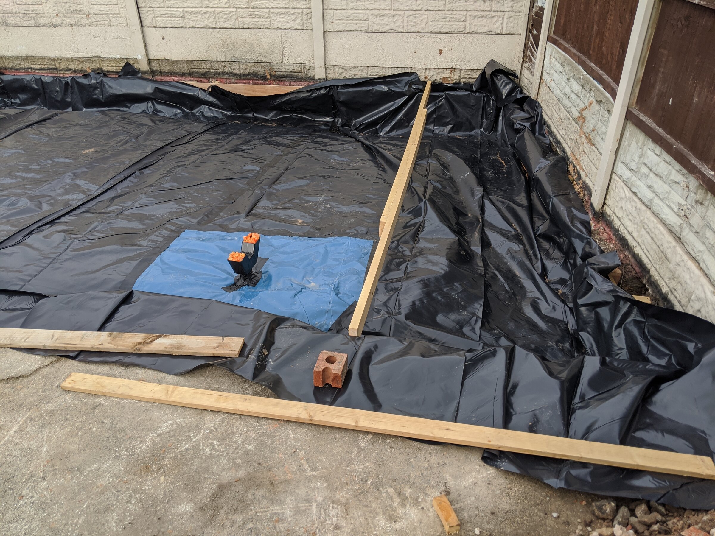

I planned to barrow and lay the concrete with a friend. The concrete company let me know that it would be 160 wheelbarrow loads! In the end we worked out he could get access to use his chute.
The guy was great, everything went in smoothly, including my ground anchor for the motorbike:
Today, at last, the brickie has started. He'll be done in a few days, then I start the roof:
