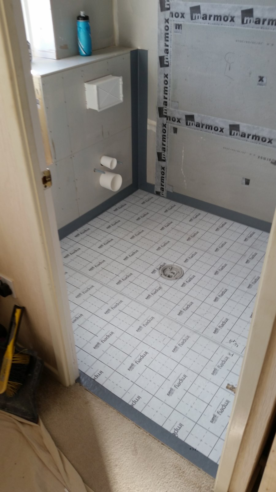

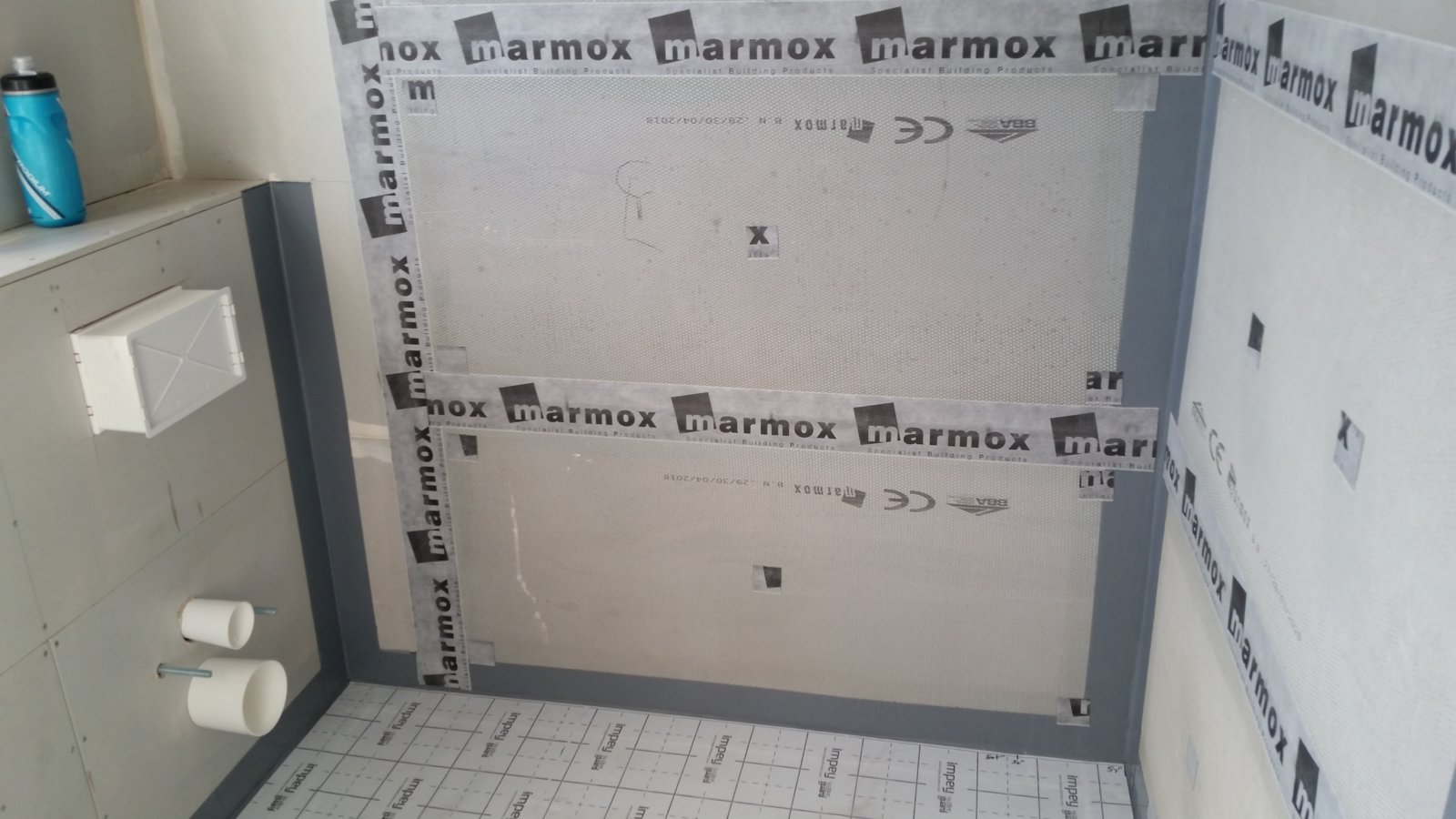

Instead of using cement boards use construction boards like marmox, wedi, jackoboard, STS or similar. The advantage of these is they are completely waterproof and don't require tanking, just tape the joints and screw heads. Use the opportunity now to level up and strengthen your stud wall and think ahead about any fittings which will be on this wall as you can fit studwork/plywood/OSB to provide solid fixing points. For your block wall first prime using an acrylic primer or SBR and fix the construction boards with cement based tile adhesive. Follow the manufacturers instructions but usually each 1200x600 board will require 5 blobs of adhesive to dot and dab to the wall. Mechanically fix through the adhesive once fully cured using the correct washers. Use the correct tape to waterproof the joints and cut pieces of the tape off to cover all screw heads. Prime again and you're ready for tiling. Here's a couple of pictures of a recent one I did using Marmox boards to give you an idea of how it might look. Left hand wall is block and right hand wall is studwork. Good luck.

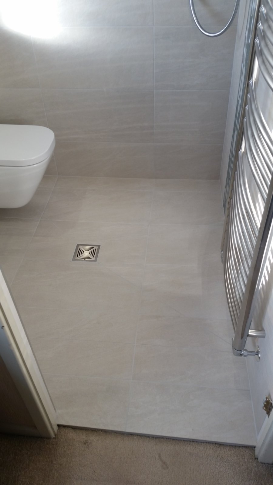

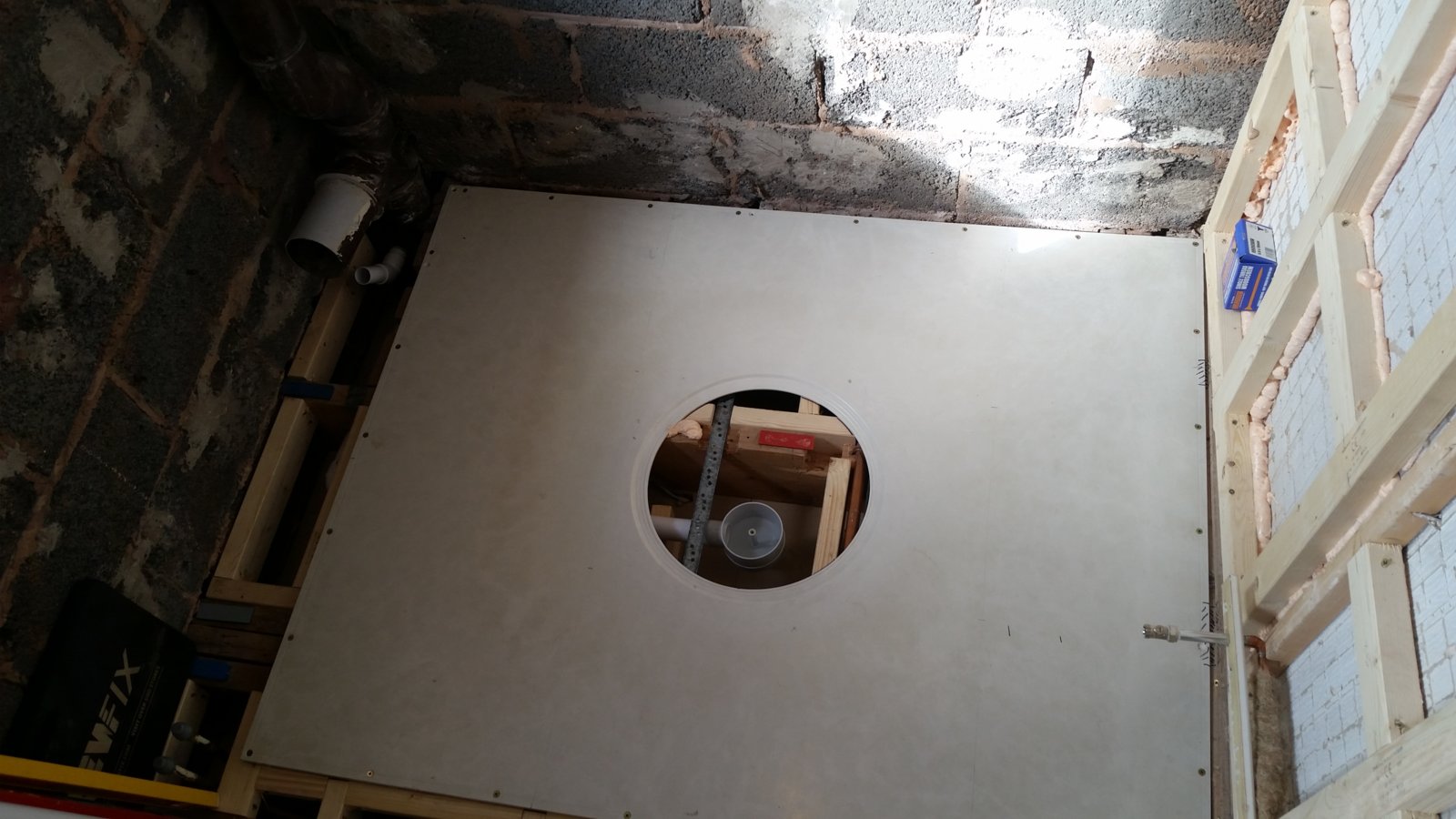

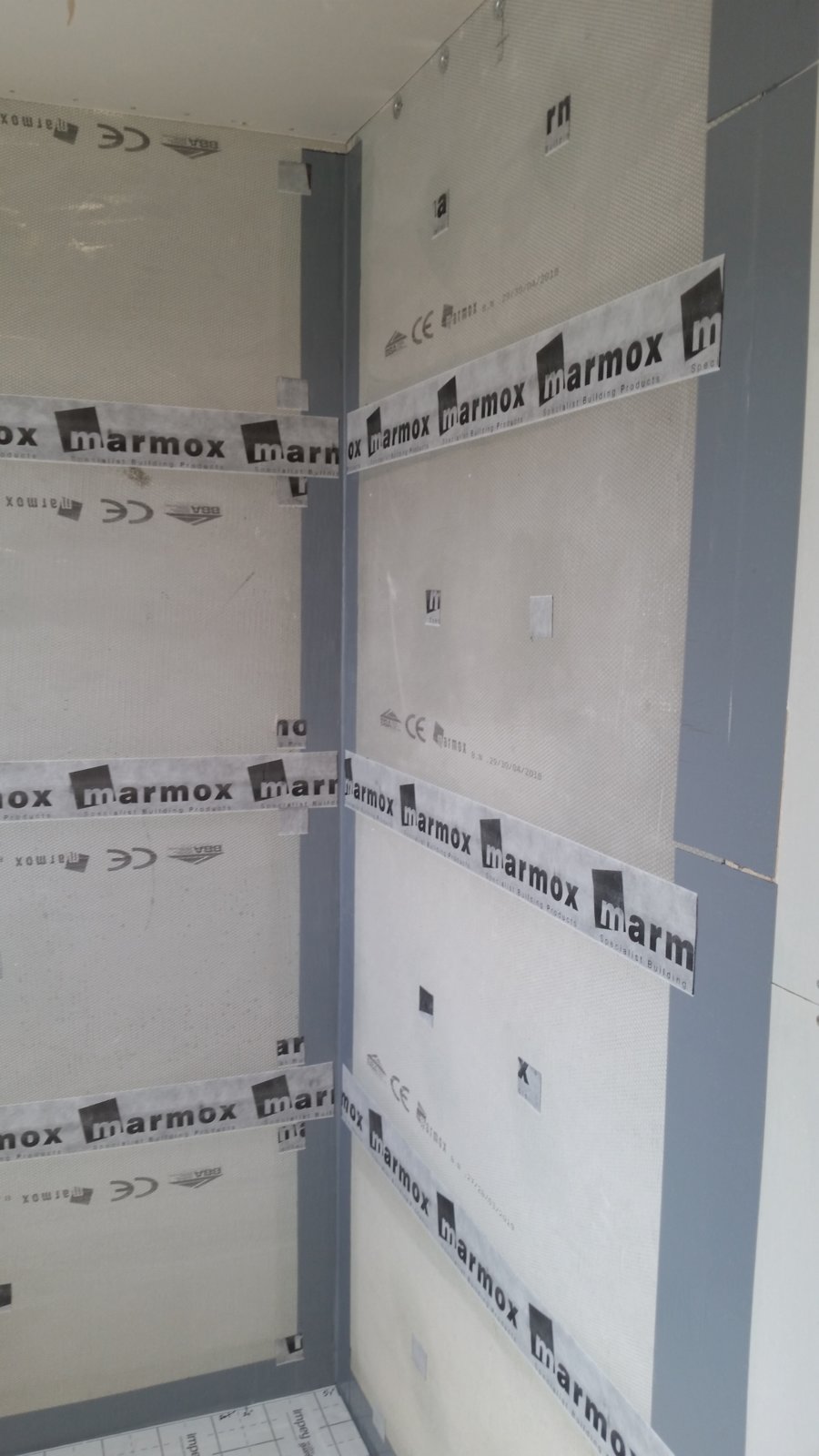

That wet room former was the Impey Aqua Dec easyfit along with the Waterguard tanking kit. In my opinion they are one of the best out there. The former is 22mm thick, has an adjustable waste to avoid joists, they don't require any form of underboarding and will take up to about 300kg. With wet rooms I also replace the surrounding floor with 22mm No More Ply so the transition between floor and tray is solid and seamless.
