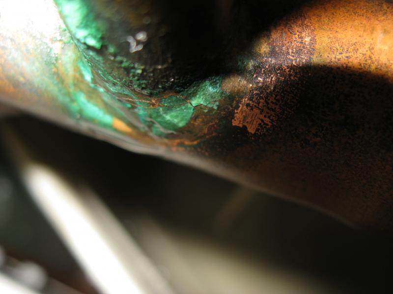

So I thought it was probably due to an air lock as there are quite a lot of horizontal pipes in the loft. I refitted the pump and tested the pipework for leaks. Unfortunately there was a leak (I think I must have bent the pipework in the process and/or the pipework was really old and had corroded).
