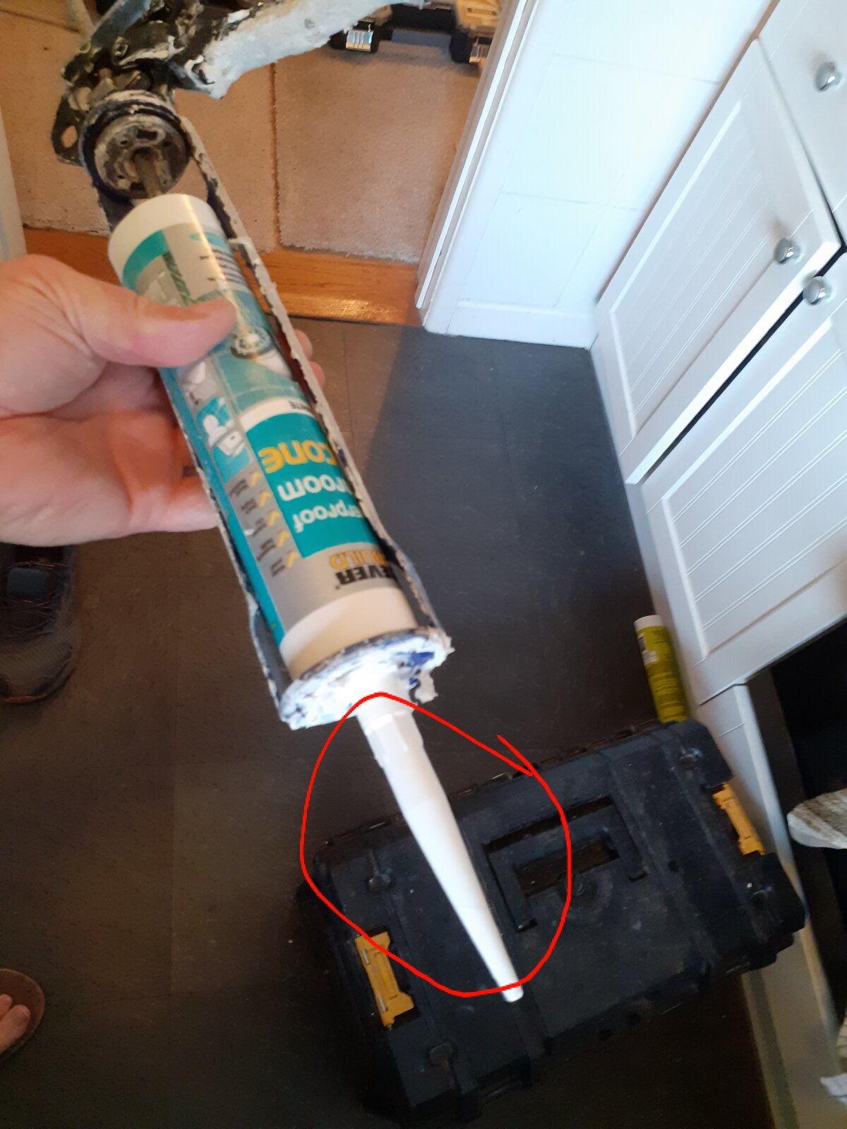

If I haven't used silicon and maybe caulk for awhile in same container it often blocks in nozel. The rest is ok. U guys buy spare nozzles?

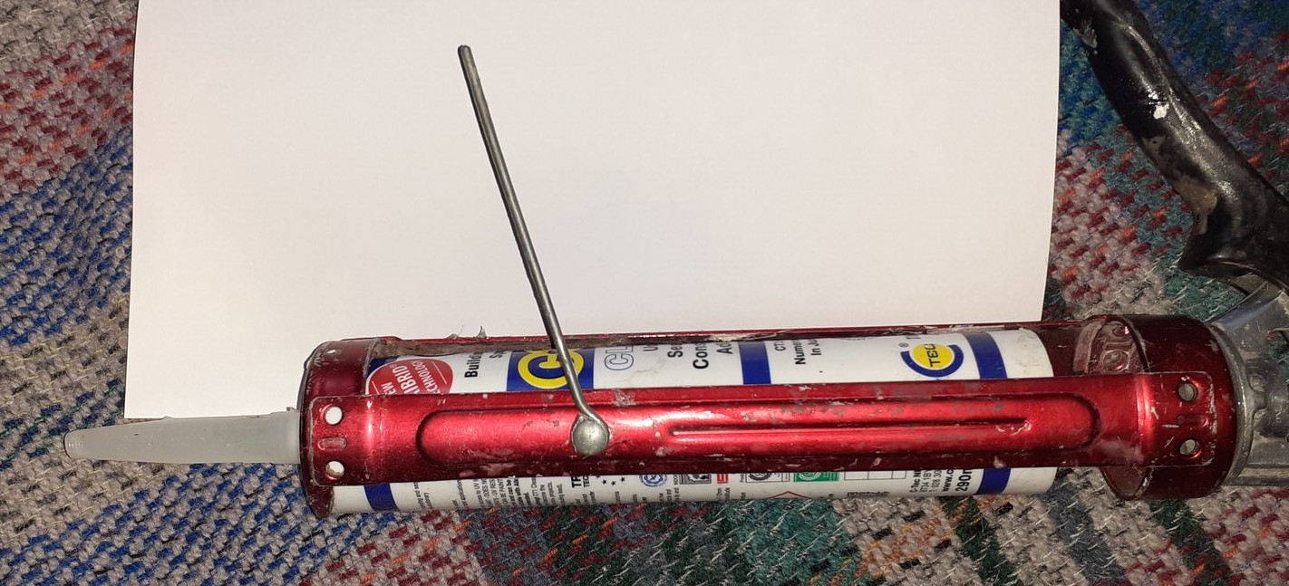

Several solutions. First: when you are using multiple tubes on a job, transfer the nozzle from tube to tube as you go rather than putting a fresh nozzle on every tube, leaves you with spares. Second: get some of those silicone rubber nozzle tips that keep the air out or buy silicone which comes with end caps. Third: get a few of the nozzles which can be angled, making some jobs easier - they generally come with a cap to seal them between uses. Fourth: buy a better quality caulking gun which had a "hole poker" on the side to poke through blockages - this is my Tajima, there are other makes with them:

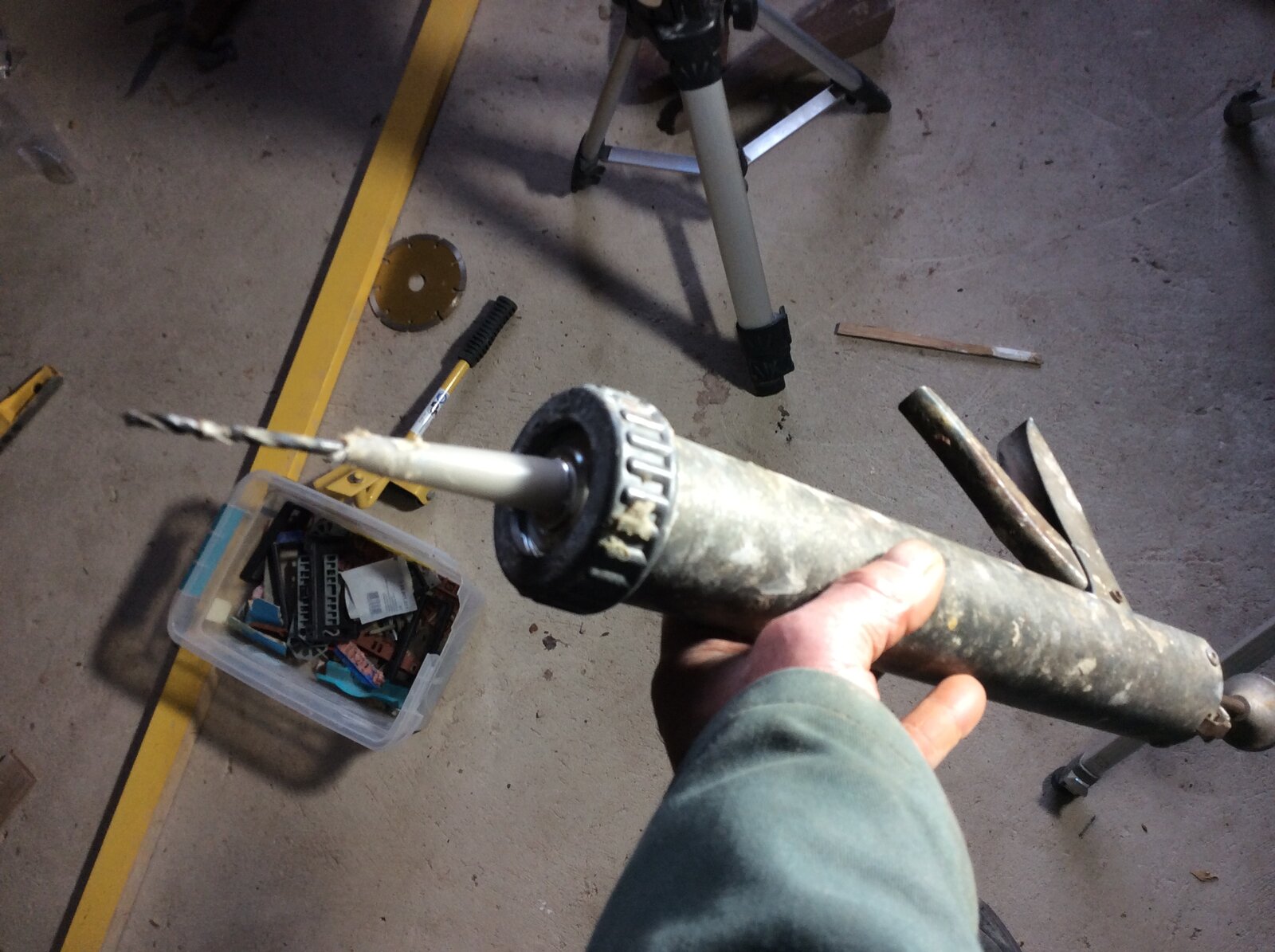

Yep, spare nozzles or sometimes use a screw in the open end.
Screws don't always go deep enough, I find - the 'ole poker does :D

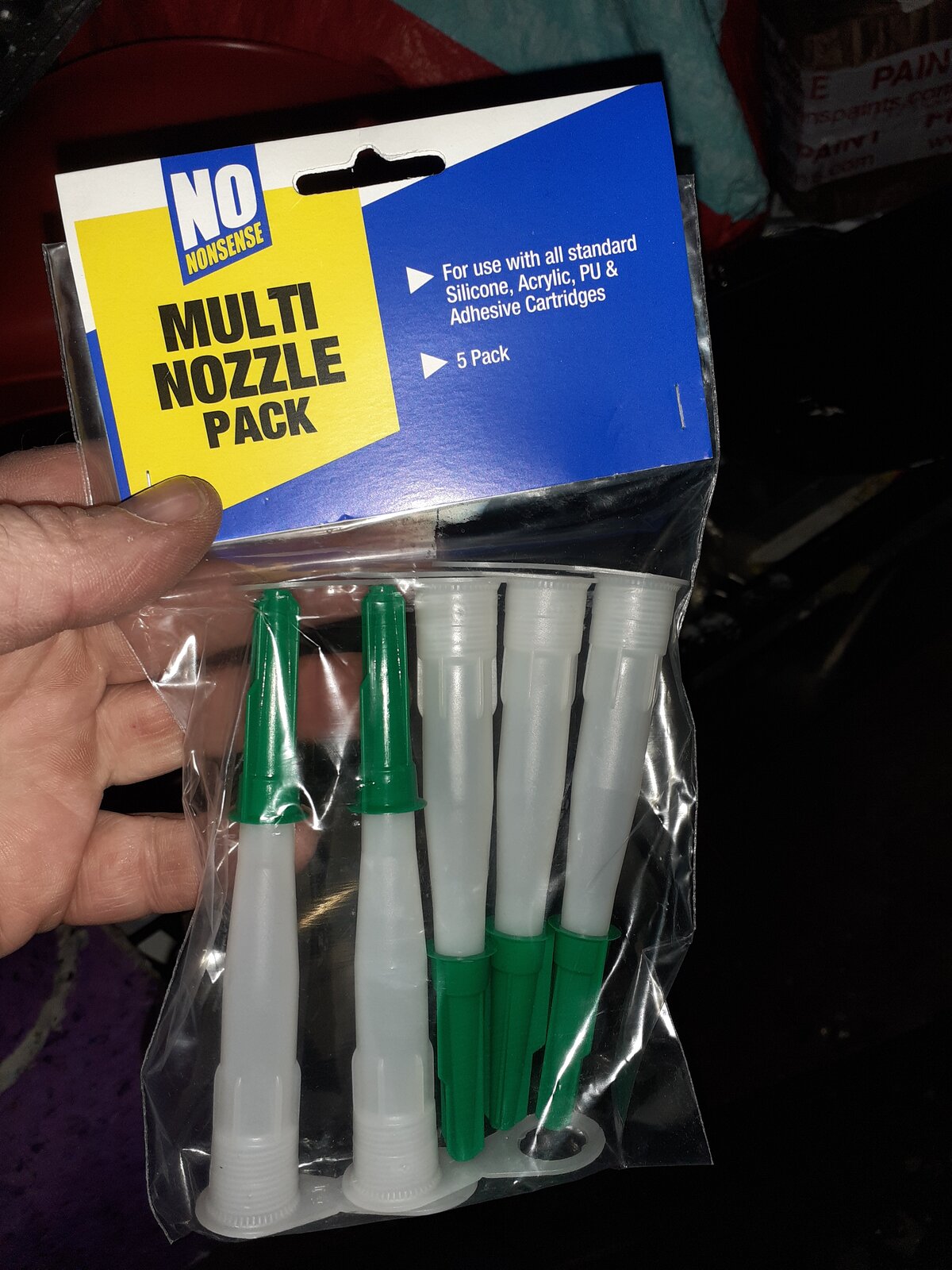

I recently purchased 100 spare nozzles for about £12 on ebay. That works out to 12 pence each. Way cheaper than trying to unblock a nozzle.

What's an 'ole poker'?
The poker in question is the thin tube in job'n'knock's mastic gun image.
Give that man a cokernutter! Yes, that folding bit of wire, fixed on the side of the body, is yer actual 'ole poker

Got these-
