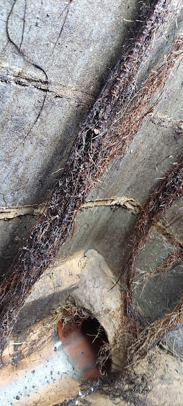

We have two toilets one upstairs, one downstairs. The downstairs toilet connects to the sewer a few feet further away from the manhole than the stack from the upstairs toilet.
The upstairs toilet works fine, and when flushed we can see a good flow through the manhole. The downstairs toilet fills with water after a couple of flushes and slowly drains away, and we only see a trickle of water through the manhole. Tried buckets of soapy water, plunger, mop wrapped in a bag, and a concertina plunger but couldn't sort it.
Called Dyno-Rod and after he saw the flows of water, diagnosed roots blocking the sewer between the stack connection and the manhole. I couldn't see why the roots would stop the downstairs toilet but not the upstairs, but he said it was because the roots were on the left hand/house side of the sewer pipe. He didn't have a sewer camera. In the picture below obviously there is a small bit of root growth. He said jetting would be ineffective and recommended root-cutting for a few hundred quid.
Our downstairs toilet is in the middle of the house 2.5 metres from the sewer, it takes only a couple of flushes for the pan to fill up, so there must be a chance that the blockage is before the sewer, no?
I suggested that he just jet down the downstairs toilet anyway, but he said that wouldn't work. He then suggested a camera up the sewer as an option, but that would be a hundred quid.
It's obviously in their interests to bill me as much as possible, but my inclination is to pay to jet the downstairs toilet and see how that goes.
Any thoughts on all this from the experts.
We have rods with a plunger on the end would it be worth pushing this up the drain?
Also I've seen drain cameras on Amazon for about £25. Worth buying here, or not?
Thanks in advance.

We don't call them Dyno Rob in the sewer game for nothing. I'd tell them to take a hike, and see if you can do something yourself first.
Ground Floor WC can be directly connected to the drain, so there wont be a Stack or AAV. Common practice, so don't waste your time looking for something that isn't there! I do wish people wouldn't comment when they don't know what they're talking about.
Does the lateral from this WC connect into the main run at the Manhole, so you can access it? I'd hold off with the Camera for now, it's probably only going to tell you what you already know, and wont unblock the pipe.
If you can rod from the Manhole, then you may be able to break through enough to get the downstairs WC flowing, just using the corkscrew attachment on the end of some rods, You need to keep turning them clockwise anyway to ensure they don't come apart in the drain, feed them up the affected pipe, and they should wind into anything that's in the way, pull back and remove arisings as required. This will probably alos indicate the presence of roots, and you can then plan the next stage.
It may benefit from being Jetted with a 'Warthog' or similar, or use of a Root Cutter, but this will only buy you time, the roots will be back. Long term solution would be to either look at getting the pipe lined, to seal up any cracks or broken joints where the roots are getting in, or depending on depth and access, excavate and replace the affected section of drain.

@dannynolan Do you know exactly how/where the upstairs loo soil stack and downstairs loo soil pipe tee into each other? I assume your photo is a sewer inspection chamber downstream and if both empty out of that one pipe, you'd hope that the builders put a small access chamber upstream where the tee is. That is certainly the case at our house both front and back.

Many thanks for that, much appreciated, we are out today. We had the pipes replaced 12 years ago, and will post pictures of the exact layout this evening.
