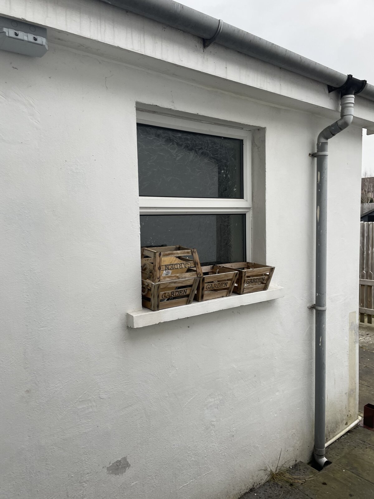

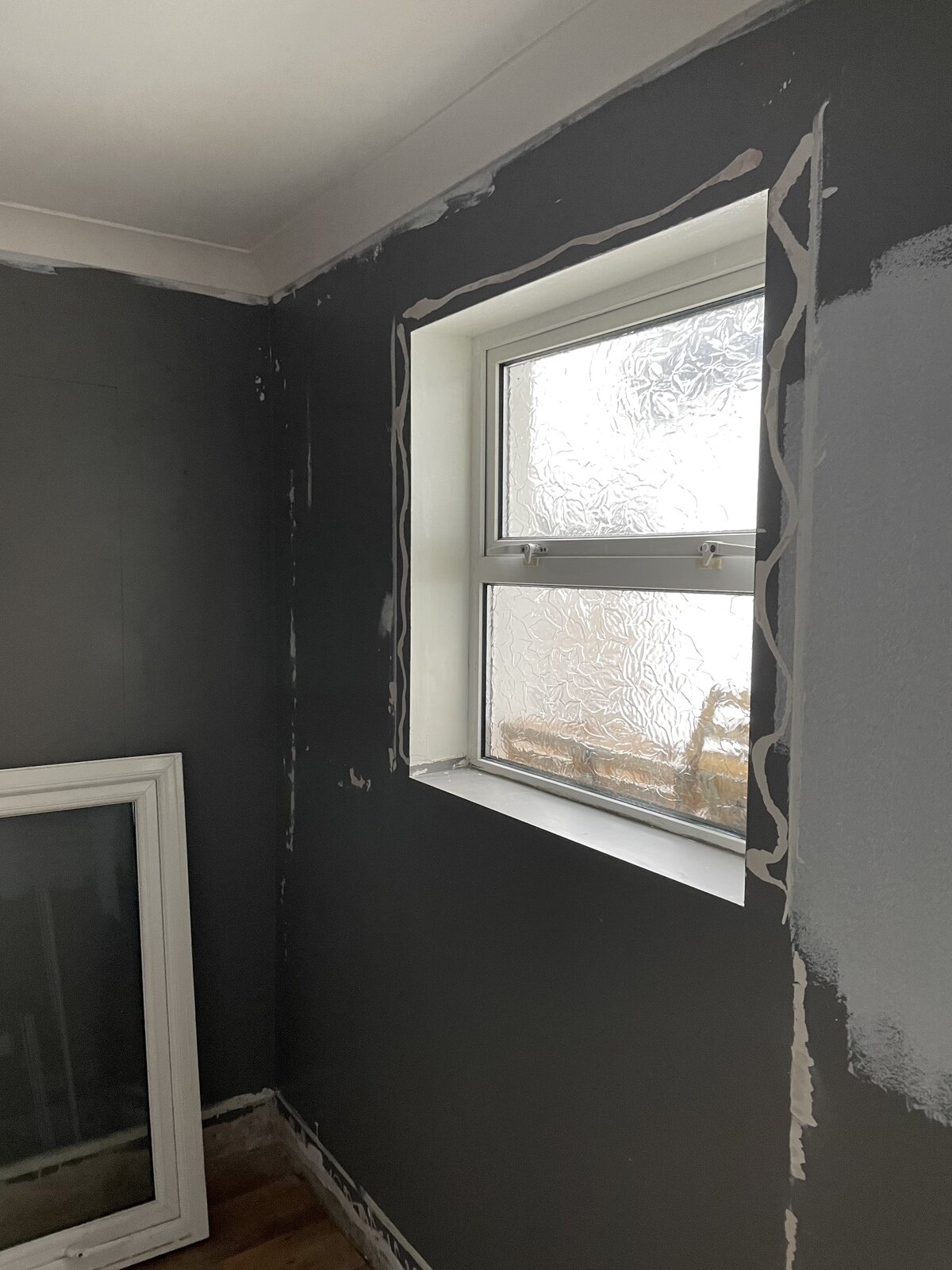

Hello. This little room was once a bathroom and has a frosted glasses window. I am getting a clear pane window fitted on the back wall to let some nice light in and look into the garden. Wall space is at a premium so would like to block this window up and was wondering the best way to go about it? Would also like the outside blocked as well. Any tips would be great. Thanks in advance.

Take the window and window board out and fill the outside with brick or block to match the existing outer skin, block in with same material as inner skin on the inside, render (?) outside to match, dot and dab inside and skim with plaster to match
