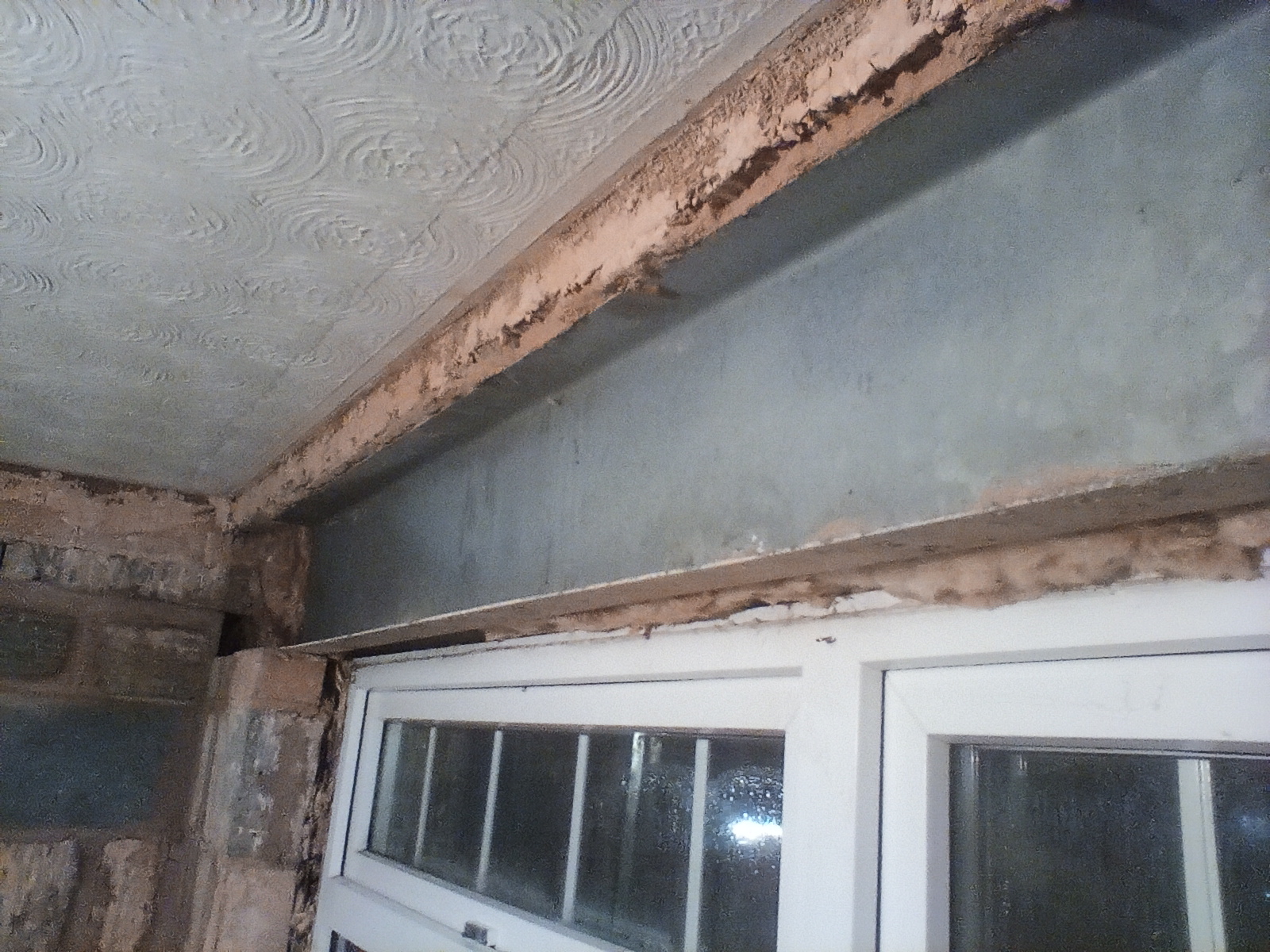

Hi there ...... here's one for the builders out there.
I,m currently refurbing an inner block wall, and have now reached up to the steel lintel, on the window wall, where all of the blocks were extremely loose., particularly within the lintel.
These have all been removed and the lintel cleaned up, ready for block replacement ...... the originals, had only got a thin bed of mortar on the lower face.
Should I cut them, so that they can be mortared, both top and bottom- as well as the sides- or just the bottom and butted, up to the inner top of the lintel.
The concrete/breeze blocks are 75mm thick
Just a thin smear on the bottom will do to help align them vertically.
