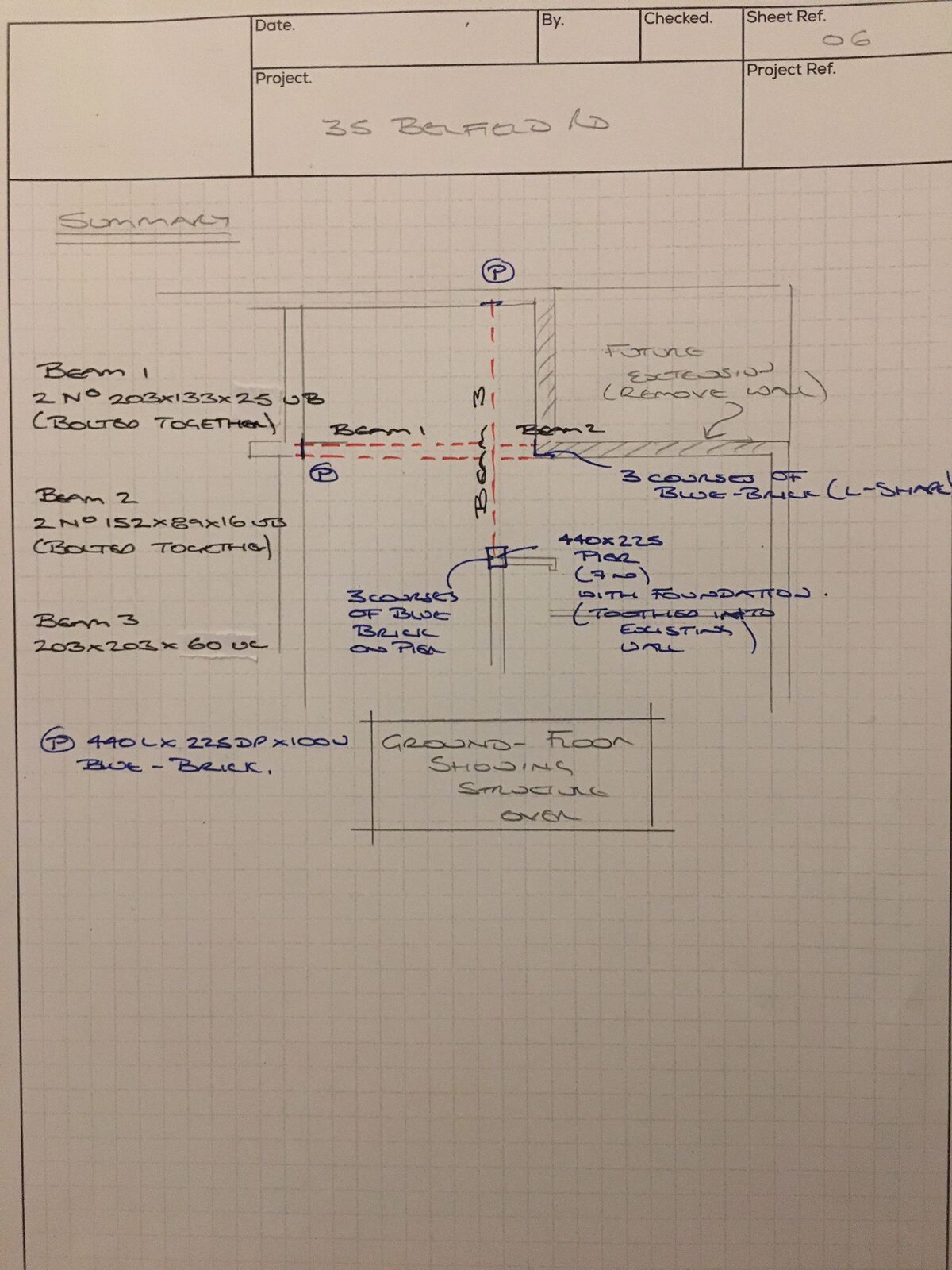

I have had calculations done for three beams.
One UC with two UB’s bolting to it perpendicular from each side (see attached)

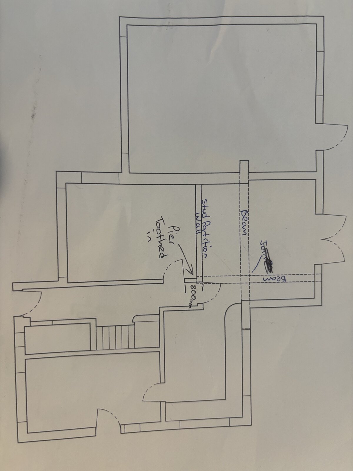

I need to build blockwork piers under each end of beam and tooth them into existing walls.
One of the piers I need to tooth in will be very close to a doorway which might not leave many bricks left to tooth in. It might as well be a stand alone pier. At the very top of the door way there’ll be more room to tooth in and they will be three courses of blue brick under the beam. Could I tie in somehow instead of toothing in which will probably leave about 400mm worth of brick still attached to the doorway?
The three beams have been designed to future proof a later extension which will eventually open up the top right corner space for an open plan kitchen/diner
Hopefully someone can make sense of my words and pictures and any advice would be greatly appreciated.
Thanks in advance
