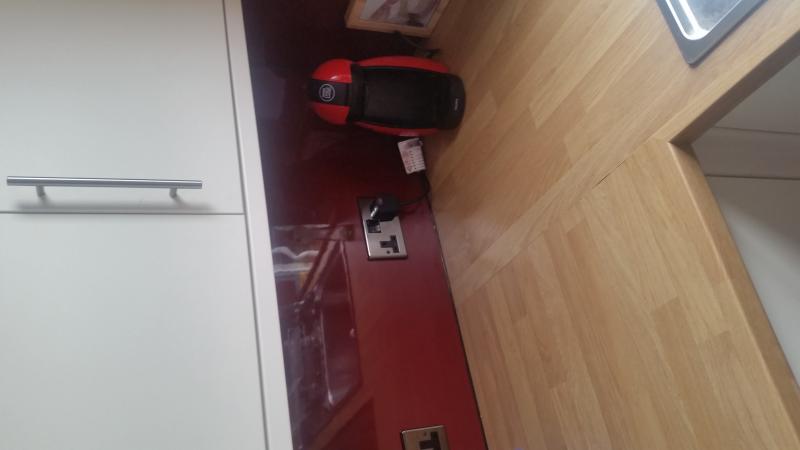

Hi I'm new to this so any help would be really appreciated, I needed a new kitchen installing as I'm going to rent my property I went to howdens for a quote fell in love with the kitchen and bought it cash.
I used a joiner with over 20 years experience in fitting kitchens the kitchen looked fantastic when finished. Around ten days after completion we noticed the joint near the sink had bubbled quite badly.
I rang the suplier straight away they sent an engineer out to look at the problem, I told them you can clearly see that my joiner had used the correct jointing components suplied by you.
The joiner is saying it's a faulty product and the supplier is asking for the work top to be sent to their head office for inspection.
We have a 20 week old baby we can't live without worktops until this issue is resloved.
We just need it sorting don't know what to as taking the worktop off would mean taking all the splash backs off the wall units the sink and hob out, its a disaster really.
My question is firstly could it be my joiner who's at fault?? and if both parties won't admit liability where do I stand?? I've pain over
5k for this kitchen and I feel robbed.
Should I get trading standards involved or just let it play out for a while?
Thanks in advance
Daz
Pictures please!

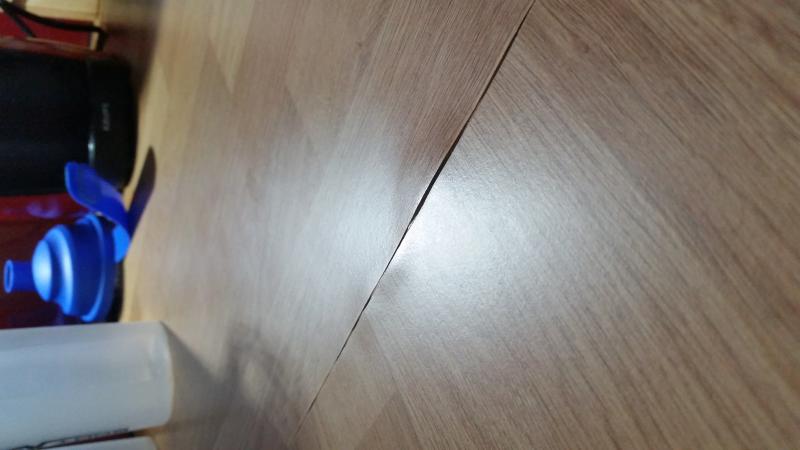

As you'll be aware, bubbling at the joint is 99% due to water ingress, but after ten days - well even that's unusual, indicating there's been no sealing at all.
John :)

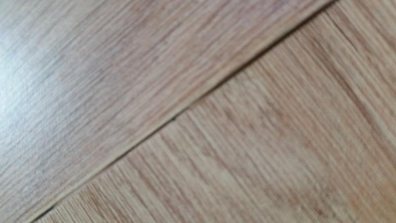

I'm not saying the joiner didn't use any jointing compound, but it isnt visible to me.....and the damage isn't recoverable. It sure looks like water has entered the join causing the chipboard beneath to swell.
Either way I'm afraid this is going to be most tiresome for you, as no one will admit any defect until the worktop has been examined.
I can't offer any comfort - maybe the joiner could fix you up with a temporary replacement so you can at least use the hob and sink.
John :)

I'd put £500 on the joiner didn't seal it properly, either way there is no way to repair it so as mentioned above it will have to come out. It's never good having a joint near a sink no matter how fastidious you are though it can't be avoided sometimes.
Even if the fitter hasn't used any form of sealant, I wouldn't expect the surface to peel off within ten days, not unless someone has been constantly flooding the area with water. Is that a routed joint or a butted joint?

The joints are routed, you can see the joint compound if you look at it you can't reallt see on images.

I'd put a further £500 with Freddy, but lets hope the laminate hadn't bonded for some reason.....therefore the supplier becomes liable.
It looks butted up to me, but I cant see it very well.

No one will accept responsibility for that. The manufacturer will just say badly sealed joint close to wet area.
The fitter will say bad quality worktop.
Btw there was a previous one on here a while back about a similar problem and hubby blamed his wife for setting steaming kettle lids on the joint.
If it was mine I'd run it out with the router and set in an inlay piece of the same material glued with water proof pva.
