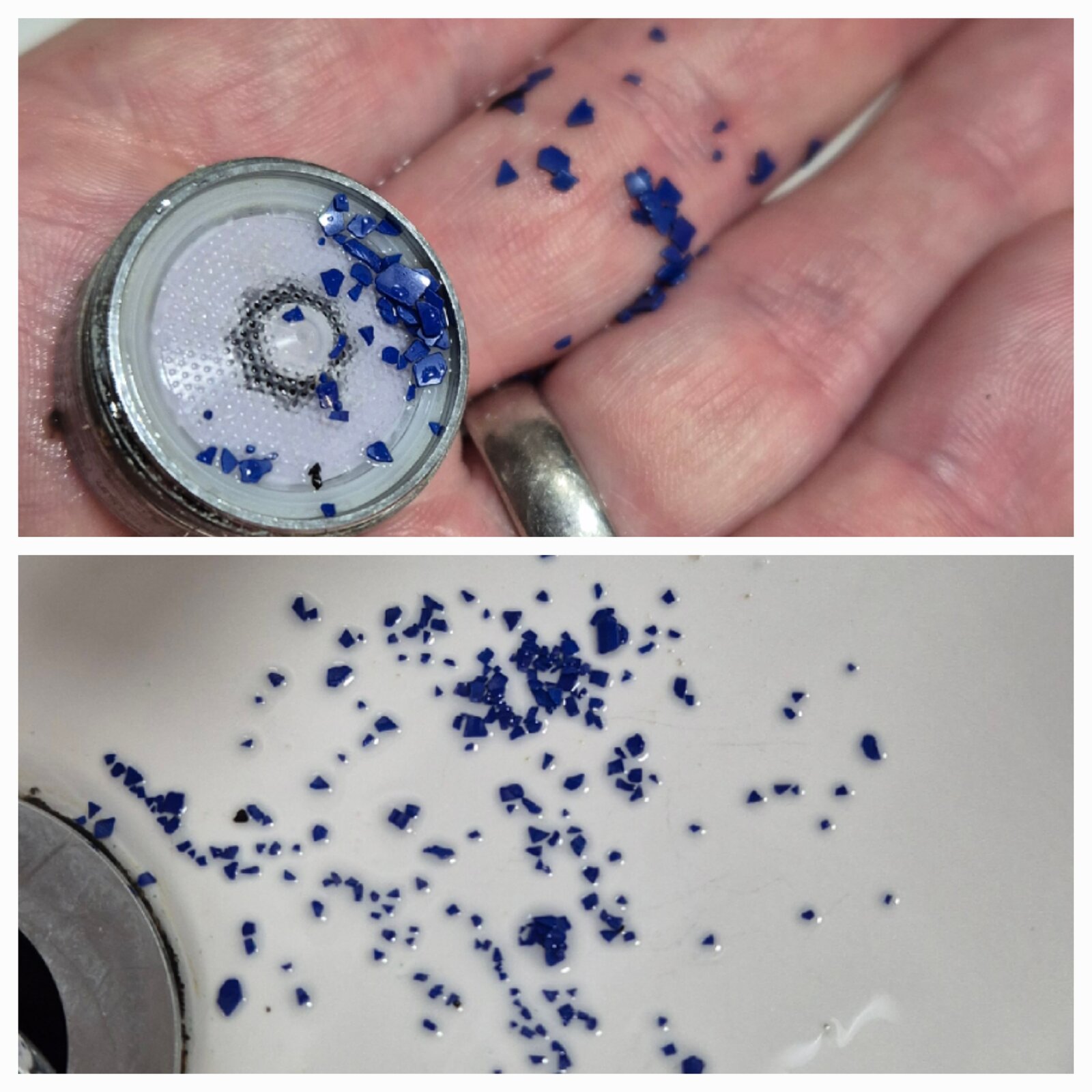

Blue plastic pieces in water?
8 Aug 2011
171
11
Cheshire
Keep finding these little blue bits in the water, tap strainer, dishwasher inlet filter, toilet filler. As the toilet and dishwasher are on cold feed only suspect nothing to do with the hot water. All plumping relatively new (10 years max) and mostly jg speedfit plastic. Concerned they may have fouled the thermostatic mixer on bath and showers. Any idea where they have come from, is it likely to be something in my property or from the mains water in?
Is it all cold mains?
It isn't anything, being that colour, that I would attribute to say the internals of a valve or similar. If it keeps on occurring, I'd be tempted to fit a strainer just after the cold mains, if it catches more at that point then a call to the water transporter would be in order
