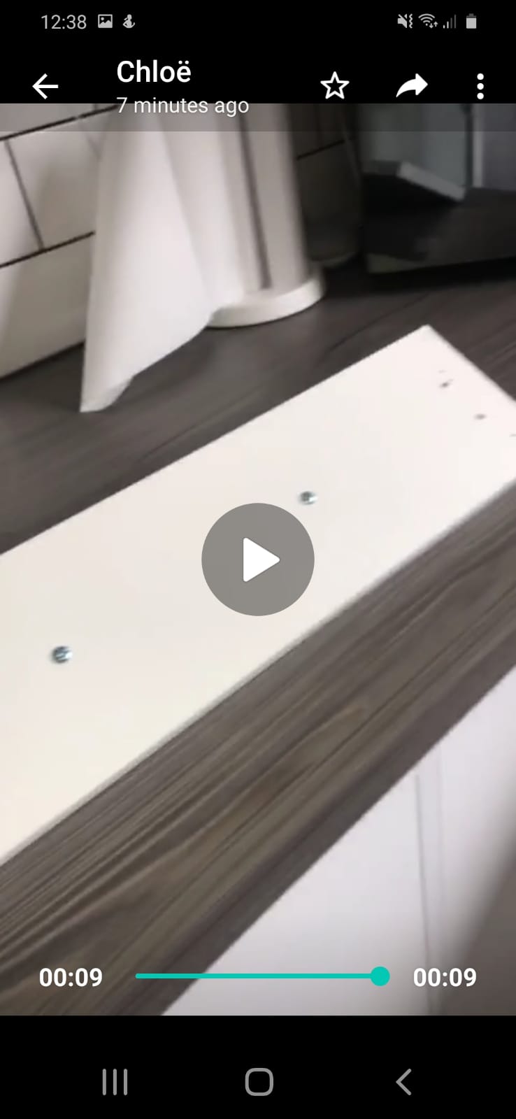

Hi, I recently fitted a magnet kitchen for my daughter, this Blum drawer front has come off, Im wondering if I can use some kind of extra strength no nails or something to glue the screws back on.
Theres a door frame preventing me from taking the drawer out, so I cant get to the release screws located at the sides of the drawer box.
thanks
p
You could screw surface white corner blocks to metal frame and draw front, though for proper job remove the base unit .
