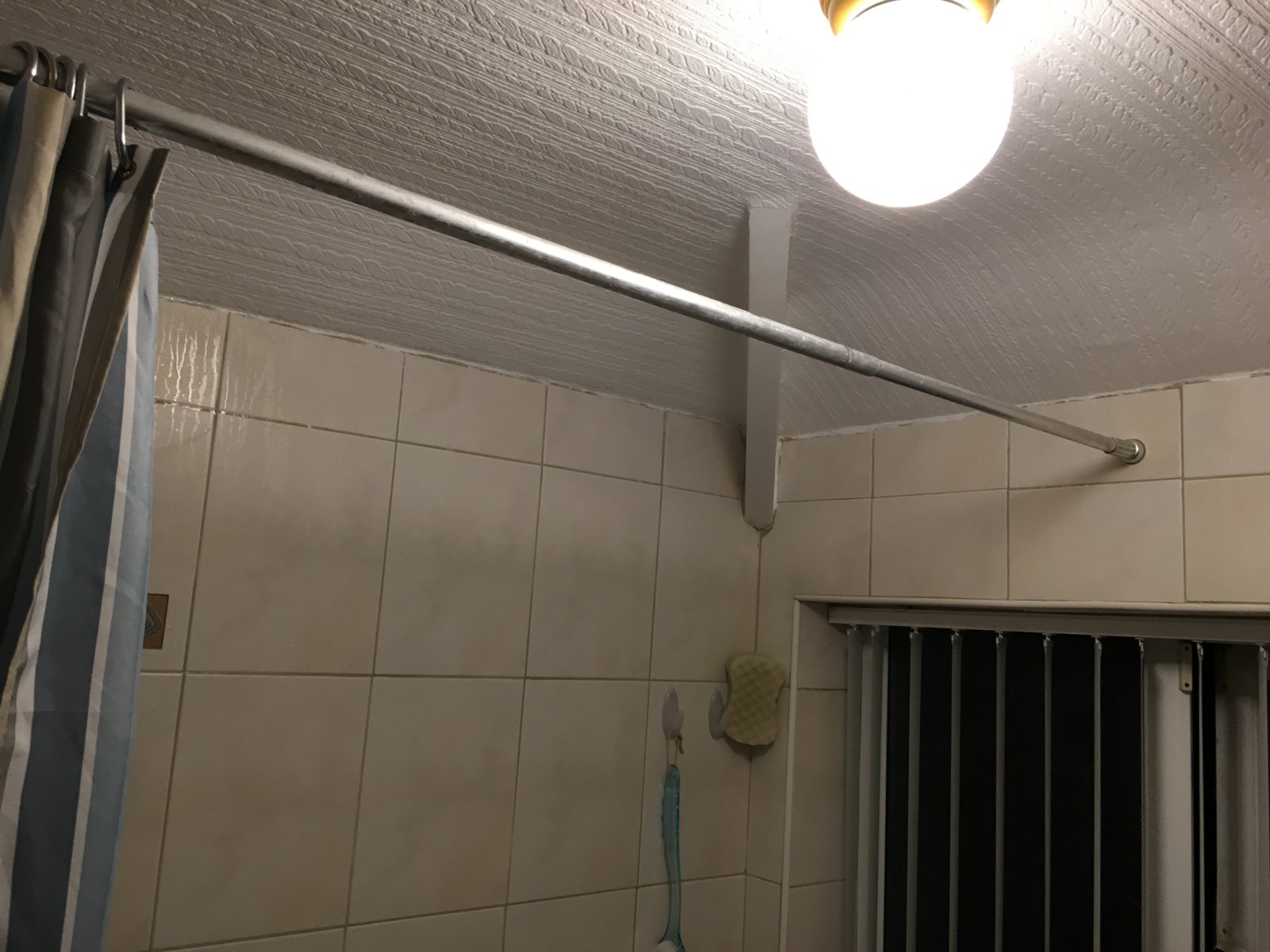

House was built in 1932. We've had some walls knocked off downstairs & those that weren't brick were plaster & lath as were the ceilings, so i'm guessing the bathroom will be no different?
The 2 walls you see in the photo will be outside walls. The main wall being the side of the house & the window wall being on to the back garden. The wall opposite the window wall is where the shower is & on the other side of that wall is the landing/stairs. When that was knocked off it was plaster & lath. The wall opposite the main wall you see in the photo will be the other side of the back bedroom. The boiler is installed in a cupboard on this wall (in the bedroom).
The 'paper' on the ceiling right now is a sort of vinyl like paper. Probably been painted 5000 times. I guess due to the heat or water it gets stained in sections. Pink above the shower which just so happens to be the same colour as the bare ceiling we saw in the living room & bedroom.
When we get it done out i'd like it boarded i think. I don't like the vinyl paper look, especially the staining so if boarding will help to remove this then all the better.
Also you see the one light in the room. If we could get downlights recessed into the ceiling then that'd be great. Not sure if this would require the whole ceiling being ripped down or not though.

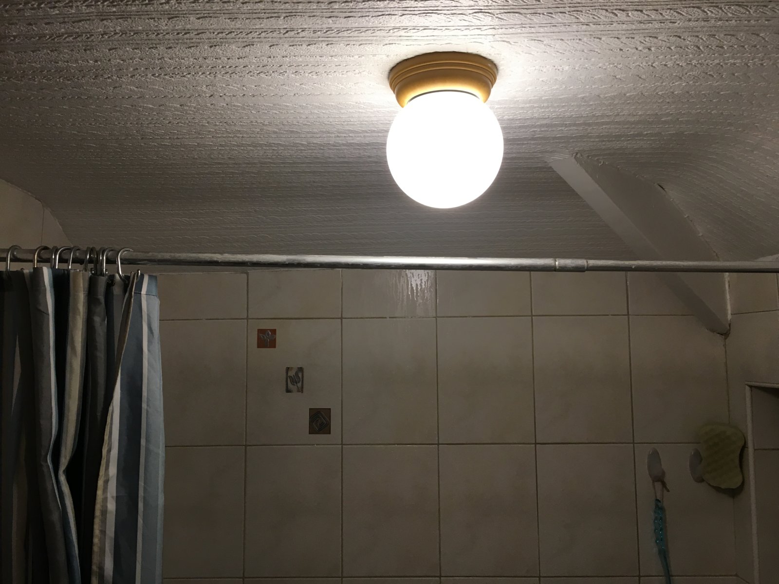

What concerns me is how you'd board it out with that curve you see in the photo

I measured from the flat of the ceiling to the start of the tiles & the drop is 150mm. The drop to where that (wooden) beam meets the tiles at the bottom would be 180mm so an extra 30mm, approximately.

You're talking about boarding the ceiling, but why can't you scrape the vinyl off with a steamer, and then paint the ceiling with an anti mould paint.
If you can't get access to the space above the ceiling, then you'd need to take it down to get the lights in, and they'd board the ceiling, and the slopes first, then they'll put some bonding on the joints to create the curve, then they'll plaster it.
But if you're getting loads of moisture on the ceiling, then it suggests you don't have an extractor in the bathroom. You'd definitely find it easier to get the fan wiring in if you take the ceiling down and reboard it, and the extractor will stop any future problems with the ceiling. And I suspect a humidistat and timer would be more sensible than a timer only fan.

I've only seen the living room ceiling & our bedroom ceiling - both were original plaster with a ton of cracks in. I'm not confident that that is the best action (having the original plaster ceiling exposed). Ideally i would like the bathroom once fully finished to look nice & modern and i don't think the original plaster ceiling will tie in with that.
You're right about the extractor - we don't have one.
When having a shower we have the window opened wide & leave it open for a while afterwards but that's about all we can do. We have a Karcher which we used afterwards to run down the walls & windows to suck up the moisture after a shower.
I've never actually been in a bathroom that has an extractor fan to be honest. My wife has & says that such as when it's windy they rattle like mad & make a right noise. Whether this is how the old fashioned ones worked & they've come a long way over the years i don't know. Are they quiet these days? Also can you close them up for when you're not using the shower so that all the heat doesn't escape?
If you get an airflow Icon, then that have a shutter built into the fan, so the wind can't get through, now the outside shutter may still rattle but you can't have everything. The trick is to determine which direction the wind comes from, and then put the fan on another wall. I forgot to add that if you take the ceiling down and reboard it, then you can add some Cellotex insulation to the slopes, and that'll help no end.
