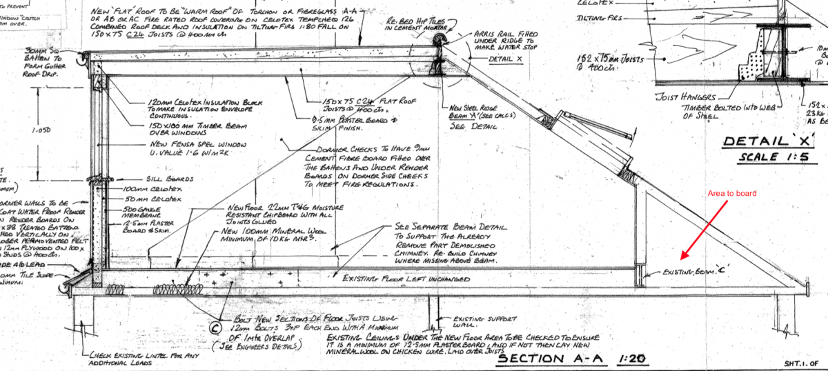

I recently moved into a terraced house with a dormer loft conversion. The house was built around 1900. At the front of the conversion there is a small void with an access hatch from the bedroom. I have attached a section of the engineering drawings from the conversion.

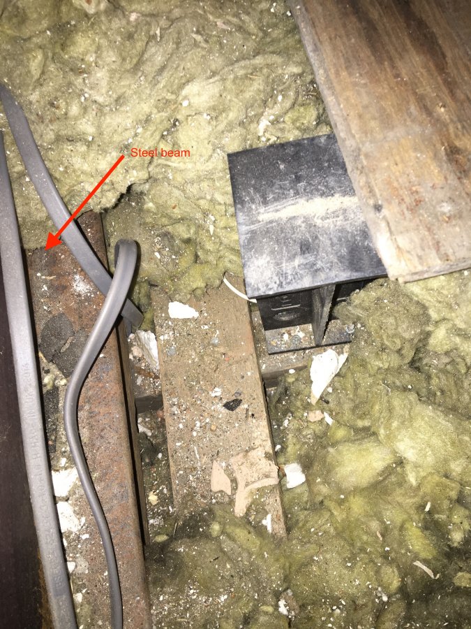

I would like to board this area in order to use it for storage, nothing too heavy. Due to the shape I would probably have to crawl into the space to be able to use it. My plan for this would be to install loft legs and use tongue and groove loft boards.
I would like to know if the joists will be sufficient for storage. The joists are 2" x 3" with a spacing of approx. 450mm. The joists do NOT appear to be attached to the steel beam (marked "C" on the drawing). However there is a 1x3'' running flat and perpendicular to the joists (parallel to the steel beam). This is nailed to the joists. I haven't been able to get to either end to the find out if this is attached to the party walls.
The maximum span is about 3.6m to the wall in the centre of the house. From what I have read this seems to be quite long for this size of joists. I am not sure if boarding this space for light storage with all of the load close to the end of the joist will be ok.

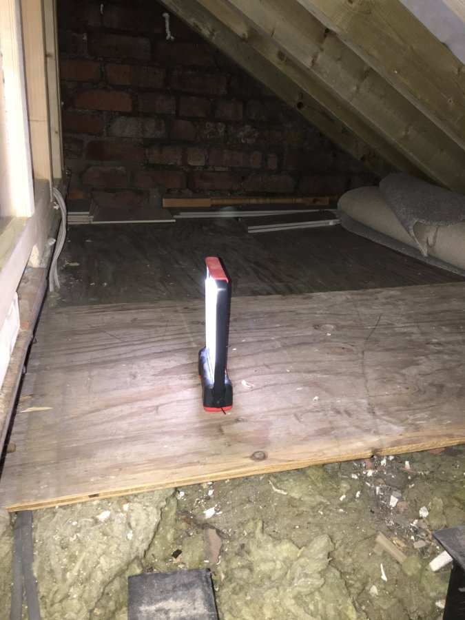

There are a few loft legs and loose ply-boards in the loft, indicating that it was once used for storage. Given the amount of debris on the insulation this may have been prior to the conversion.
