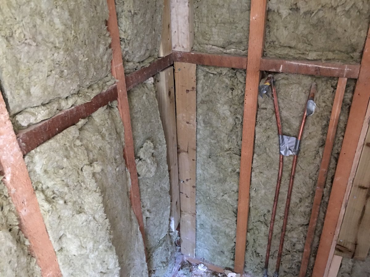

Boarding studding wall with mixer bar shower

I am boarding up a stud wall which will have a shower. From the pictures you can see the shower pipes. Do I need to add /ply or anything else before I board up? I don't want to put the cement board on yet in case I miss anything so that's why I'm asking

I'm nearly certain the plumber that did the neighbouring semi used wall plate elbows screwed to a noggin, as the pipes were going to be supporting he shower bar. I use speedfit so I definitely need wallplate elbows. Are your pipes secure enough to hold the bar?

But I think you should test them.
I put a ply board behind the tiles where I fixed my shower and riser kit. 9 years on its still there and no pressure on any pipes.
That framing is well wrong - whoever did it doesn't know what they are doing. You will waste materials if you carry on with this foolishness.

Shower units are usually centred on shower walls.
And as suggested above, end feed wall plate elbows eg. 15mm x 1/2" are screwed to backing pieces.
Whatever, the supplies must be fixed before they stub out to a bar mixer or a unit etc.
Some bar mixer kits contain their own custom elbow plates.

You seem to misunderstand what is being talked about - we are talking about fixing the stub outs onto backing in the stud bay not onto the boarded out surface.

no mis-understanding, that backing plate requires no other fixings elbows or anything else to support the mixer, or pipes.

Backing & clipping for supplies in the stud bay gives fixing height and centres, & prevents the possibility of pipe rattle.
Stubs in particular, in my plumbing world, are never left loose.

My very good boiler man (heating engineer)says it was not needed.
I asked a all rounder and he said you could put some pipe clips on ply board.
Some people said once you mount the mixer it will further support pipes.
However my bathroom fitter says I need to fitting as the pipes shake.
Given this . What do I buy for my grohe mixer.

wallplate elbows and hemp+paste on the threaded brass stubs that go into them - just done one for a family member.
