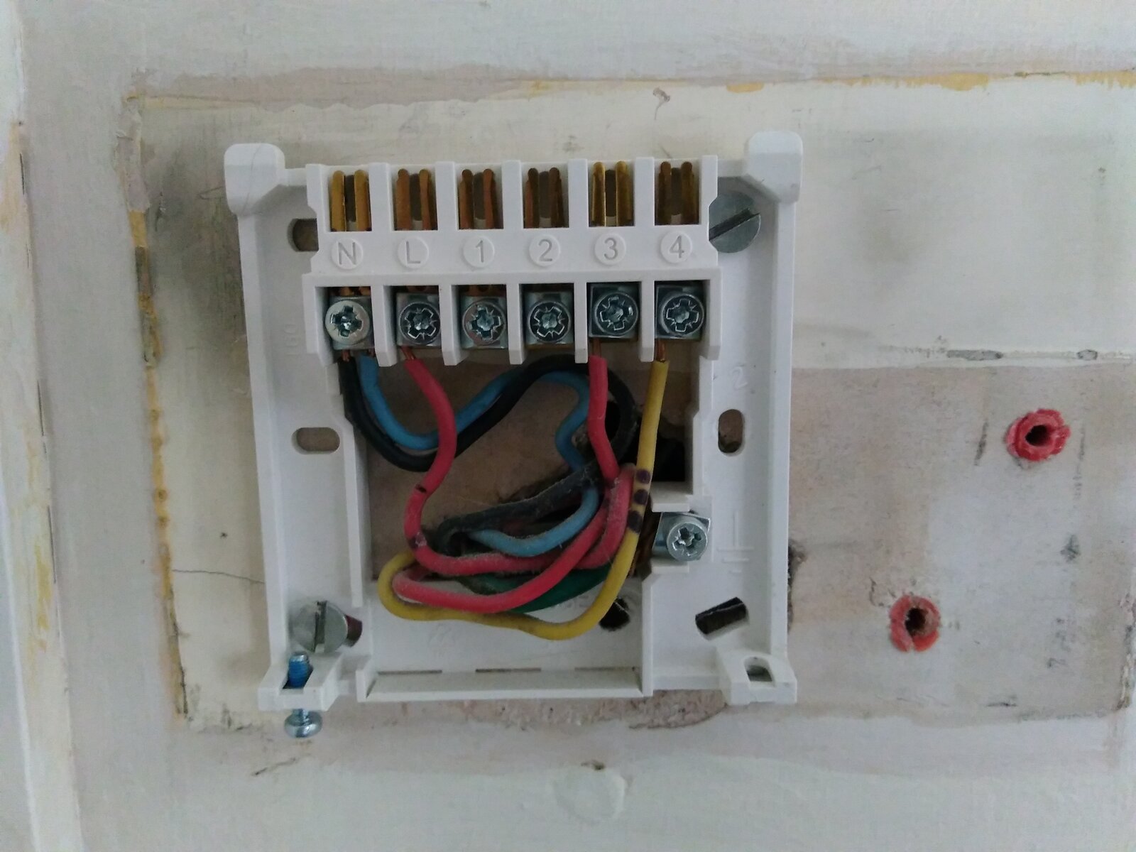

Your original room stat-2 wires? Bridge it out. Then at the backplane, CH on should connect to the pump & boiler power. HW should connect to boiler direct (assuming gravity). Pics of the original wiring would help...

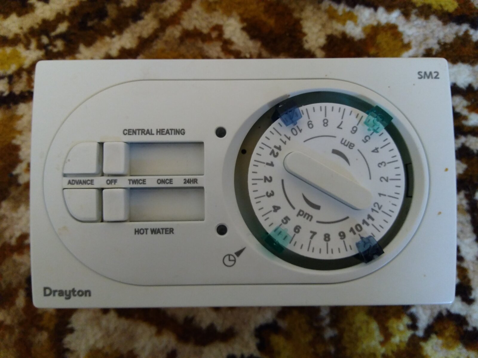

Ah yes. Your original controller will have been mechanically interlocked (so heating wouldn't/couldn't be commanded on unless hot water was on. So i'm wrong above- switched live to boiler comes from HW on, switched live to pump comes from CH on.

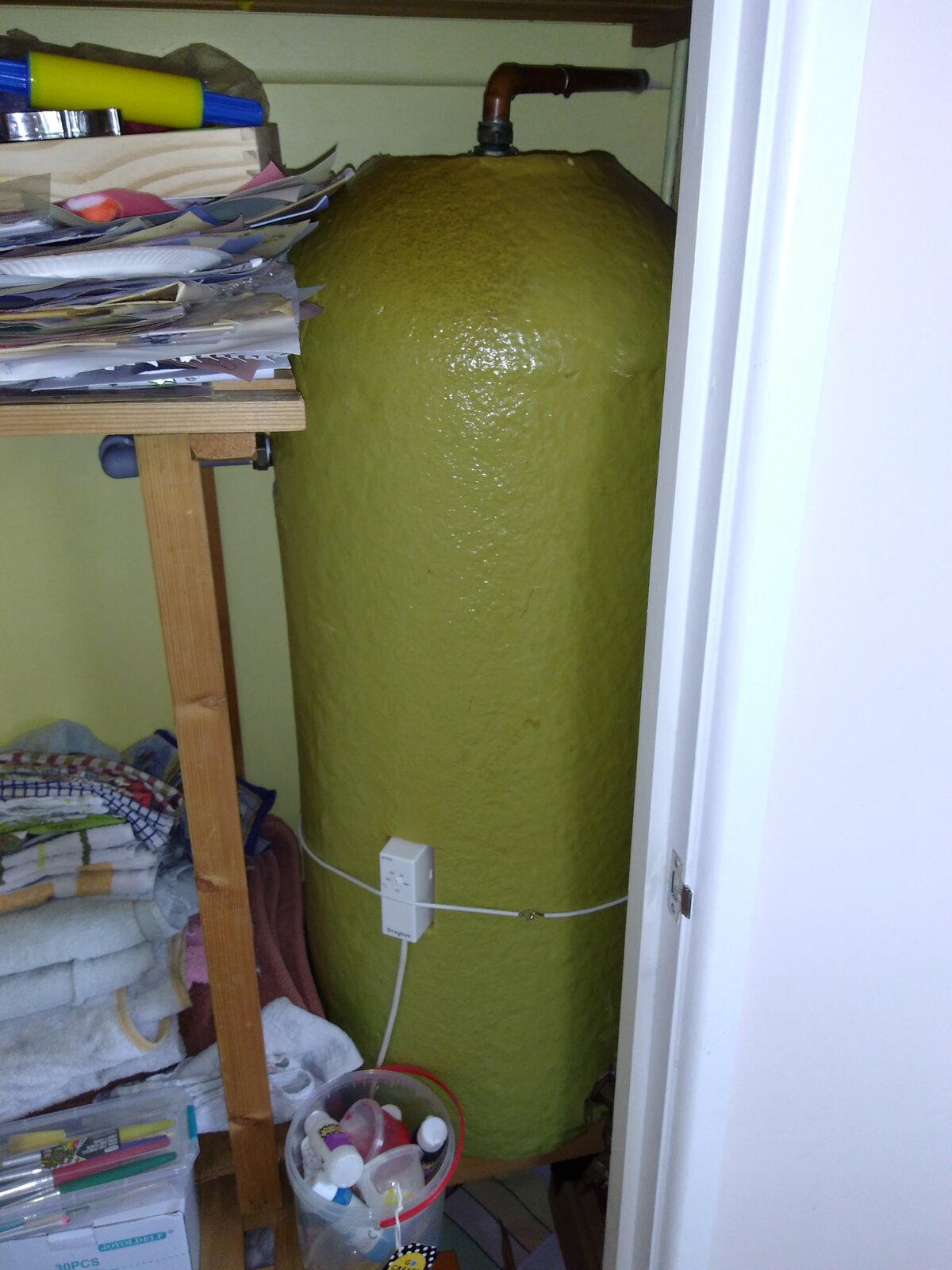

As already said sounds like you have Gravity HW, post a pic of your HW Cylinder

Here's the wall plate wiring, which I haven't made any changes to.

The original controller was an SM2.

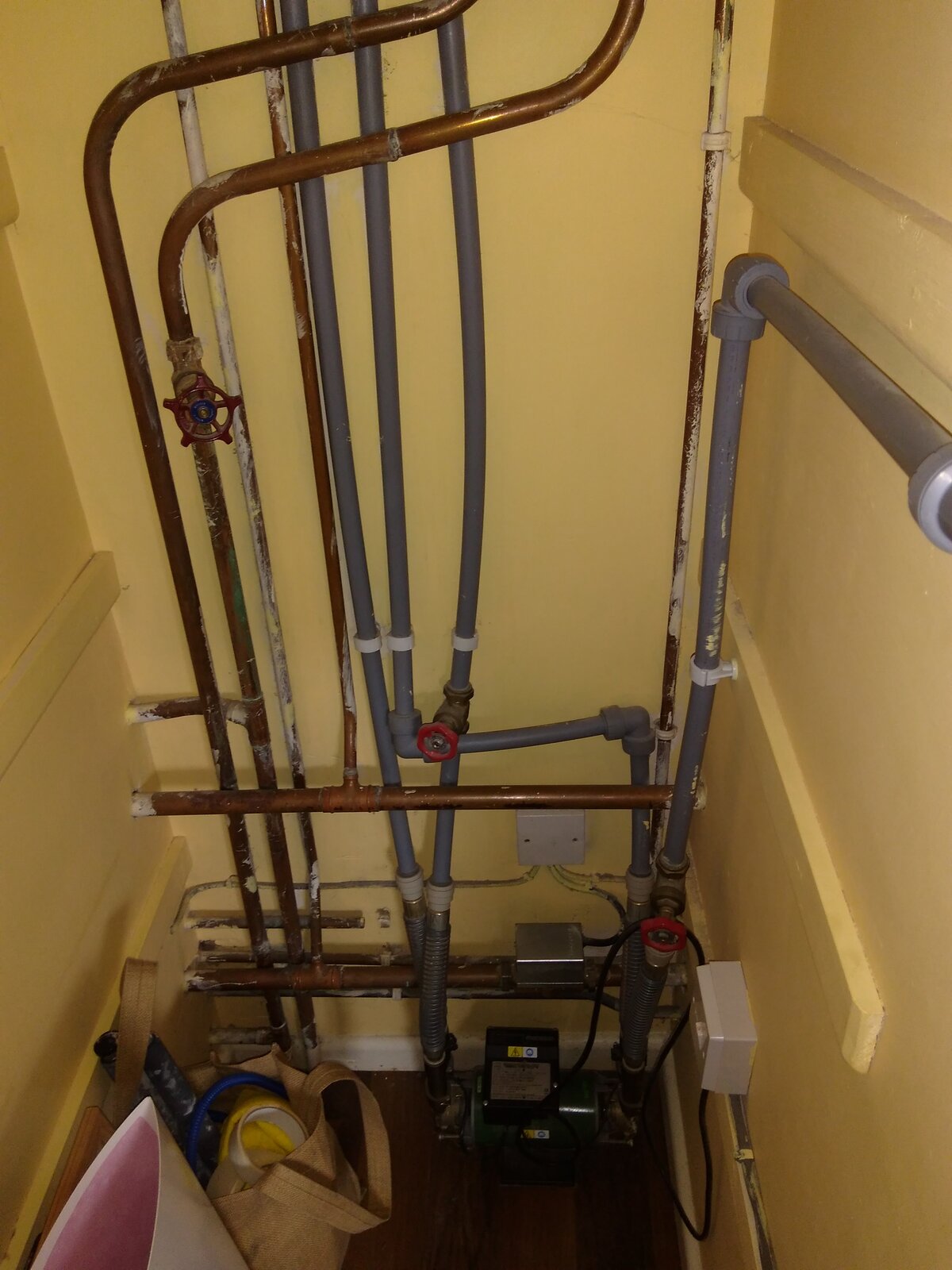

There does seem to be a motorised valve, sorry this pic is a bit dark at the bottom.
Sorry about the mess. There are no valves etc around the cylinder.

When you switched the CH on with the SM2 did the HW slider move accross at the same time ?
I admire your optimism! ;)
No, the LED would light, there would be pump-y sounds but the boiler wouldn't do anything.
This was never a problem for the previous owners (or us up to now) due to the lack any thermostat.
(I found a date, the boiler is 36 years old)
Either you moved the pins around together for timing or for manual control you'd just have to know that if you want heating you need to slide both.

Nope sorry you have gravity HW and you cant use the wiser for that, it may be possible to alter pipework and install another zone valve, not really sure what that one is doing to be honest
The way your system is wired, HW on switches the boiler on
CH on switches the pump on
on HW only the water is gravity circulated
ON CH both are on, the HW switch brings the boiler on
and the CH brings the pump on

Not really there is a little adjustment inside the old programmer that you can set so both sliders will move together if you select CH, the lazy installer has just been two lazy to set it properly
Now I look at it closely I'm not sure it's wired to anything? o_O
WHAT! :LOL: I wish I'd known that! But then again I guess that wouldn't have avoided the problem of the dodgy pins.
