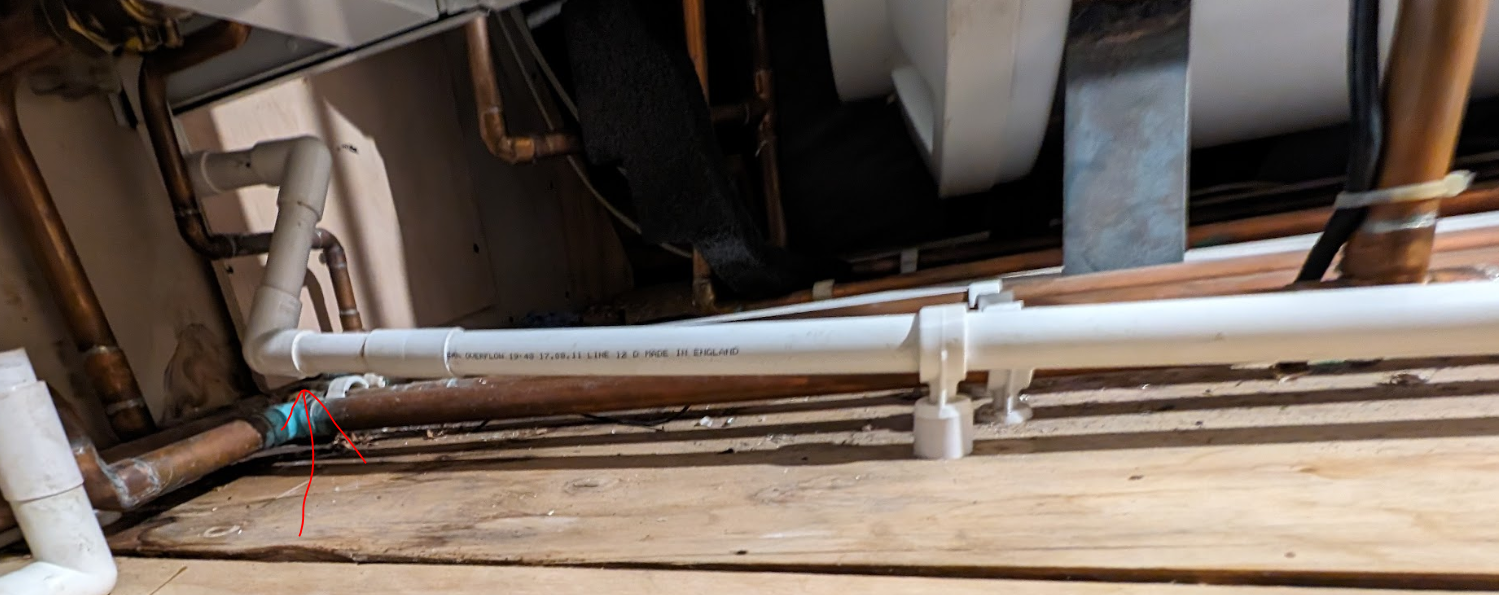

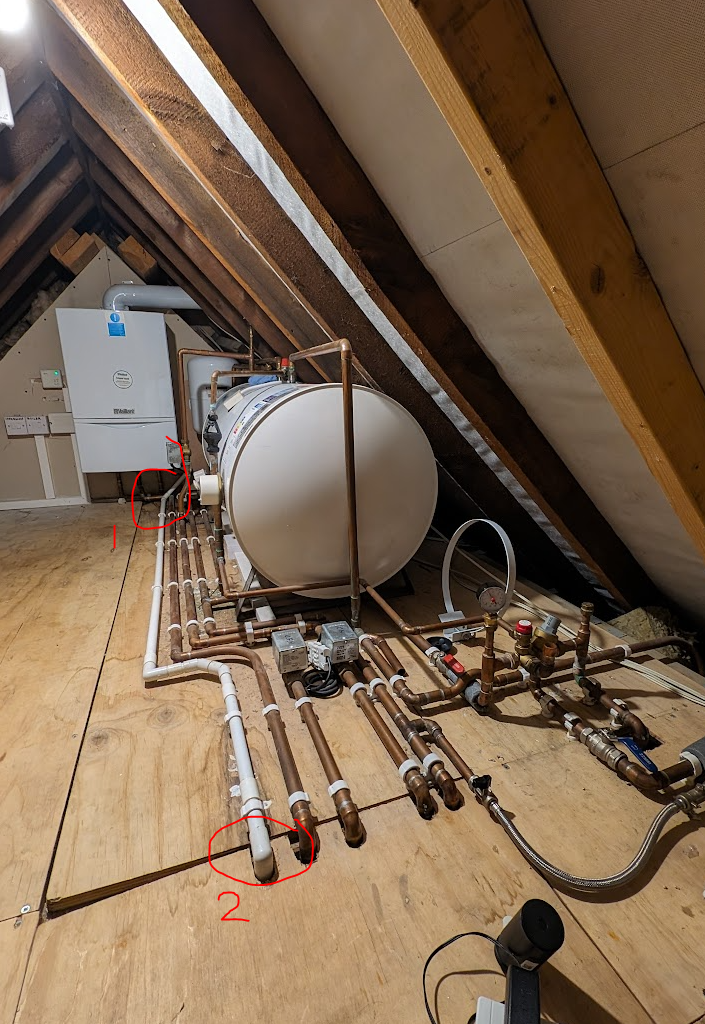

Hi,
Attaching some pics to help explain.
1. We had a leak (marked as 1) from the pipe underneath the boiler, engineer came around and lifted it to help with waterflow, solved the problem there but
2. This morning we had a leak through our first floor, looks like leak moved to point 2, we lifted the floorboard and could feel pipe wet to the joint.
3. Noticed leak water is rusty in colour as shown

If the condensate pipework is starting to leak then the run needs checked, it should all be glued so it shouldn't leak unless the fittings/pipe is starting to break down for some reason. The condensate shouldn't really be rusty water coloured either unless the main heat exchanger (HEX) has a problem, hasn't been serviced etc Is the boiler pressure still dropping? Worst case is the HEX is pin holed
The white plastic pipe is taking the condensate ( slightly acidic water) from the boiler ,which is a by product of boiler when it's in use.
The joints are ( or rather should be ) solvent welded to the pipe. If they leak ,they are either cracked or not properly solvent welded in the first place. Simple to replace.
Not directly connected to pressure loss.

As for a condi pump, looking at the height of the boiler to the exit on the floor for the pipewrk then I would suggest there is plenty of fall to be had, so a condi pump shouldn't really be needed.

There is fall but water seems to get stuck in various bends on the way down and leaks. Shouldn't happen I know but has now a few weeks apart at different points in the pipe.
I must admit though, there are more than a few excess joins in that condensate pipe, could have been run with more single pieces and lot less connections so could certainly be a lot tidier.
