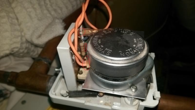

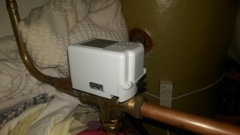

Ok, so shut down the system, ran the hot water away and took the cover off the 3 port valve.
Switched the system back on and selected hot water on the controller....the valve did not move at all..it might have already been on W...no way of telling.
Left it 30 seconds and then selected heating on the controller...the valve still did not move at all.
Its a Drayton mid position valve.
Boiler is still firing randomly between three and twenty seconds.
Dougie

Do you have mains voltage on the white and orange wires (To neutral not across them) and measured with a meter not a neon or volt stick.
I will get my meter out and check it.
The only way I can get it to fire normally is by turning the temp down on the boiler, and the water temp up on the hot water tank, and putting the 3 port valve into manual mid.
Or, that's how it was working at the weekend. I haven't tried it since I put the new pump on.
Hi

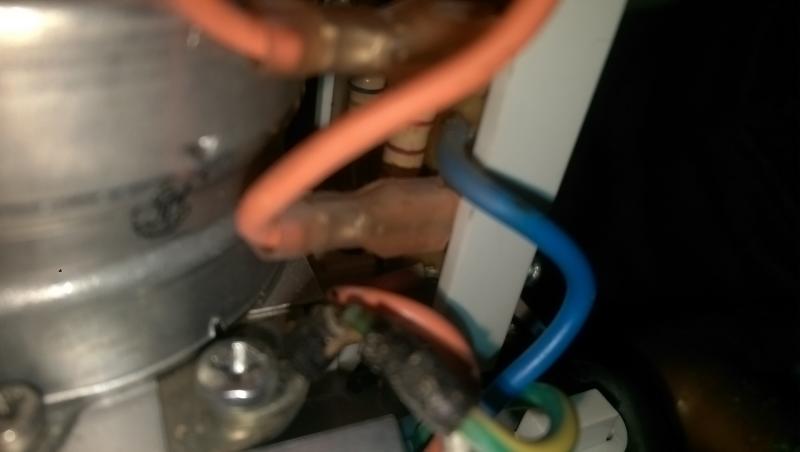

I have mains voltage going into the circuit board on both orange and white, however there is nothing coming off the board to the orange wires feeding the motor.
The orange to the board only read 240v when hot water was selected at the controller so it seems that is working ok.
I switched off hot water and orange went dead and grey was powering up
When hot water was selected I checked all three orange points, two spades on the board and the feed to the motor...nothing reading on those.
The system is now running with just heating selected, but still cycling firing every 6-10 seconds.
Thanks Terry, thought that might have been the diagnosis.
Would this be responsible for the short firing in the boiler?
Cheers
Doug
The orange wire in the actuator lead applies voltage to the boiler, which is energised when the white wire opens the valve to heating.
Using the manual lever will not operate the microswitches.
When H/W on is selected, the boiler is energised by the cyl stat.
This is why the boiler works until the cylinder is up to temperature.
