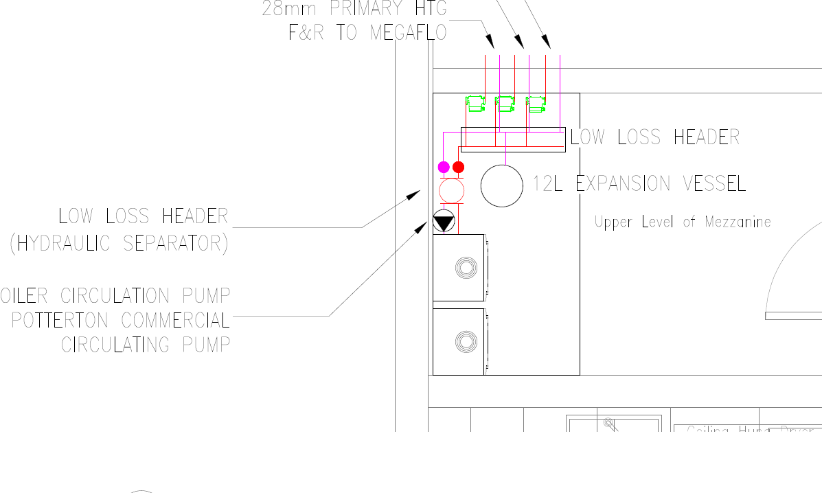

We are planning to move our boiler (registered gas safe plumber will be doing the work, not us).
I am just wanting to see peoples thoughts on the boiler flue.
I have attached a quick screenshot from the Architects plans below. We are wanting to move the boiler into the cupboard just around the corner from where it is now.
Best case scenario is to put the flue straight out the back but, it is just over 400mm from an opening window.
The boiler is an ATAG 28kw combi boiler.
From what I understand, a 28kw needs to be 600mm away from an opening window?
Is there any way that we can make this work?
Thanks!

Yeah fair point. Well I spoke to the architect today who basically just told me that he gasbag always worked to 300mm and for something like this, the plumber should be able to sort something. He did mention maybe using a plume divertor? To either go out and up or point it away from the window. Which sounds like what I linked to earlier?
He did say that the worst case scenario would be to take the flue out of the back wall but I’m really don’t want to do that
Bldg regs approved document J ,page 49 diagram 34 and table, minimum distance from edge of flue to opening window is 300mm if fan assisted balanced flue, 600mm for natural draught bal flue over 14kw. Is your boiler fan assisted balanced flue ?

Its an Atag 28 KW combi boiler , they dont do anything else other than fanned flue
