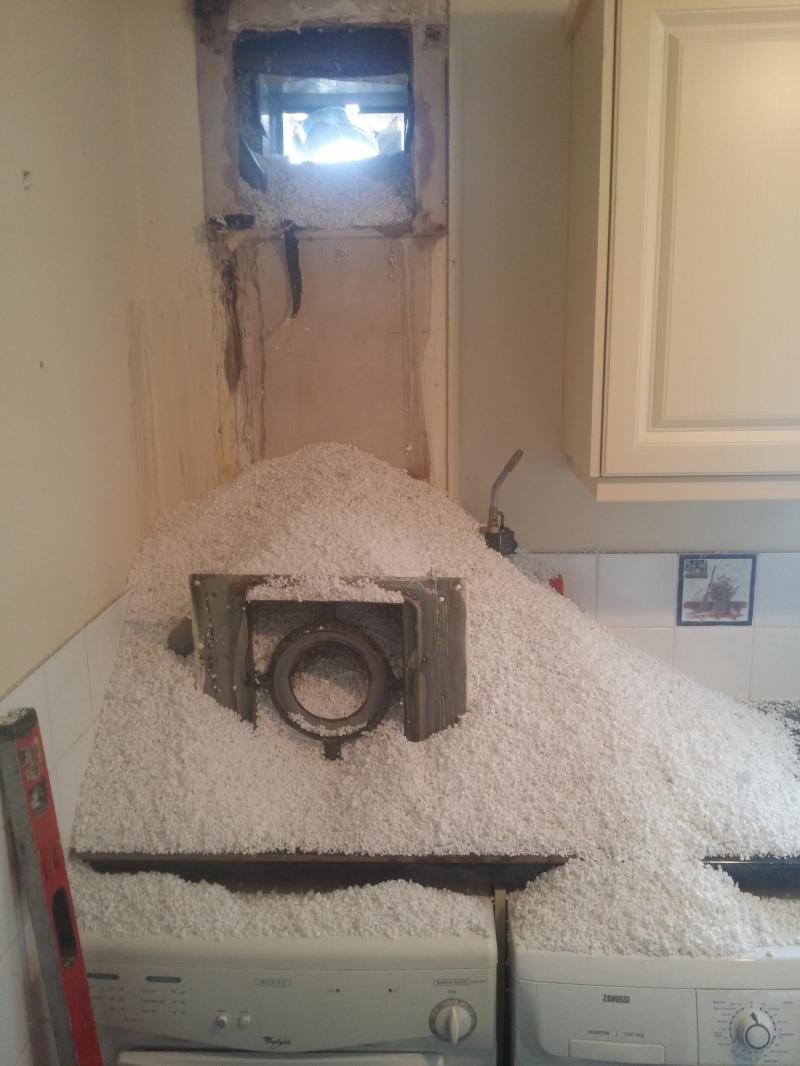

Razor I used to inspect flues after cavity wall insulation had been installed for a local company who had fecked up and drilled through a Chimney and filled it with insulation and the HSE made it a condition that a GSR had to inspect all their installations , I went to one and the new lad had forgot to fill the adhesive tank and was just blowing dry bead into the cavity you should have seen it the whole bloody street was covered, it looked like it was snowing and the house was an absolute mess with the stuff
