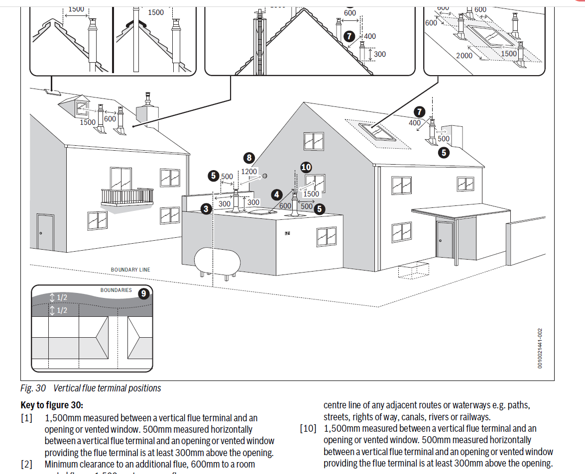

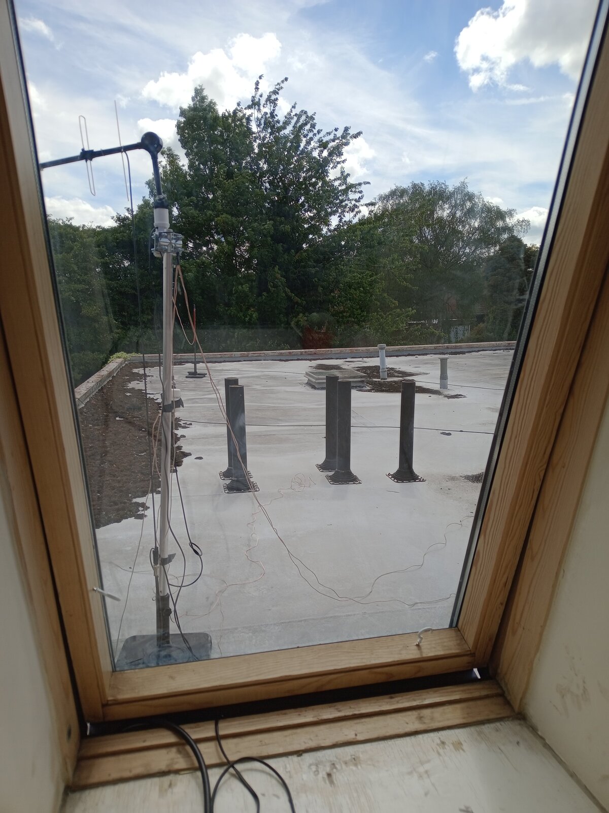

Hi i live in a sheltered accommodation flat on the first floor, my two dormer windows look out onto a flat roof and there are 3 communal boilers on the ground floor in a boiler room with 5 flues leading vertically to the flat roof, the flues are 3.5 meters from my Dormer window and the height of them is level with the bottom of my dormer window, is the height of them legal should they be higher because i have been getting headaches when i have my windows open and the white
plume is blown towards my windows, i have a co2/ co detector and its not been triggered, but i still am trying to find out if the height is legal, i enclose a picture of the flues if there is anyone who could advise me before i take it up with my housing scheme
Not sure why you’d have 3 boilers and 5 flues, something doesn’t add up. Also, as per @gas112, they don’t look like a boiler flue, as no terminal.
I have checked and they are connected to the boilers they are definatley flues, i will try to find out more info on them from scheme

However, in this case, I feel allowing access to that particular roof would be negligent on the part of the accomodation management. With the antenna so close to an unguarded roof edge & skylight plus the proximity to the flues.
My Risk Assessment would include a locked restrictor on that window.
Hi guys thanks for the reply and interest, as regards the coaxial and antennas, i am a licenced radio amateur, the coax is RG 213 mainly
the antennas are a end fed random wire with a 9 to 1 balun, the other is a home built 70cm yagi on a home built rotator, as for permissions i have permission from the scheme and also permission for access on to the flat roof, i am lucky to have a very understanding management team here, as for the radios i use a yaesu 991a as well as a yaesu 857d and operate on HF VHF and UHF bands.
