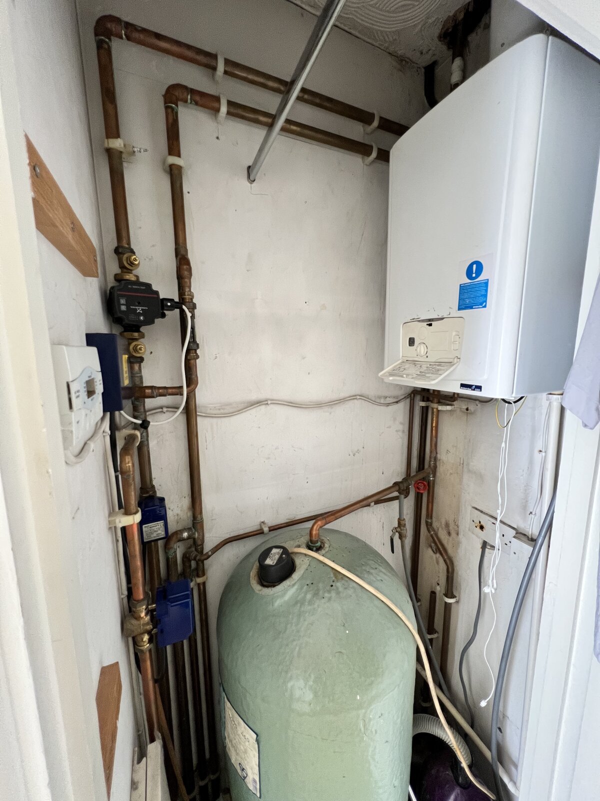

My parents have a 5 bedroom (2900 sq ft) house with 3 bathrooms. The boiler is in the original part of the house (so it is situated on one side of the house). We found several problems with the system over the years. They built a significant extension years ago and the radiators there don't heat up very well (maybe narrow pipes or not powerful enough system/pump/flow). There is very low flow (cold water 3L/min and hot 7L/min) of water in the house. I think they have called the water suppliers to try to increase this, but I also suspect that the old piping system is narrow gauge (not sure exactly what diameter). The other issue is that the immersion heater is broken and the only way to access hot water is to switch on central heating (which I don't really understand).
The heating system is an old >15 year old British Gas 330 boiler with a 140 L tank + 2.8kw immersion heater. There is a water tank in the loft.
We installed a water pump for one of the toilets and it whirrs away when hot water tap is switched on
There is another pump (not sure when it was installed) - Grundfos ups3 15-50/65 130 - in the boiler cupboard
There seems to be a huge complexity of pipes (as seen in the photo)
I'm looking to simplify the system and wondering if a combi boiler is the way to go. We don't use more than 2 hot water sources at a time. I understand that the central heating will be fine with even a reasonably low Kw rating and that hot water on-demand is the key factor to consider. After reading around, it seems like my pumps are inadequate and my water flow is too low to begin with.
With this background, is there even a point in 'upgrading' to a combi boiler with a higher Kw/flow rating (£3.5-4.5k)?
It feels outdated to have a water tank/immersion heater/ insulated tank setup, but I'm no professional!
Thanks for any advice everyone!
5 Bedroom and 3 bathrooms - a combi would not be recommended in that size of house. A combi really can't deal with more than one outlet at one time without a major impact to output. Even a high output combi can struggle depending on the cold mains supply and what the outlet outputs are.
The 330 is a rebadged Glowworm Flexicom - a basic budget box, if it is performing correctly, is nice and clean and tidy and has been serviced etc then no real need to replace.
An open vented system isn't outdated, it is old and trusted tech. A whole house pump placed at the bottom of the cylinder could deal with the hot water delivery issue. Cold water requires a better look and a better idea of what the mains can deliver (dynamic flow and pressure) and what the distribution pipework within the house is like. If the mains can support it then an unvented HW system may be a solution.
Central Heating requirements - basic check - size up all the radiators as far as their output is concerned and see what the total output is. If the current boiler has a 30Kw input then it suggests, if it has been sized correctly, that there is a significant radiator load.
You really need an experienced pro in to perform a whole house survey. Only so much can be suggested though an online forum.

The cold flow problem will be down to those cold outlets being fed from the large cistern in the attic, there should be one tap, usually the kitchen tap, that is mains connected and that would usually have a higher output.
The Grundfos pump is for the central heating, not for the hot or cold water supply.
Not sure what you mean by minimising the costs with an open vent system? Running costs really isn't a factor, against an alternative sealed system.
The HW cylinder would always be heated by the central heating, it's much more cost effective than using the electric immersion element, the immersion heater is only there as a backup if the CH fails. The CH should be timed to heat the HW cylinder at certain times of the day and would be set by usage.
The extensions radiators need to be balanced.
