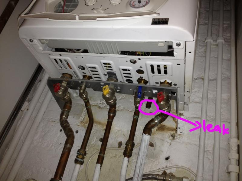

Hi,
I have a problem with my boiler. It is a Heat Line s24 compact.
When it is turned to the highest setting it starts to leak from the valve I circled in the photo. When it is on low or medium heat setting it is ok.
I never had this problem before and I am leaving the country in 3 days and renting the place out for 3 months so want to ensure there are no problems with the heating.
I did some reading and saw that this is normal when the boiler is on the highest setting, but I am not sure if I should believe it.
Any ideas?
Many thanks
Tuli

Hi,
Thanks for your reply!
The engineer was here about 3 weeks ago for the safety check but I did not notice the problem as it was summer and did not have the heating on for a few months, perhaps it did not exist then...
Is it something I could fix myself or do I need to get an engineer again before I leave?
Many thanks
T
Needs expansion vessel pressure checking, probably safety valve replacing AND the safety valve pipe plumbing to terminate outside.
It's a another Heatline bodge job...you might want to check they bothered to connect the flue despite having the recent LGSR( that was clearly iffy).
