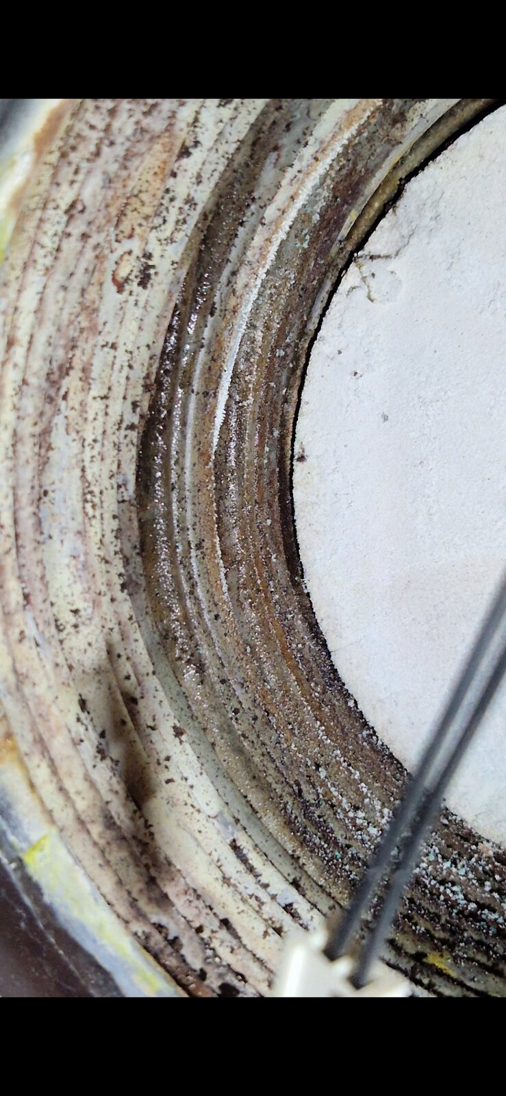

picture of a leaking heat exchanger in vailant ecotec.
Eventually he will have to open to confirm if it's leaking or not.
