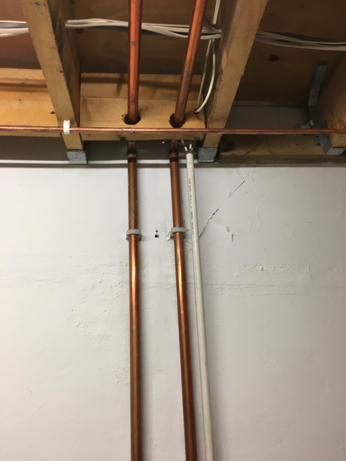

Hi my boiler is in the garage l, do I need to insulate the pipes, do I insulate hot and cold pipes also what’s a good type of insulation to use thank you

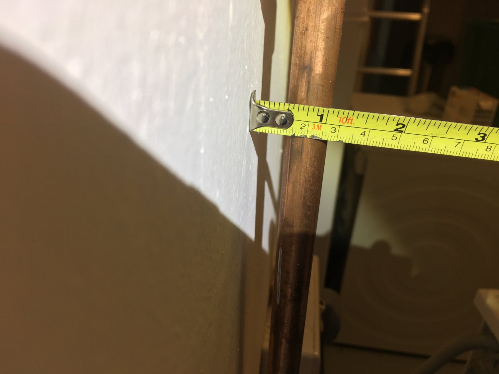

Yes, insulation would be a good idea although there's not space to get much on there where the pipes are clipped to the wall. You'll need to find the distance between the back of the pipe and the wall in order to determine what thickness insulation to buy for there. Where the pipes pass overhead, go for 19mm thick (or even 25mm thick)

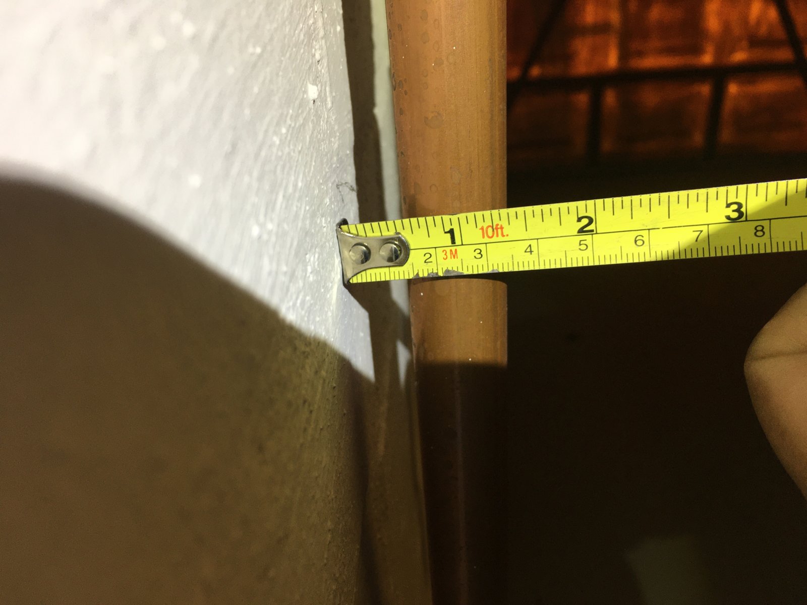

Thanks for the advice muggles looks like I’ve got about 12-13 mm space from wall to pipe also is the any good type of insulation and should I use insulation tape to join the pieces, also which type of insulation is good? Should I put the red insulation blanket on the boiler? Thanks

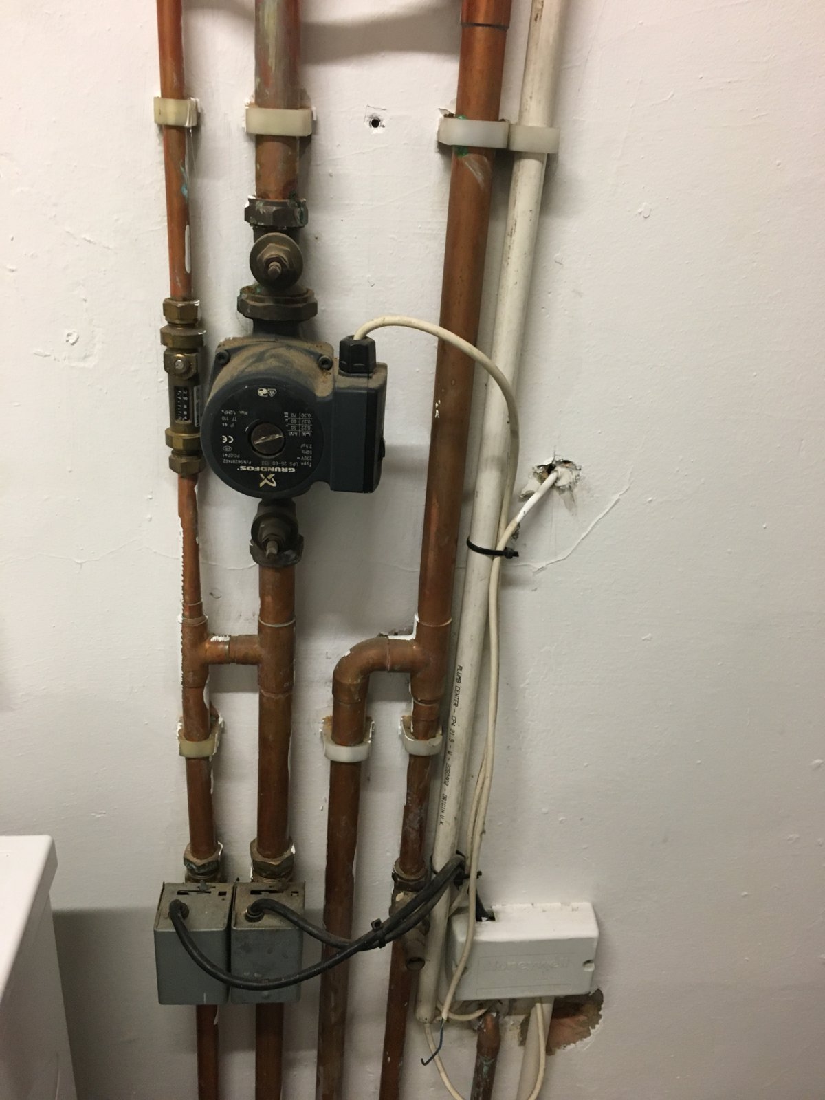

Without re-piping you'll struggle to get 19mm insulation on there...anything less is a waste of time.
The most critical pipework is 15mm on the cold main and expansion vessel...less water volume so more likely to freeze.
Although the boiler probably has internal frost protection it is worthwhile to have a frost stat in the garage in series with a pipe stat on the return pipework.
That way the boiler can circulate heated water around the bypass loop to give a little background heat to the garage.
Given the total lack of thought to insulation I'd question whether the condensate pipework is frost free.
Do not under any circumstances try and insulate the boiler itself.
Loose those gate valves on the flow and return, they contravene safety regs.
