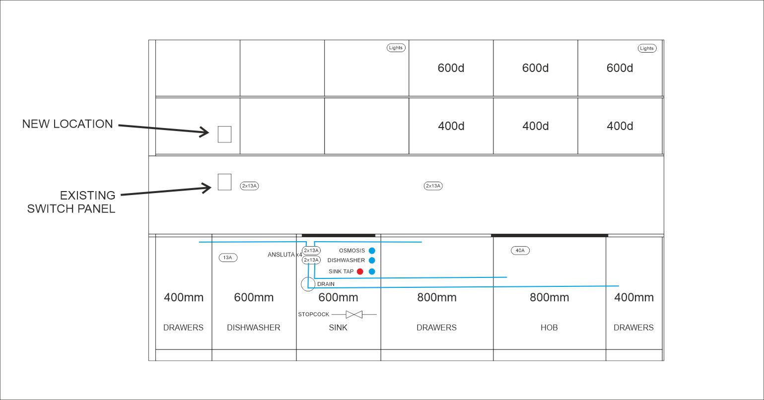

Hi everyone. Thi sis my first post here. Dont be too hard on me please!!!
So, We are renovating our kitchen and the splashbacks are fancy ceramic ones matching the worktop.
To minimise the visual impact, I was wondering if locating the boiler isolator on the grid switch panel with a double pole like this one Varilight boiler Grid Switch will be compliant.
Thanks in advance for your help.
Just the kitchen boiler (in cabinet) for the central heating. The inmersion tank is upstairs with a separate isolator.
Ok, then there is likely to be a fuse as well which you will have to replace and the central heating might be on a different circuit than the other appliances in the grid switch.
Instead of incorporating the CH switch in the grid, why not just move the existing switch to somewhere inconspicuous - in cabinet? - as you could also do with the grid switches.
Those are good points. I planned to move the existing boiler line circuit to the grid for this only switch. I can add a fuse on the grid also.

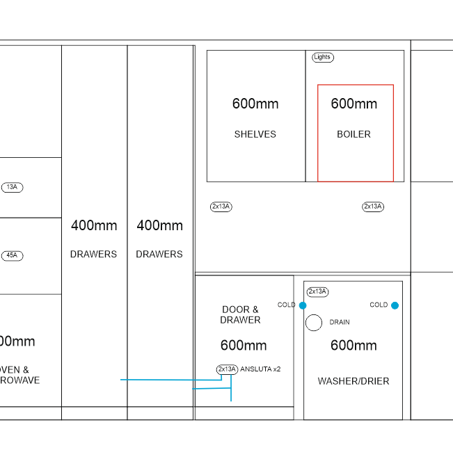

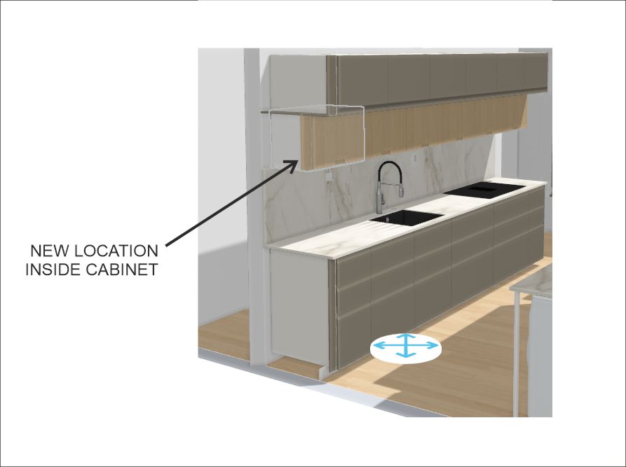

It is allowed to move the grid switch panel inside a cabinet? That would be "easily" doable.
The issue with hiding the boiler switch inside the boiler cabinet is that the space is very limited.
Ok.
Yes, if installed securely.
The switches for appliances are not a requirement, therefore there are no instructions regarding their location - apart from common sense.
There should be an isolation switch for the whole central heating system, though.
In the adjacent cupboard?
The boiler, an attached devices, like the programmer, thermostat, etc, must be protected by a fuse. Usually 3amp.
The switch must be double pole, not a single pole "as used in lighting circuits.
sure. I've never been a fan of grid switches, better off out of sight, IMO
Yes, the grid switches I have selected are double pole.
And I agree with you, I dont see the poitn of them. But at this stage, it is easier to just move the grid panel than to rewire half the kitchen!!!
I'm originally Spanish, and after 13 years in UK, there are still things that I cannot fully get like some building methods and regulations, but we need to live with them, don't we?
If this is allowed by regulations, it will make my life so much easier. Please tell me it is....
Switches can go wherever you want them.
Grid switches or any switches for individual appliances are not required today and never were. The 'grid panel' affairs are mostly foolish choices made by kitchen designers for reasons known only by them.
