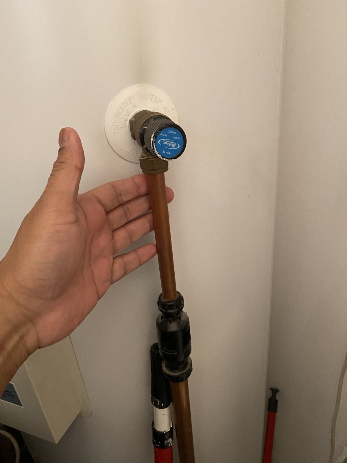

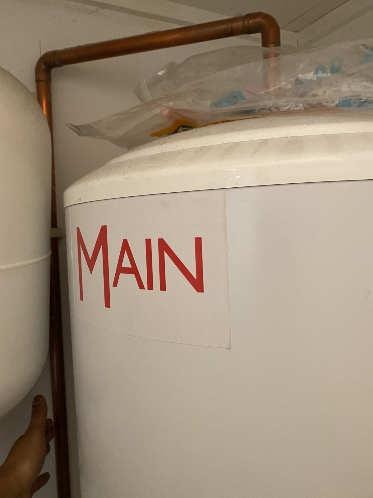

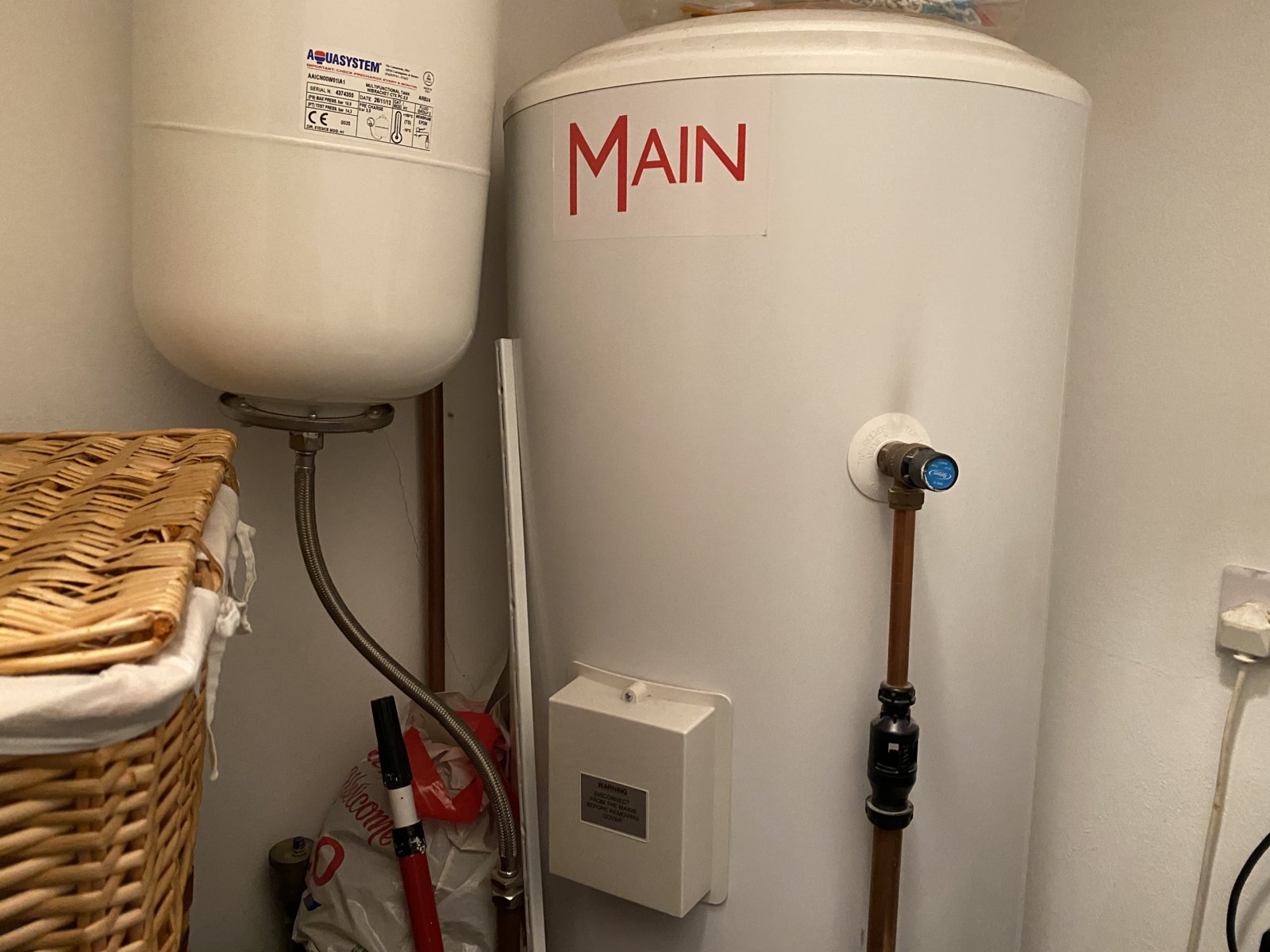

I have one of these big tanks do you know if if it has an immersion facility so I can at least get some hot water.

It should have yes, look for trailing white flexible cable from it to a spur, there might be two of them and turn them on.
they usually do, but I don't know if yours is connected. I'd expect to see a thick, rubbery-feeling flex emerging from one or both of those square covers, and going to a switch on the wall nearby. I'd also expect, in your Consumer Unit, to see one (or two) B16 breakers, labelled "immersion heater"
As you've realised, it is very useful to have electric immersion heaters in a hot water cylinder. Although they are much more expensive to run, they save a lot of inconvenience as you can turn them on when the boiler fails.
edit
yes, the label you've photographed says the cylinder includes immersion heater(s)

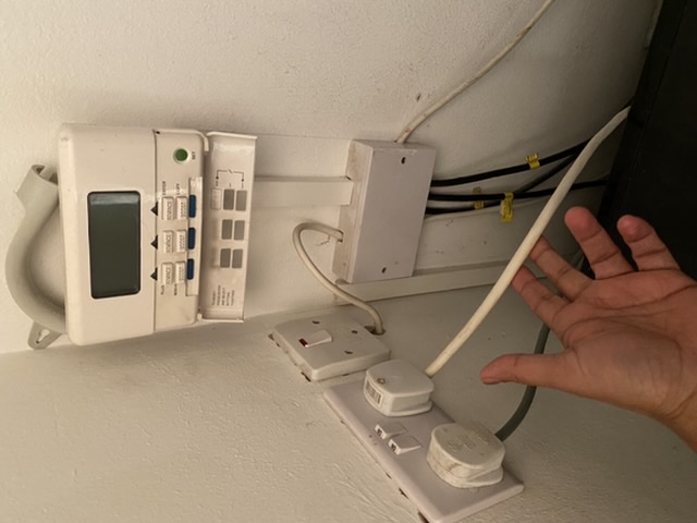

I found the cable it’s plug into the wall. However the other cable goes into a big box of cables which seem to link up to a horseman. Switching the plug on doesn’t seem to do anything. The horseman doesn’t come on as it seems to be powered by the same fused spur connected to the boiler.
When you say doesn't seem to do anything, do you mean the water in the tank is cold, then after leaving it on for a few hours, it's still cold? If not, try doing that.

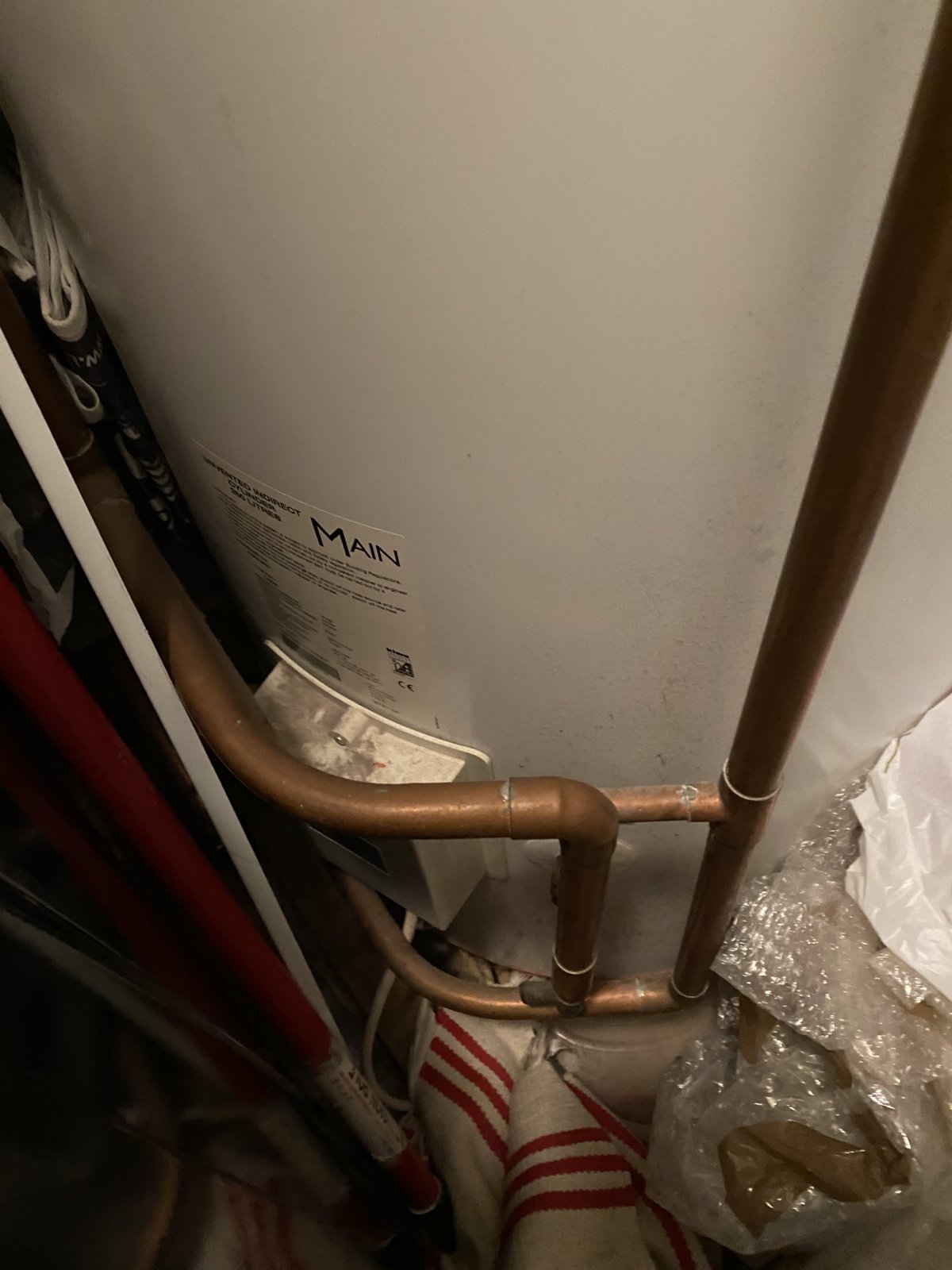

Just checked the the pipes. These two are hot but still no hot water. See pictures for more info
