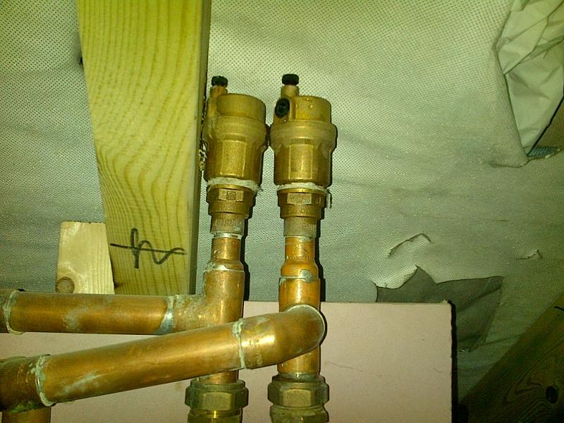

Maybe a coincidence but I replaced a radiator on Monday night and tbh, we didn't notice anything (but it may have been quietly rumbling) but now upon start up, the boiler crashes and bangs.
I've bled the system and no rads have any air.
Pressure is at the recommended 1.5bar.
Upon visual inspection, there are two (I believe) relief valves?
The right one is wet.
It's a Glow.worm 30HXi if that helps?

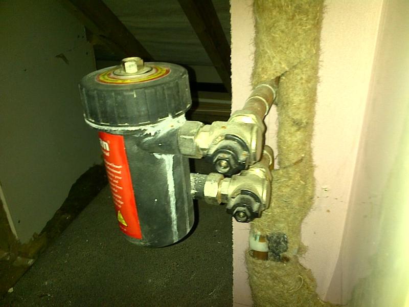

I have got a sludge catcher that was cleaned out about 8 months ago
Any idea what could be causing this banging. It doesn't sound healthy! Once the system is up to temp, it stops then it will go again, presumably on startup when getting the temp back up?
Cheers!
The top two are auto air vents and they may not be working. That Magna Clean looks like an accident waiting to happen.
If the two little black caps on the top of the vents aren't loose, then they won't work.
All I can say is ensure all air is vented from system and make sure you do something about the cleaner.
It certainly sounds like a circulation problem, but only a site visit will determine the exact cause.
Thanks Pete. No air in any rads when bleeding and both the vents have loose caps.
Is there another way to vent the system?
There's a bleed screw on the Magna. Other than what you've done, there's no other way to vent a sealed system other than that. Best advice is to get the system checked over.
Cheers Pete,
Bled and re-bled and there has been no banging so it looks like it was an airlock :) Yay!
I'll get the MagnaClean cleared out over the weekend :( Boo!
