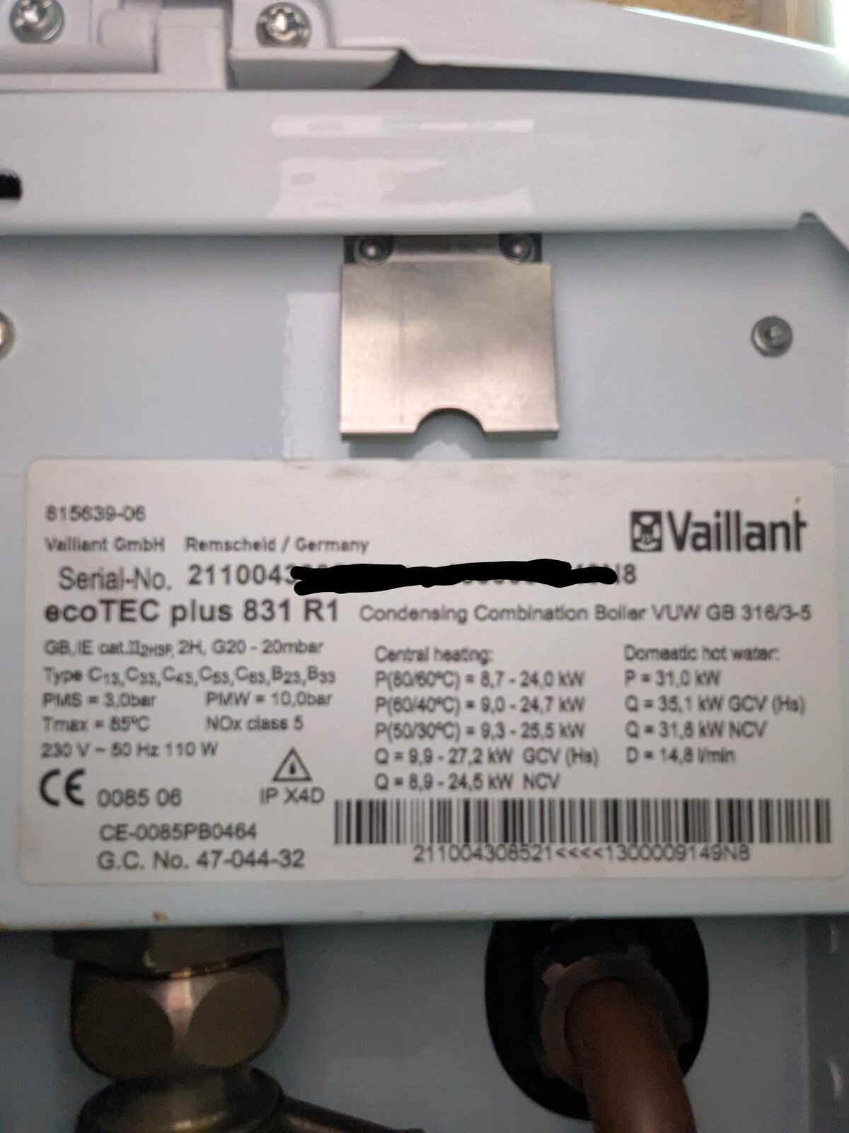

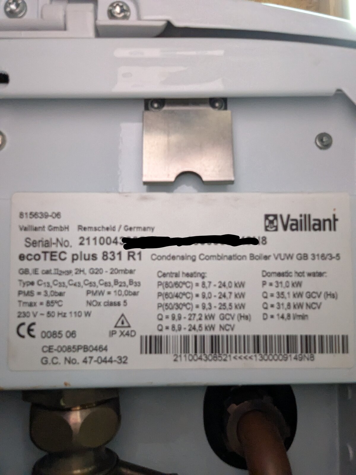

The main heat exchanger is leaking which is why looking to replace it's also manufacture date of 2010 so of an age. Assuming I've read the sticker correctly! Does this confirm it's also a 25.5kw version?
Yes, seems to have 25kW output to central heating (rads etc) but it ouputs 31kW to DHW, if you specify a 26kWcombi boiler then it might only output ~ 20kW to Central heating, check with the manufacturer.
Yes correct for the age. Definitely consider a new boiler as last time I price checked a main heat exchanger for that range was £699 and that’s just the part.
That's exactly it if it's 699 plus labour no brainer to replace and get a long warranty on a new one etc
