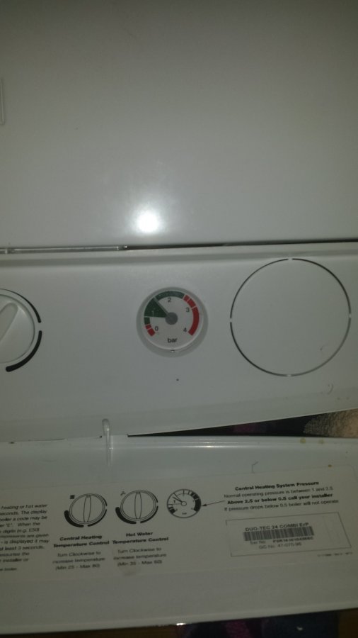

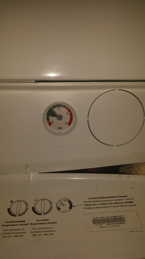

Hi,
Since our third rail appeared to be taking longer to warm up I bled this morning.
Prior to bleeding the pressure was unchanged from 19 days ago at 1.5 bar. After bleeding it had dropped. In not able to read our gauge easily but it's around 0.1 or 0.2 bar. I have attached a before and after picture.
I captured the air in a plastic bag which I didn't light but the air didn't seem to rise like I would have expected hydrogen to. I thought this seemed like a safer test than setting fire to myself early in the morning.
Does this give you any idea of the size of our leak and what we would be able to do about it?

If all your pipework is in the ceiling and the downstairs is on drops, then you would likely have noticed a leak by now. But, if you keep getting air out of the system (after several months) then a small leak would seem to be present! Make a mark on your gauge at the pressurised point and monitor it! Your gauge may be faulty also! If the gauge isn't dropping then the system is contained be it air/water/both!
If you want, try introducing a bottle of leak sealer and see what happens after that!
If your boiler pressure was holding for 19 days its unlikely you have a leak. When you let air out the pressure will drop (even if you don't bleed water out). When your heatings on the pressure will rise then go back to normal when it cools.
When bleeding hold a cigarette lighter under the vent and see if it lights if you want to see if it is hydrogen.
Go and find a good book and let your heating look after itself!
