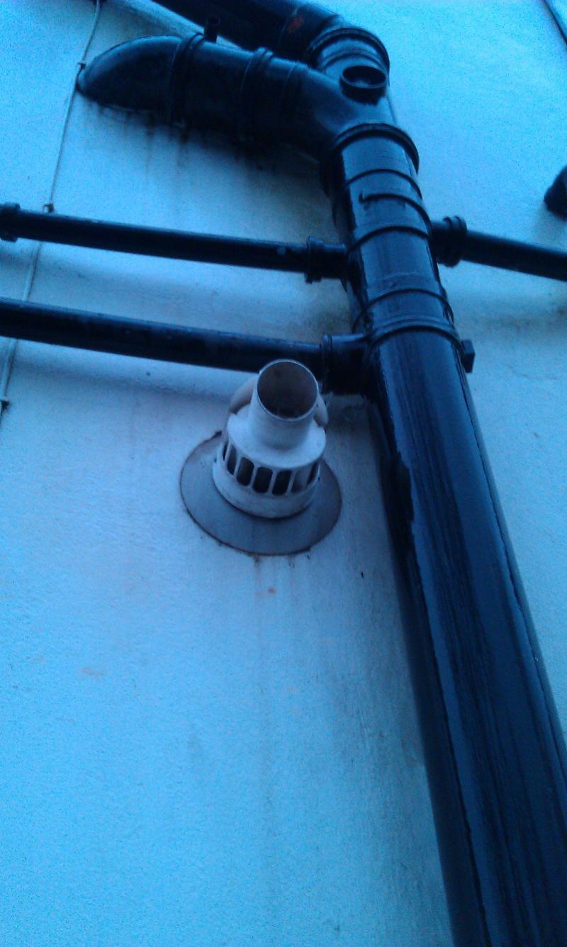

Hi all! Just wondering if anyone can give any advice?
My boiler is leaking all over my kitchen everytime it rains heavily! Think the flue is taking in the rain!
The vents on the outside are sucking in air (and rain, I think) and the big outlet in the middle is blowing air out (see photo)
Could it be water running off the guttering above the flue and if so, is there such thing as a rain deflector that I could instal above it? Need to sort it myself really as can't afford to pay a plumber hundreds of quid to just come out and look at it!
Cheers!

Get outside when its pi**ing down and have a look yourself as to how the rain gets in before a remedy can be suggested. No charge for that advice.
The chances are that either the seals around the flue have failed or boiler flue pipe is sloping inwards to your property, the pipe should slope slightly outwards to prevent the ingress of rain. It is not a good situation and could compromise the safety of your boiler.
Flues for boilers need to be installed by qualified engineers, unfortunately you are going to need to put your hand in your pocket.

I agree have a look from out side.. its probably a blocked gutter....or hopper...

A client thought he had the same problem. Turns out there was a blockage in the downpipe that the condensing pipe was plumbed into.
I went to one like that!
The boiler was shutting down because the trap was over filling and activating the protective circuit.
