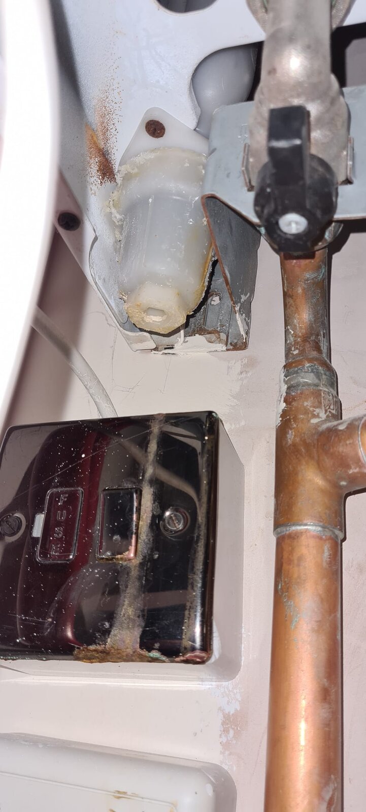

I would really appreciate your help if someone can. I have Main Elite ECO 30 Combi boiler. It looses pressure everyday and every morning I have to top up the system a little bit in order to clear low pressure alarm E119.
I noticed a small leak on the left corner on a plastic thing at the back, not sure what it is but looks like you can tight it a little bit. You can see it in the picture and water marks on the switch below.
Can anybody suggest what it is and how to stop this leak please ?
Thanks a lot in advance
Sunny

It's the condensate trap ,you should get a gas engineer to investigate and repair.
Looking at the chrome plated FCU and the corrosion on it , it would appear to have been leaking onto it for some time. Probably got more than one issue.
Thanks "terryplumb". Spoke to an engineer and he cant come and see before Monday so kind of want to see if i can do it myself. Does it not come off from the bottom if I unscrew it ?
Thanks Ianmcd and terryplumb, I don't see any leakage anywhere else, Just want to know if this trap can be removed if I unscrew it ? it is a small leak but enough to raise the E119 alarm and yes i think its been happening since last few months since i extended my property and moved this boiler.
You shouldn’t be removing the condensate trap as it forms part of the flue.
Check on top of boiler,can’t remember if there’s a aav there.

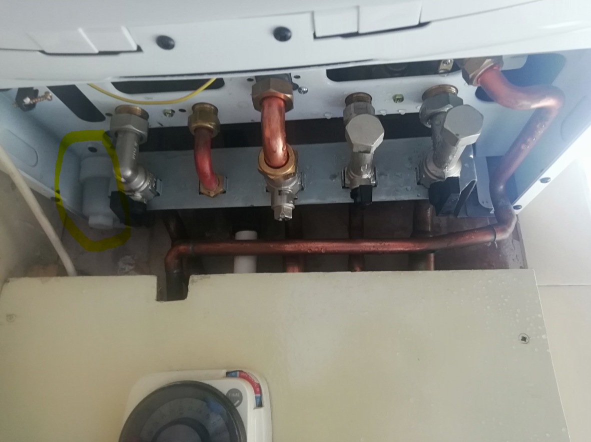

Put your pressure up. Then Turn the boiler isolating valves off outer right and left ones leave for a day using hot water as normal and see if pressure drops if it does the leak is on the boiler.
Second pic those pipes are covered in water drips what had you attempted before taking pic
