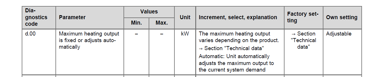

you can look at d.40&d.41 flow/return temperatures and all sorts of useful info if you know how to access the d parameters, post a phot of the boiler front/controls and someone will show how to access them.

thanks for that, yeah i did see d.40 etc and it only showed flow, return temperatures but did not see any kw adjust setting... seen them before on previous valliants..

I have attached a copy of a Vaillant Sustain below, if you look from page 46 onwards you will see all the d parameters, starting at d.00, maximumm heating output which defaults to Auto (full output) but can be set to any level you wish. If you scroll down (on the boiler menu), you should see d.40&d.41.
