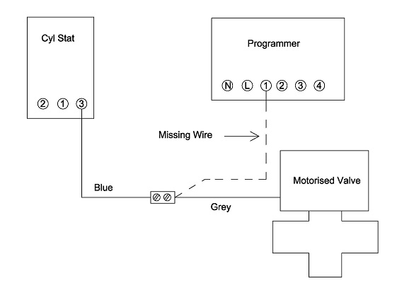

Boiler not switching on, pump not running, no hot water - please help?
Grey wire from 3 port goes to blue wire from cyl stat - no other wires exit from this part of the connector block, so the mysterious wire that 'should' go the terminal 1 isn't there.

We have established that jumping L with T3 and T4 at the backing plate switches everything on and that by manipulating the room and cyl stat, the two channels switch on and off as expected.
Does this not tell us that fundamentally the basic components other than the timer are functional and given a hard wired (at the timer) 'all on' command, are working correctly.
Yes it does. It also means that the wires that are there do go to the right places.
I have a theory for you. I can't be sure, but it fits what is there, so here's what I suspect. Are you sitting comfortably? (showing my age now)..... Once upon a time, a system was installed with two, 2-port motorised valves. This type of installation doesn't require a connection to the programmer's terminal 1, so it wasn't installed. Later it was converted to have a 3-port valve. (often done at the time of a boiler replacement) Because the cylinder thermostat now needed an extra connection to the motorised valves grey wire, a slightly unusual T&E grey cable mentioned by @Harry Bloomfield, that was conveniently to hand was installed at the time. As it was far too much trouble to run an additional wire back to the programmer it wasn't done, and someone failed to set the programmer to its restricted settings (Gravity hot water / Pumped Central heating) which would have allowed the hot water to come on automatically when the heating was selected, thus allowing the motorised valve to get its live on the grey wire via the new wire from the cylinder thermostat..........After sometime, the systems present owner was informed about the missing wire and arranged to have it added, and they all lived happily ever after....The End

Ah!! I failed to notice this before. Suddenly all is clear.
the original timer I replaced in 2003/4 with the now failing Tempus Six was not two channel.
The problem with the missing wire is all your fault! You are the one who replaced a single channel programmer with a dual channel programmer and didn't add the wire to terminal 1 at the same time!!!!!
So, you've spoiled my story now, although I guess the part about not having the wire originally because it wasn't required is right. At least you can still have the happy ending.

All I remember about the original timer was that when I fitted the replacement, I was pleased that I now had the functionality to have CH only.... except it never worked, so on reflection I am assuming it was only 1 channel.
1) Faulty timer on order and in the post.
2) Adding missing wire could be tricky as the timer and airing cupboard are almost at opposite corners of the house and getting a wire fitted behind the new kitchen units, kitchen tiles, plaster work, dot n dab and chipboard flooring trapped beneath the upstairs stud walls would be a nightmare. I really need to understand what the two joined up twin and earth cables are for at the rear of the back plate. I guess it would be too much to hope one of the cores was redundant and terminated in the airing cupboard. That would be too simple.
My theory of the 2-port valves being changed for a 3-port was an attempt to come up with an explanation out why the wire from terminal 1 was missing, but you can discount that now. The reason it's missing is because you failed to make the swap from a single channel programmer to a dual channel programmer properly.

At the time, I was a home owner with a broken timer, who went to B&Q and asked for a suitable replacement. I bought the one suggested, attracted by the 'same back plate, fit in seconds' sales pitch and fitted it. I knew nothing of central heating systems at the time and all was well, beyond me noticing that I couldn't have CH only without HW command. I don't recall having that option previously, hence me believing on reflection I was single channel originally.
Only now trying to trace the fault 15 years later have I discovered that I'm missing a wire to enable full 2 channel control of what still appears to be a Y plan?
On further reflection and as confirmed by my bro-in-law who was round again last night, I don't have direct mains to the airing cupboard (unless I wire into the immersion feed) and unlikely have a free wire in place from the back plate to enable HW off command, therefore without tearing half the house apart to fit a wire behind, chipboard floor, tiled bathroom floor, tiled kitchen wall and new kitchen cupboards (where the timer is), this functionality is to remain unavailable. Not that CH only is a particularly essential feature.
In other news, the new timer arrived, is fitted and the system now works as it once did, albeit without CH only.
