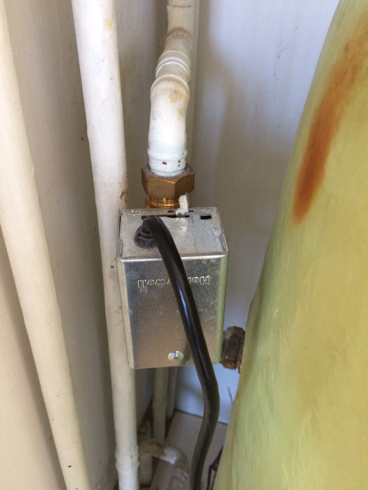

I believe I have an open system, with a hot water tank in airing cupboard and the header tank and cold water storage tank in the loft. The boiler is a Main 24 HE (Baxi potterton). I am not sure if its Y or S plan. I can find a motorised valve for the HW connected to the HW tank but cannot find a valve for the CH (could be hidden somewhere). One other thing I have noticed is there is a lot of air accumulating in an upstairs Rad (even though I continue bleeding it everyday - after the system is cooling day). The trickling sound from the rad downstairs near the boiler is quite prominent. Hope this helps and any advice appreciated.
I think you are mistaken, if you have a Main system HE it should not be open vent, they are only designed for sealed systems, post some pics of your boiler and HW cylinder set up and the valve you speak of so I can see what you have

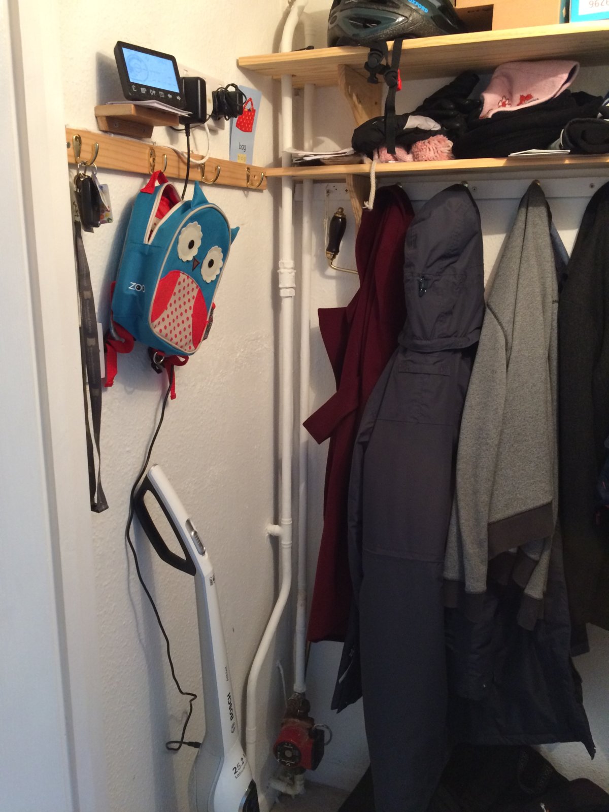

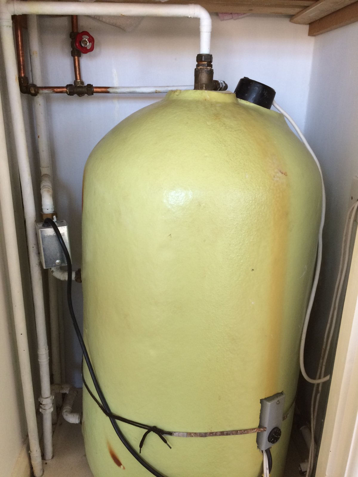

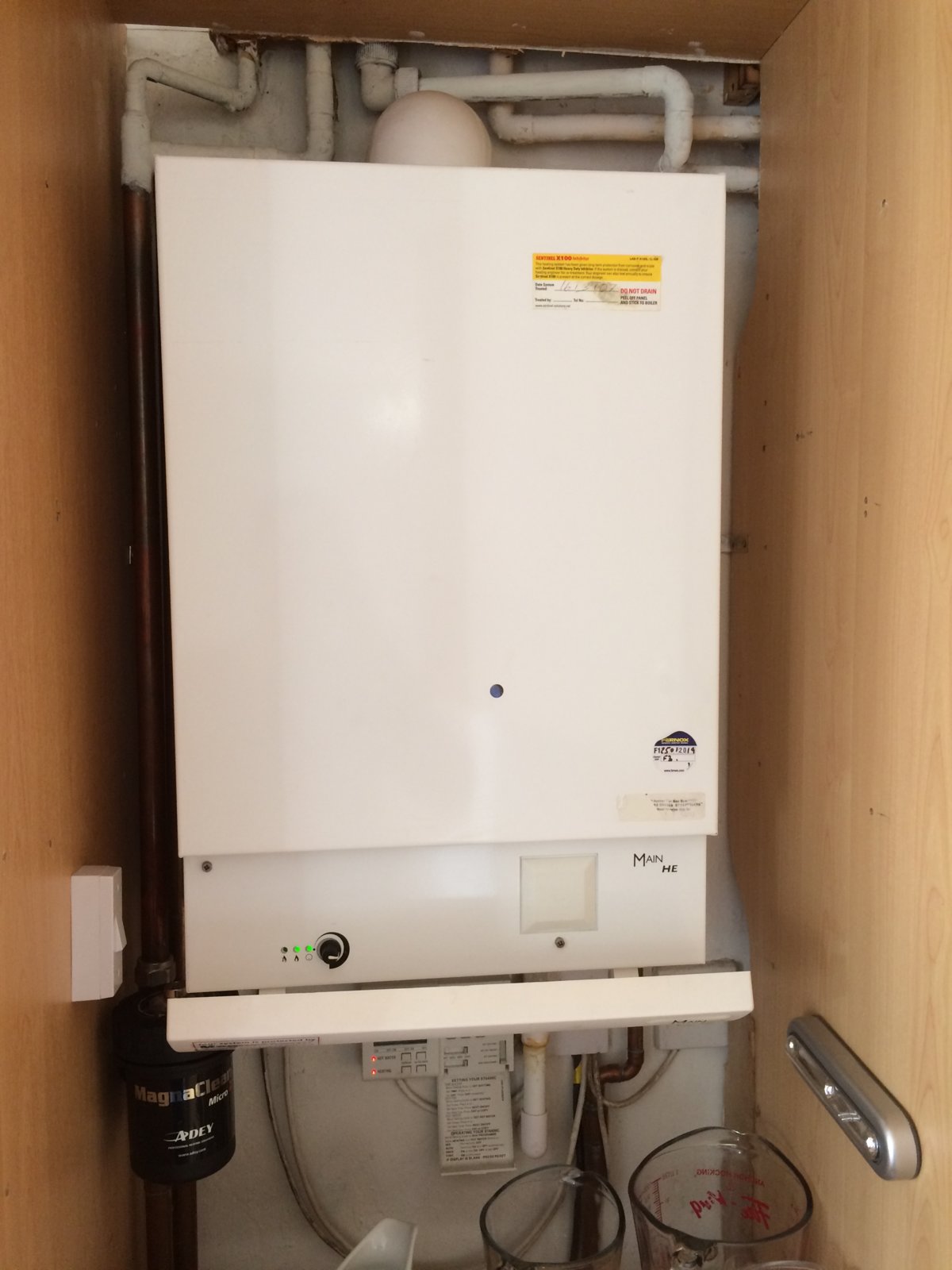

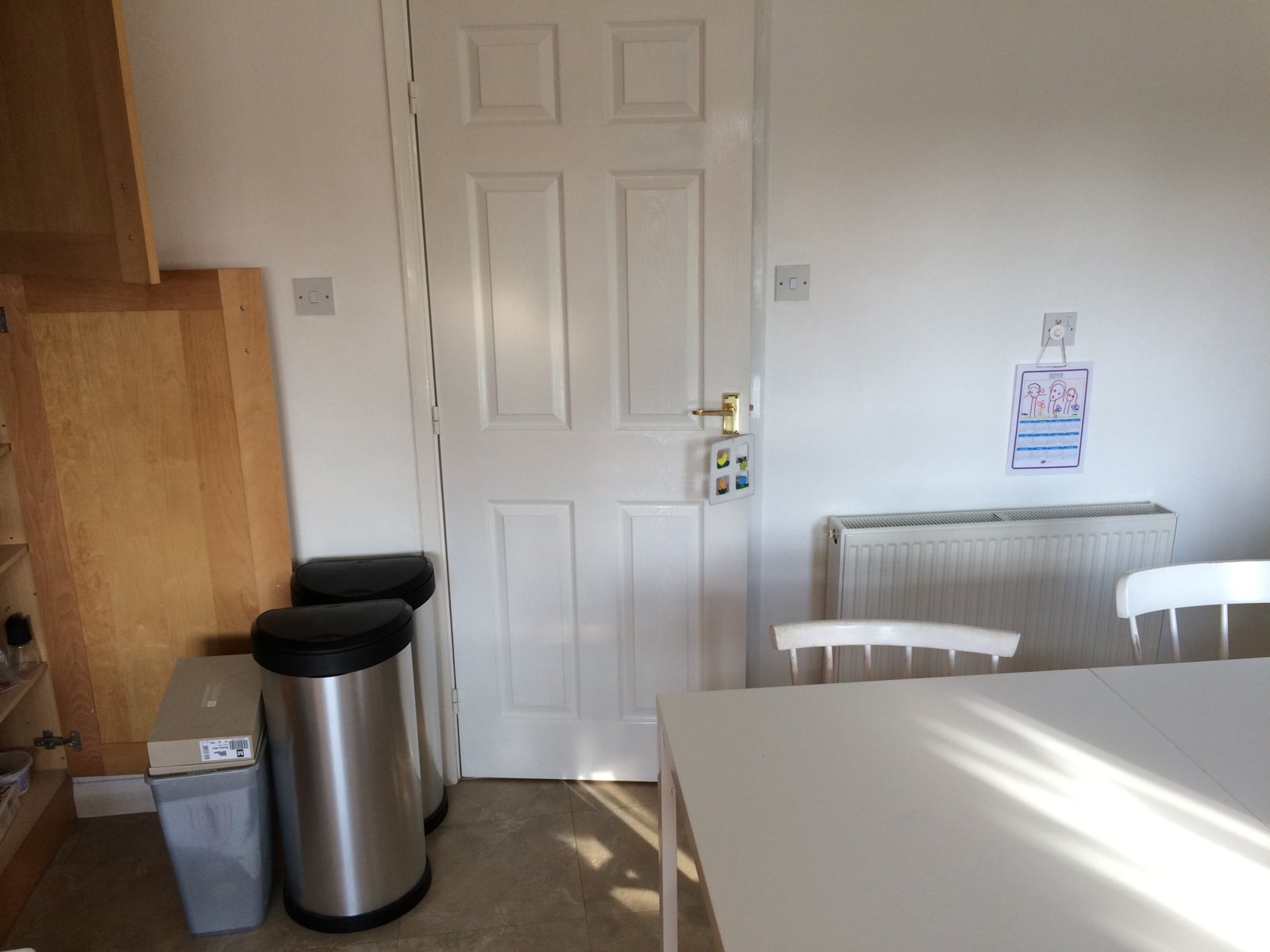

Here are some pics of the system (minus the loft set up).
Setup:
Boiler - Kitchen
HW cylinder: Upstairs airing cupboard (inc motorised valve)
H20 Pump: Cloakroom (next to kitchen)
Radiator making trickling noise - Kitchen (closest to boiler)
Also the boiler has been turning itself off with the overheating error symbols indicated.
Just trying to figure what it could be (h20 flow, airlock , leak).

Your boiler is a Main Heat only High Efficiency condensing boiler and is suitable for the open vented system that you have, the trickling noise that you describe on the rad closest to the radiator is likely to be a lockshield issue usually can just be sorted by adjusting it, the boiler on off cycling really needs a professional to have a look, can be a few things but none of which are DIY

Could it be that your Magnaclean is blocked with debris?
