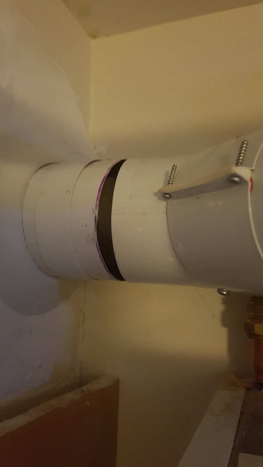

Boiler outer flue not sealed
29 Dec 2018
Hi, decorating the kitchen and noticed the outer flue of the boiler appears to have a gap.
Is this normal?
Thanks in advance

NO that needs to go off immediately, the inner flue will need inspected and if ok then the sealing collar that has been slid along the flue towards the wall needs to be fitted properly but only after the inner flue has been properly inspected
