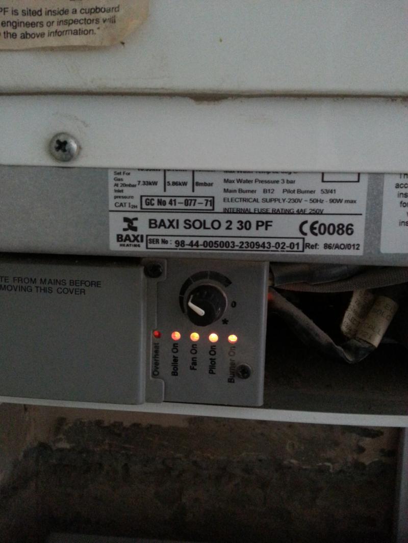

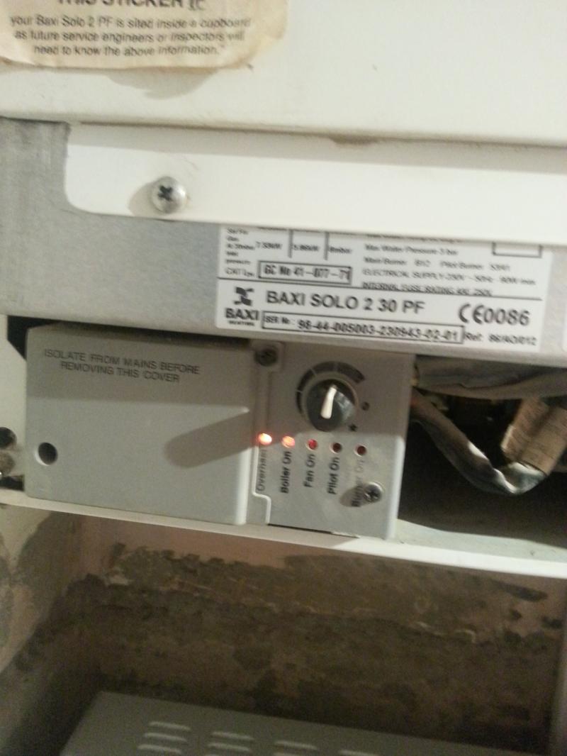

Here's a pic showing the highest setting I can have my boiler on without having any overheat issues
After turning up the knob I get the overheat light - approx 5 minutes later
Is this normal?
Thanks again
Robbie
Sounds like there may be insufficient circulation in the system. If there's no by-pass, there should be at least one radiator without a TRV on. If you can, unscrew one of the TRV heads so that the radiator is on maximum. Then turn the boiler up and see if it trips then.
It is not normal, but that is not the point.
The maximum you should be setting the flow temp to is 82 C.
An ideal boiler design will not allow the temp to be turned up above the temperature at which the over heat stat trips.
But your boiler is old and if not very fully maintained the settings and calibration of components will drift and this kind of problem can occur. But properly set will not cause any problems if you don't turn it up to maximum. ( Why do tenants always expect to turn everything up to maximum? )
Your system should either have a bypass or one rad should not have any TRV. I suppose you have all TRVs set at maximum too. But if you don't have a bypass then you should really remove one TRV head and that should be the one in the room with the room thermostat.
You do have a room stat don't you?
